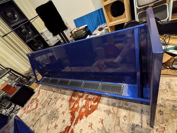

The line array baffles have returned from rework and ready for new holes to be drilled for the new planars.
Then test everything before doing paint touch-up on the prototype baffles.

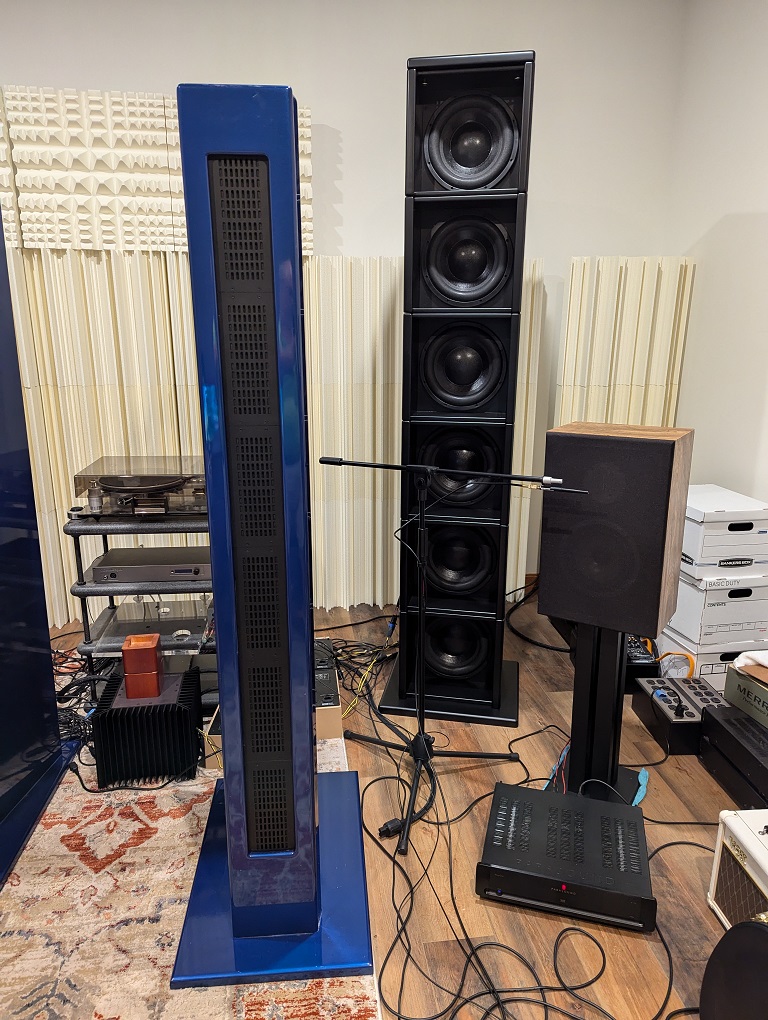

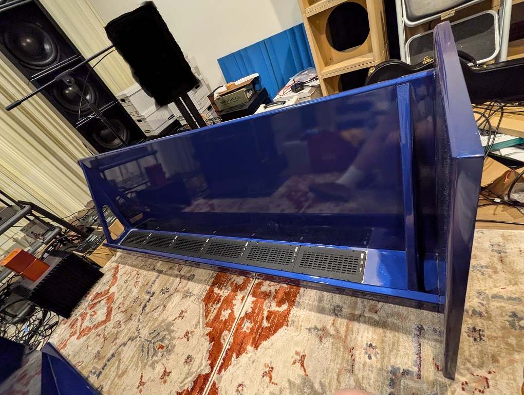

With a friends help got the AGN II Line Array baffles into my listening room.
Now time to drill the pilot holes to mount the LM10n planars. Then on to wiring the planars up to the amps.

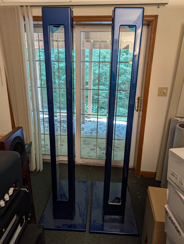

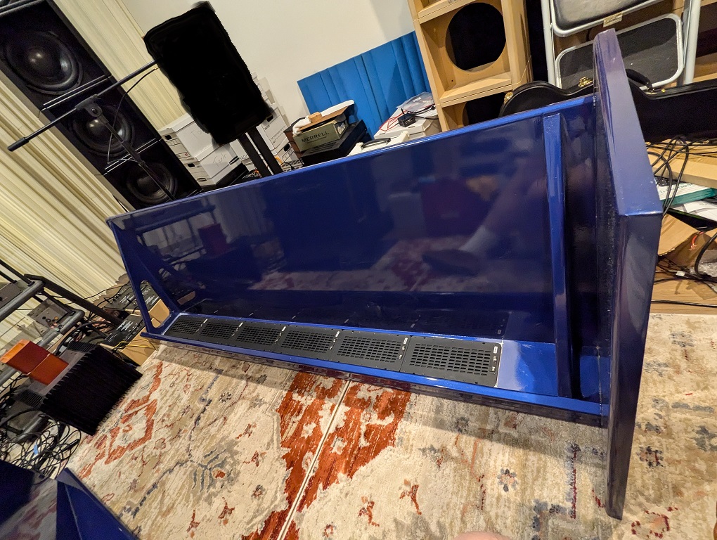

The planars fit perfectly in the reworked slot.
Now time for some pilot hole drilling.

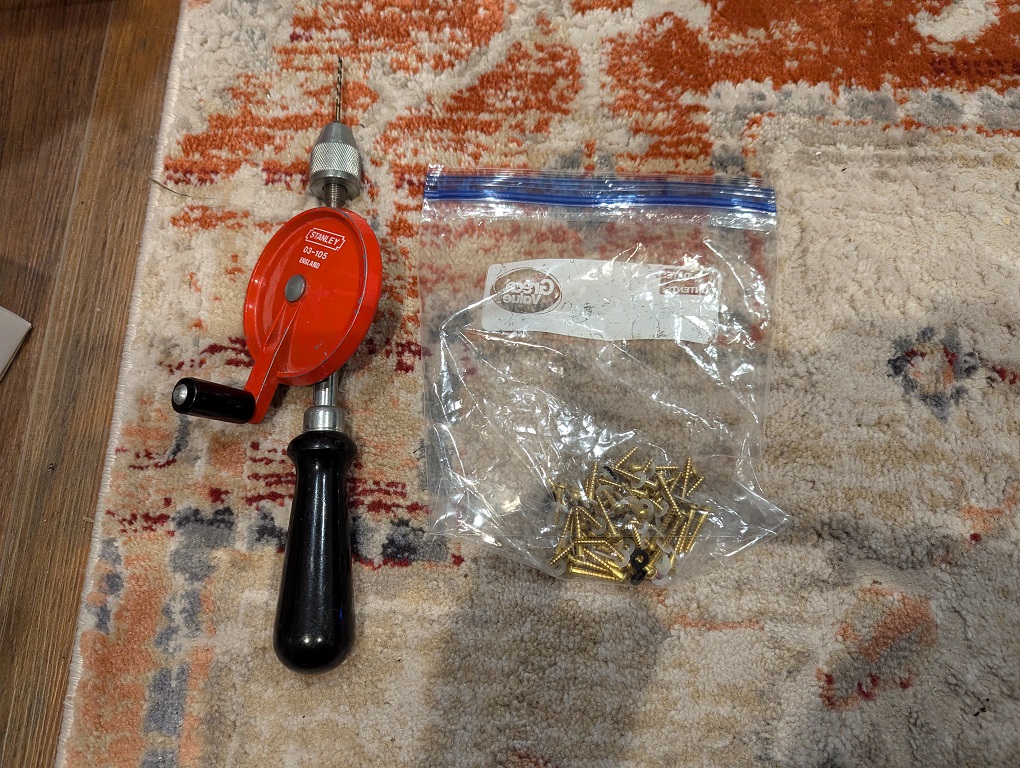

Posts: 928
Now time to drill 24 pilot holes for the planar mounting screws. I use brass since the magnet structures in the planars have high field strength.
Also rebuilt 6 cables to connect the planars to the amps. Will do 6 more soon.

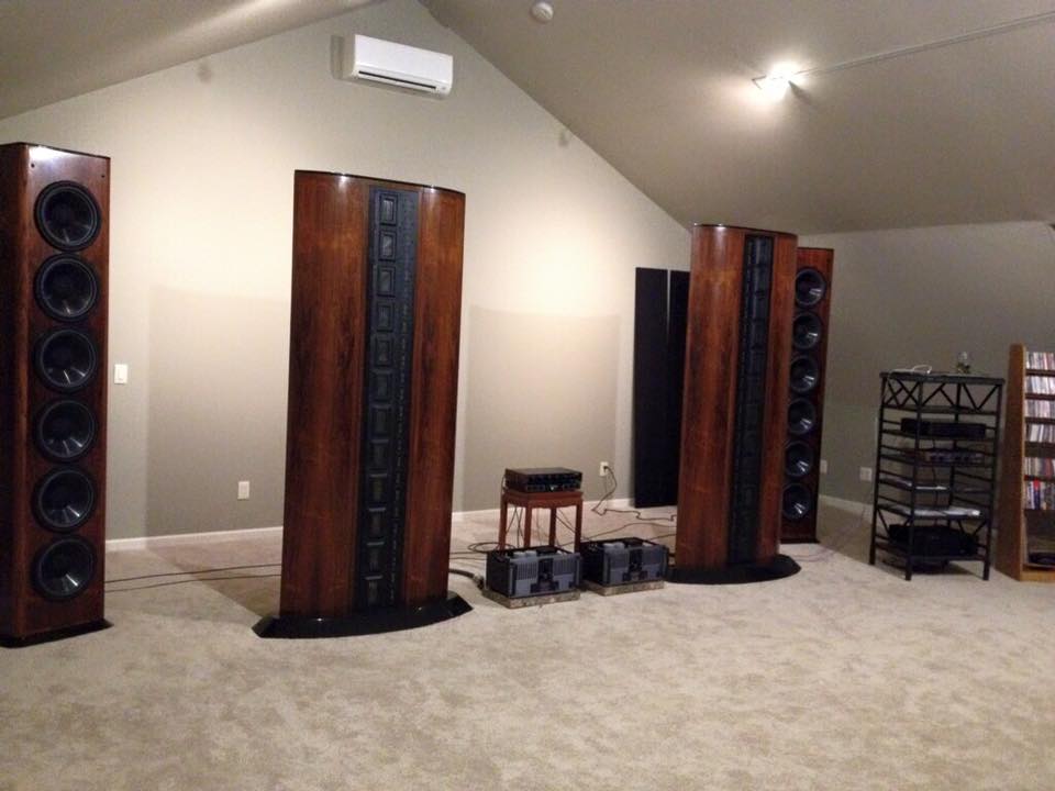

Talk about coincidences, the pair of heavily modified IRS Reference V's I posted the picture of at PS Audio are now for sale. They want $70K for the pair.
I think I am good with the AGN II's, my room is not big enough. :o

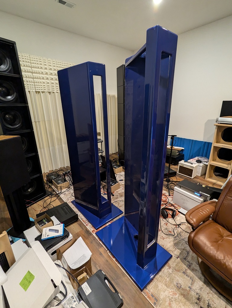

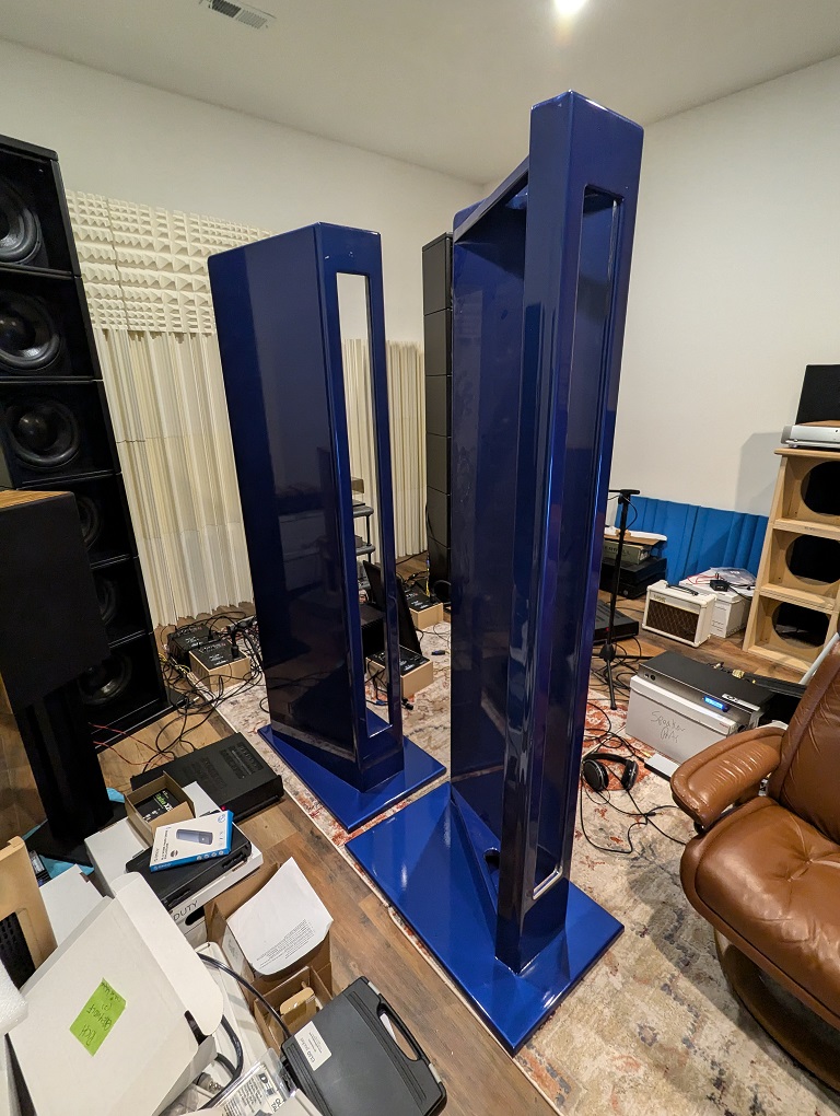

The right AGN II Line Array has the LM10n planars installed.
Next is install the left channel planars. Then connect the wiring for the monoblock amps.
