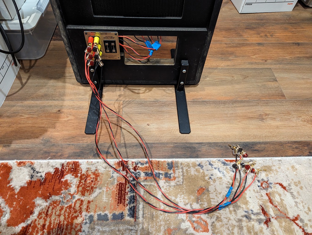

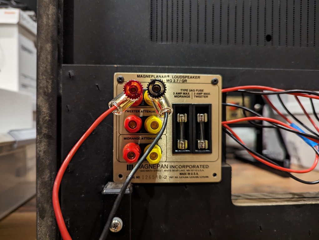

Have the first 1.7 rewired for testing with the locking banana connectors.

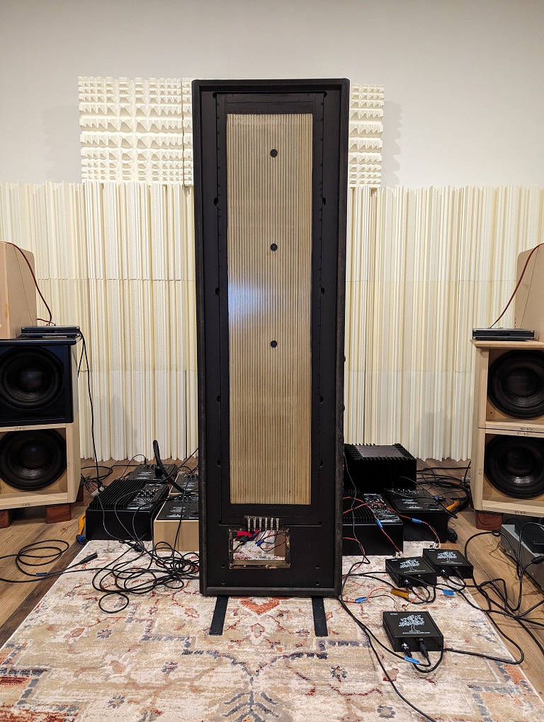

The Magnepan 1.7 with the dspNexus 2x8 DSP crossover is now running. This is the one speaker with all three planars working for measurements.
From the passive crossover design and first measurements, the DSP crossover is working. Now to make individual driver measurements to fine tune the crossover. The DSP crossover is nothing like the original passive crossover in design.
The three Orchard Audio Starkrimson Monoblocks with the 300W GaN SMPS are triamping the planars with the 2x12 in servo sub on the left. The amps were in my room when the ground water problem happened. I bought the new SMPS as the originals were water logged and most of them died.
The super tweeter driver is padded with a series resistor since its resistance is 1.4 Ohms. This makes it an easier load to drive for any amp.
