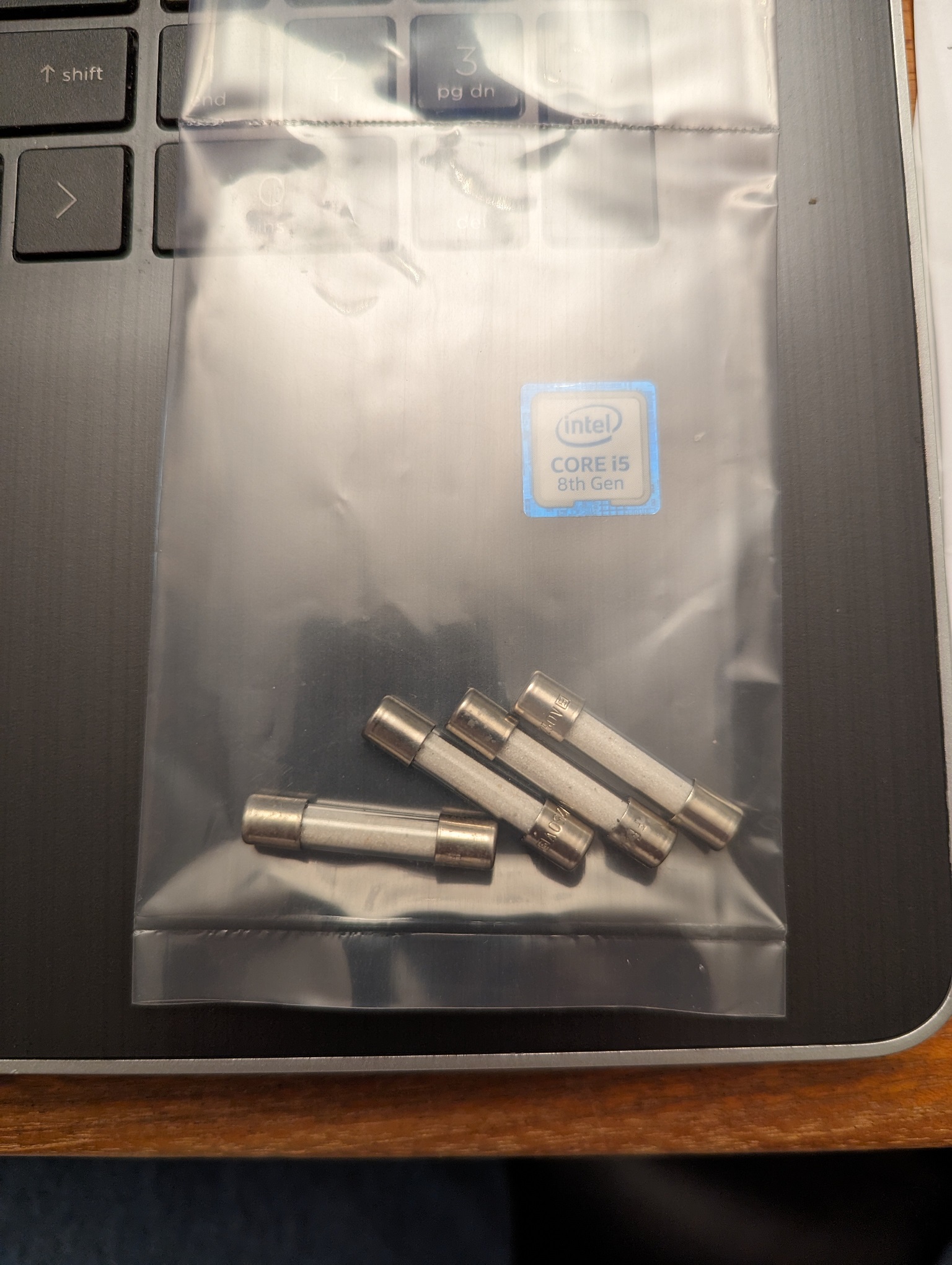

The fuses are here to put in the MG10/QR's.
Now I just need a room to set them up.
New drywall is installed and hopefully painted Friday. Then new floor goes in Monday. Then time to start the next step of Audio Room V2.0

Roscoe? No! :thumbdown: The "tweeter Voice Coils" are very small gauge and for the speakers to operate reliably the current through them should no exceed 3.2-amps (80% of 4-amp fuses). That's 40 watts.
You increase the volume level 3-db and you are demanding 80-watts. OUCH! During my evil past I had a pair of Manepans with the copper "voice Coils." I thought I was doing the audiophile thing by installing jumpers to replace the fuses.
The speakers did sound better without the fuses -- no question. Then POOF!! The voice coil in one speaker became the fuse. Lesson learned. The sand-filled fuses are a nice find and they do make a difference.
PostPosted: August 2nd, 2023, 5:10 pm
The main reason for the sand filled fuses is to have higher interrupting capacity on very low impedance circuits. For example a 3 amp ABC fuse has a current interrupting capability of 10,000 amps. No audio amplifier can ever come close to that. Otherwise there is no difference.
