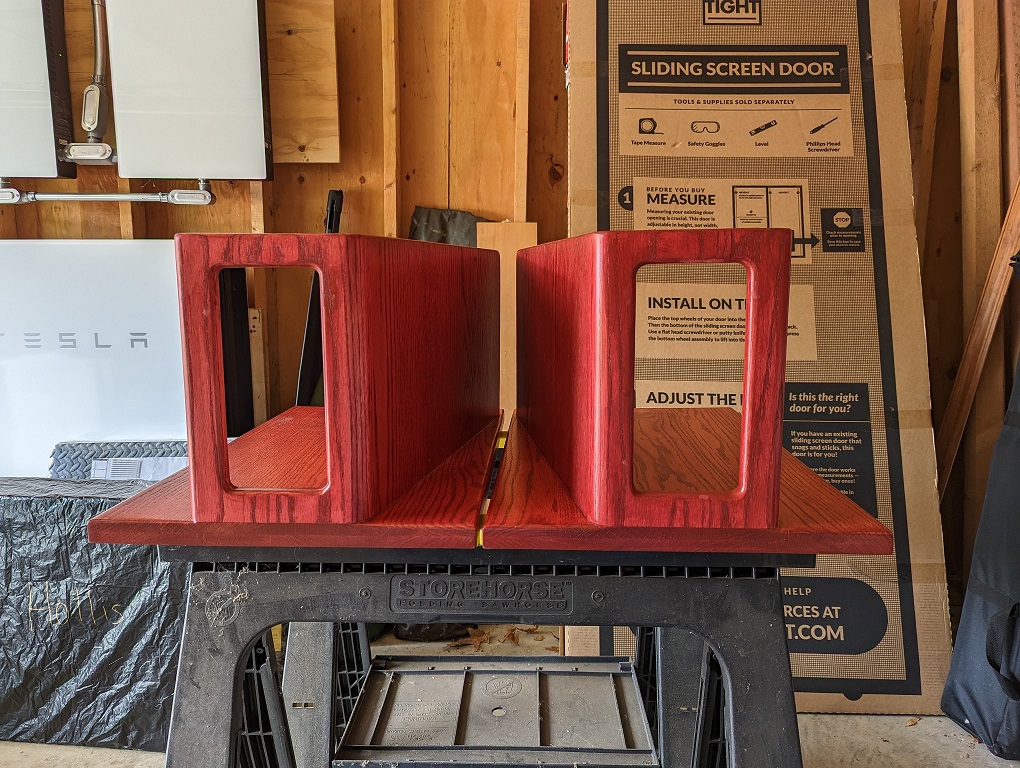

Have the baffles for the LM10n planars ready for installation.

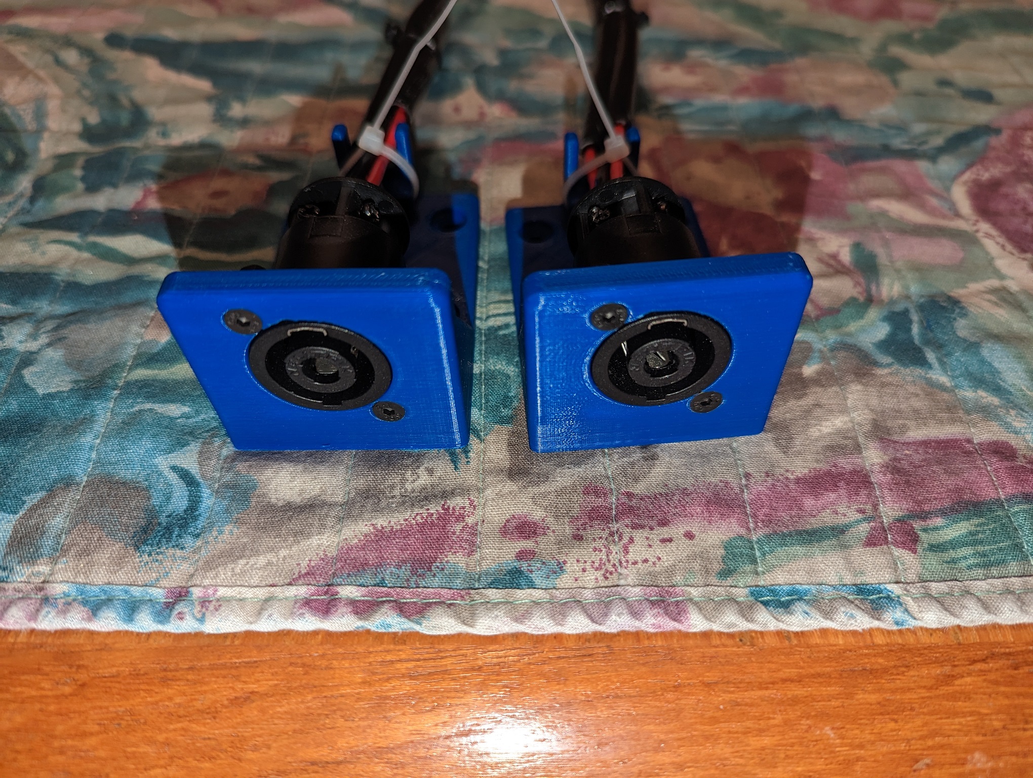

The Neutrik Speakon wiring for the last pair of 12in servo subs is ready to install in the sub modules for testing and listening.

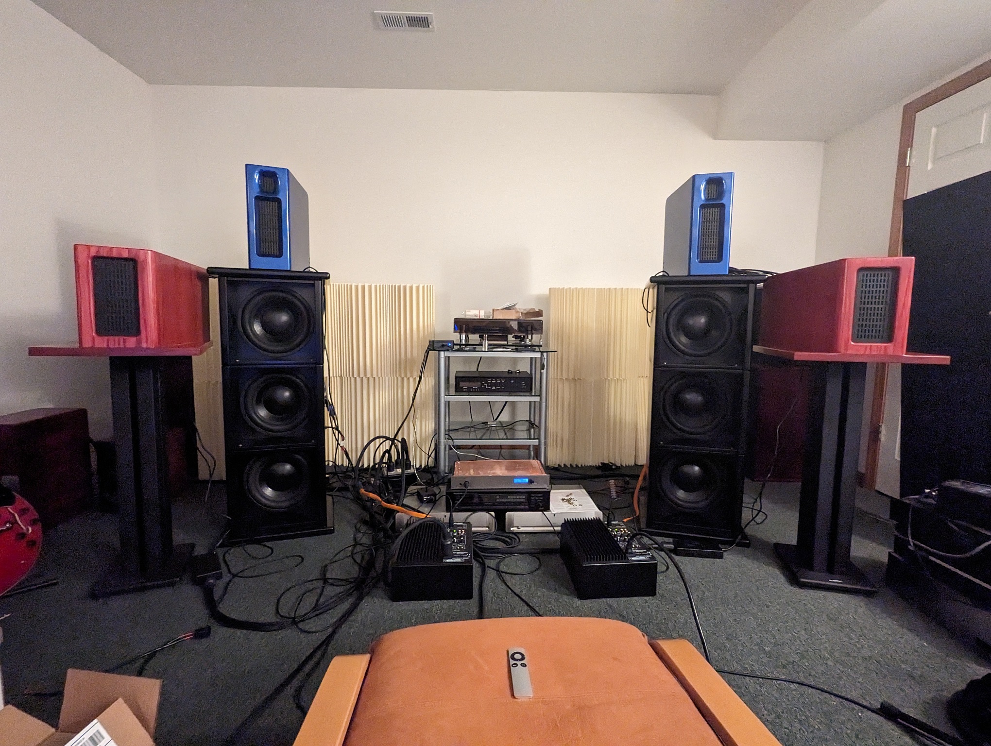

The Magnetar II open baffles with the Radian LM10n planar driver are done.
Using the Danville Signal EA dspNexus 2x8 DSP processor for the crossover and sounds great!
This is setup in my smaller space downstairs as the listening room is completely gutted after the water leakage. It has been mitigated and corrections that should solve the problem are complete. Have to wait until another big rain for a test.
Next step with be Audio Room v2.0. That is going to take awhile.

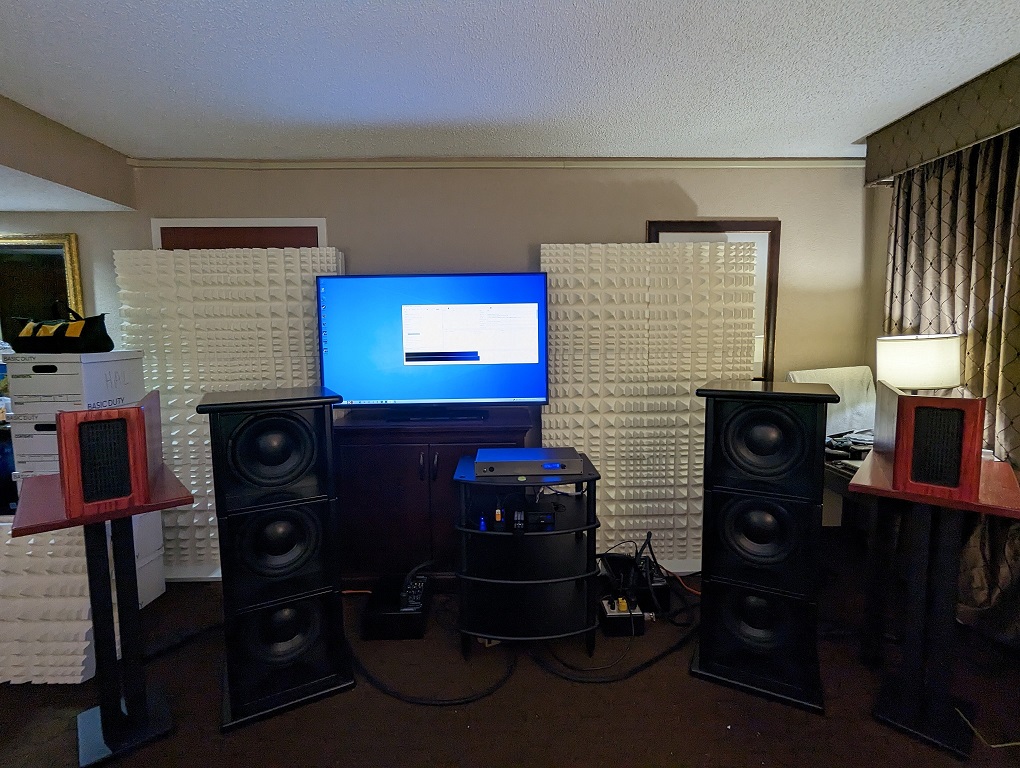

At Lone Star Audio Fest (LSAF2023) in Dallas TX. In room 204 at the show hotel with the Magnetar II speaker system to demo for some DIY friends in the area.
Time for some music listening!

Having a great time at Lone Star Audio Fest with the Magnetar II's. The system sounds really good as a nearfield setup. The rooms are small and square! :o

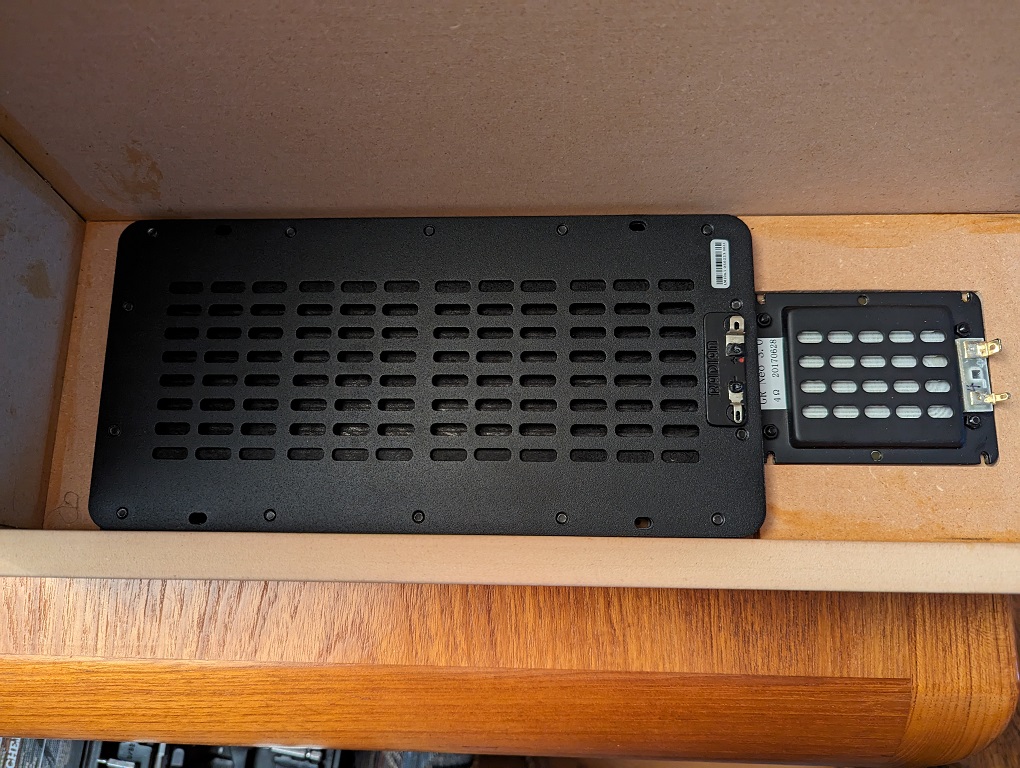

Wanted to see if the new LM10n is physically the same size as the now unobtanium BG NEO10 planar. And it is! Drops in if you reorient the leads on the GR NEO3 tweeter 180 degrees.
Should sound even better than the BG NEO10 in the :) same speaker. Just a bit of offset between the LM10n and NEO3 drivers diaphrams, that is easy to correct with delay.
