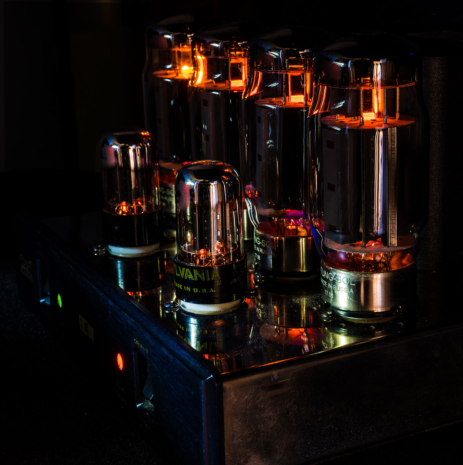

Will this sell?
Just a quicky beauty shot, needs more work but a decent start
You can see how much brighter the Red B+ PS LED is than the Green filament PS LED is

 Post subject: Re: need help
PostPosted: April 11th, 2022, 9:54 pm
Posts: 236
Beautiful photo, Paul. Incidentally, with high-value resistors in series with the LED, the only way I can see it failing is if, under some strange start-up or power down condition there is reverse voltage on the LED it could fail. To protect put an anti-parallel diode across the LED.
