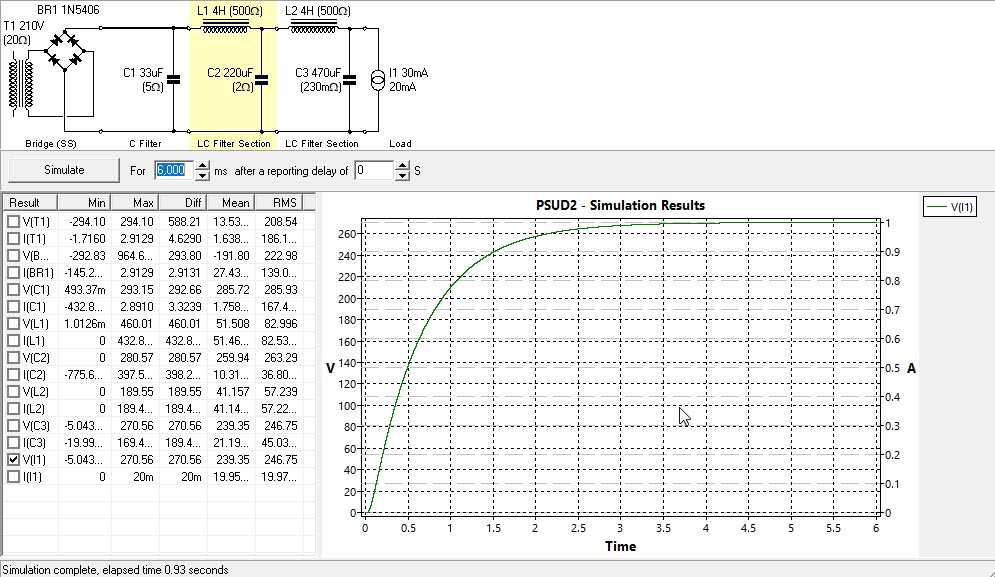

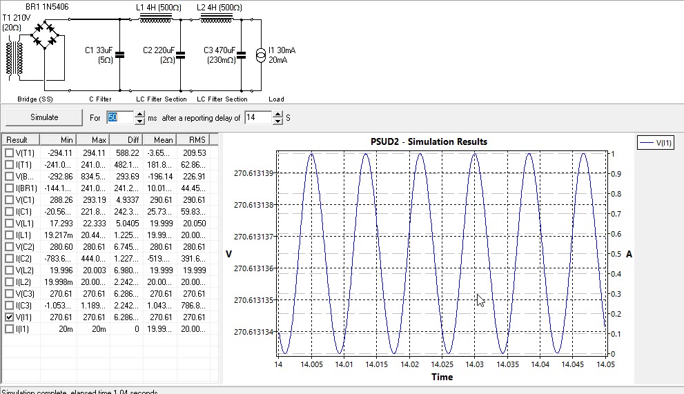

Also use the rectifiers you intend on using where possible, since it will model the drop across them as well as give you an indication of whether you are exceeding their current capability or PIV. Also, I find that using a 1000mS window is too wide and you cannot see what is happening for all the 120Hz ripple, I like to use a 200mS window. The only case I would use a longer window is if I wanted to see turn on behavior to see if the voltage spikes up excessively and how long does it take for the power supply to charge up.
It is a very useful tool.
Got rid of the ringing. AC ripple is 0.7 micro Volts. Does this look good enough?
