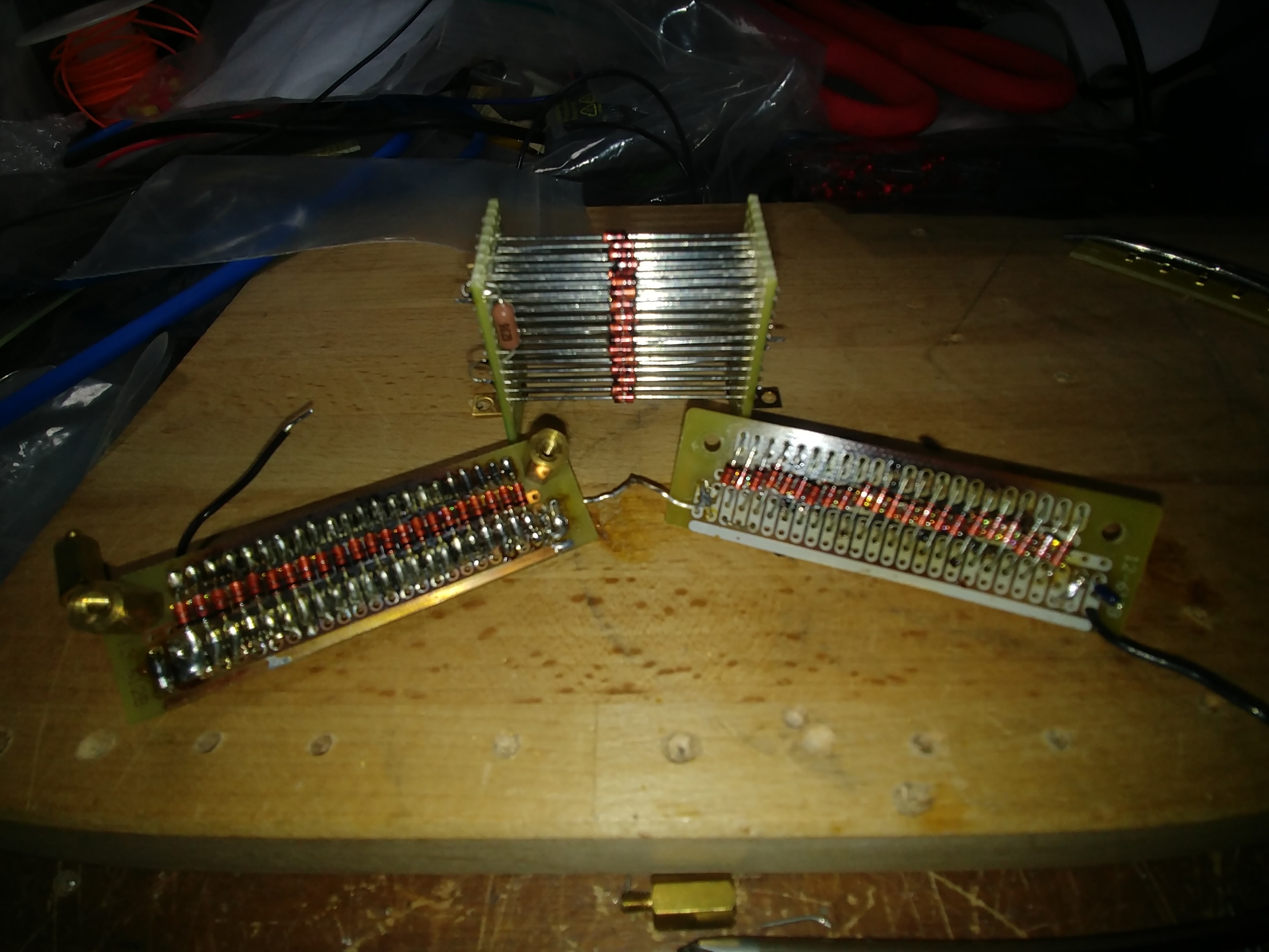

Well, the 12B4 preamp is sidelined. Since the beginning of the week we had been trying to track down a odor in the house, a strong electrical or electronics smell. I knew my preamp was running warm with all the heatsinked mosfets in the current source. I also knew the zener diode string I built on an FR4 perf board also was running hot, but after several days of continuous running, it seemed to reach some thermal stability, warm, but not hot. I did have a bit of a smell at first, but it seemed to not as bad over time. I had it off most of the day today, and the smell in the house dissipated. When I turned it back on for about an hour or so, my wife complained the smell returned. She told me to turn it off. Good that she did, I inspected the zener regulator board, and the board was very discolored and the back side of the board with the solder connections showed the solder had turned from a shiny to pasty surface, like some melting was occuring. I now understand why Morgan Jones wires the zeners on a tag board keeping full airflow and lead length to dissipate the heat. Sinking 20mA at 220V is dissipating 4.4 Watts, and I had two regulators stacked one over top of each other. So don't do this! I have to figure out a way to recover, since I don't have a lot of space to work with. May have to look into a simple tube or mosfet regulator to either get the heat out of the chassis or sink it to the already warm chassis.

Well, I figured out a way of building the two diode strings for the statistical regulator in a compact form that should solve the thermal issues. Zener diodes use the leads for heat dissipation, so I soldered up an array on spaced perfboards that provide for air circulation around the leads, rather than soldering the leads short on a circuit board. I have two 207V regulators (string of 37-5.6V zeners) on this little module. I will cut back on the current through them to around 10-15mA (I was running 20mA). A picture of the original regulator boards and the new assembly is attached. This fits in the same space in the preamp chassis as my original stacked boards. I am adding (drilling) ventilation holes on the bottom of the chassis directly below the regulators (I only had ventilation holes on the top originally).
You can see the overheating on the old boards. Basically a fire waiting to happen. The back side (not shown) is even worse.

Did you derate the zeners? I never use them at more than half their rated dissipation. I also rely on the connections at the end of the leads rather than the leads themselves to act as a sink. The only reasons I can think of that your original boards got so hot was that either each diode was dissipating a lot of heat or there were so many in close proximity that the total power on the area of the pads was excessive. What was the total power calculated for the string?

I had 20mA through each 5.6V zener. This is 0.11W per zener, for a 0.5W rated part. Based on the rating, the diodes should be able to handle a maximum of 89mA. But with the zener diodes flush against the board, and the short lead lengths, there was no way for the heat to dissipate, so all that heat was being sinked into the circuit board material itself, causing it to overheat, discolor, and smell. Having the leads completely free and able to dissipate heat to the surrounding air, and backing off slightly on the current through the regulator, should help alot with the thermal issue, and the boards hopefully should not overheat. If not, then back to square one.

Thanks. As pointed out, the problem was not device current, but heat dissipation of the concentrated assembly. My first choice would have to use the cold cathode gas regulator tubes, but the use of a chassis with a removal top plate and the internal arrangement made that challenging if not impossible to do. If I was starting from scratch, I would consider that, although Morgan Jones felt that the "Statistical Regulator" was a lower noise approach than using gas regulators. So it was a matter of figuring out how to get it done in the tight space I had. I will have to see how it works out. I just hope that I haven't made a mistake in the direction of one of the diodes in the string of 37 per regulator.
