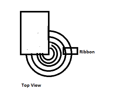

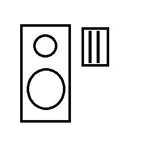

My memory may not be accurate, aren't your ribbon tweeters beside the main speaker box like this?
If so, your ribbons might be suffering from the mid range edge diffraction of the box. I would handle it first. Try positioning the tweeter on top of the box, slightly forward of the front face of the box and tilted down aiming at the listening position.
