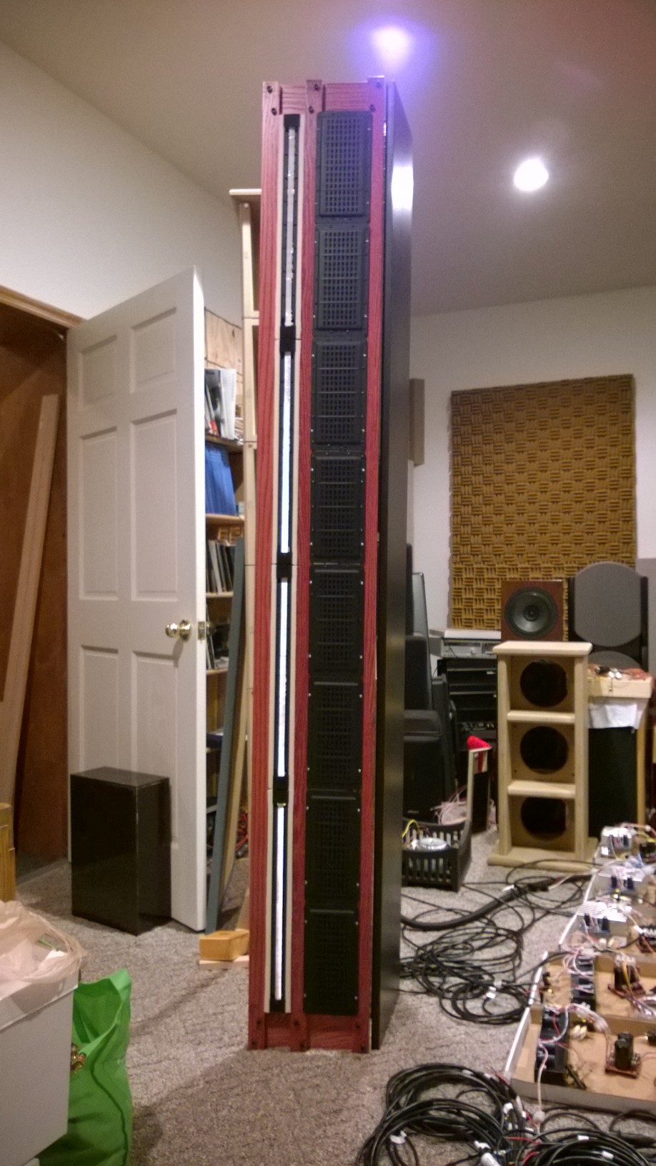

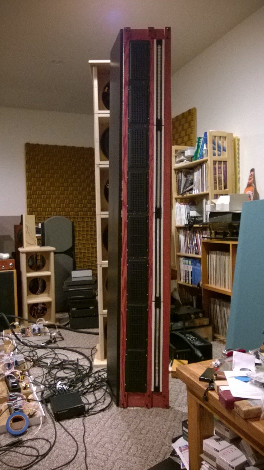

After some baffle rework, have the 4 ribbon tweeter arrays installed in The Megalith baffles.
The second phase will be a trial with the DSP crossover with 8 channels, where the final phase will include the 16 channel version.
Will see how the new wiring goes to the tweeter amps.

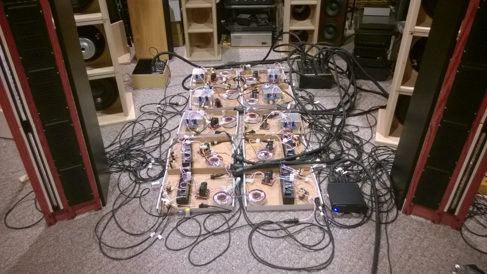

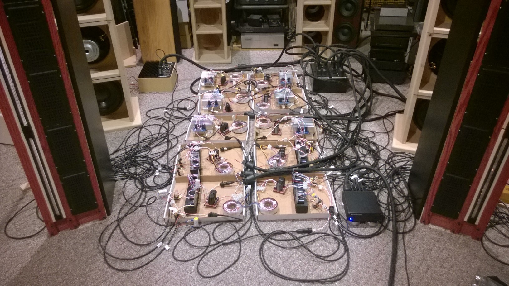

Posts: 943
Well The Megaliths open baffle ribbon/planar/servo sub array stage 2 came alive this week with the simplified digital and passive crossover until the 16 channel version is available. Listening with the Greg's ribbon tweeters has been very good so far, and should improve with the added flexibility of the added channels. No idea when the 16 channel version will be available.
Will be making some measurements and use MathAudio RoomEQ for digital replay and see what happens.

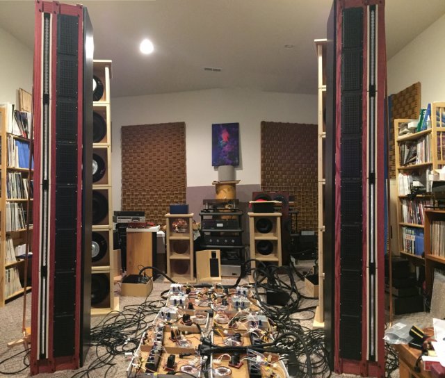

Did another demo of The Megaliths for Dan who bought a pair of my old speakers. Bob was over as well. The session was short, but sounded very good to everyone.
Stage 2 is working well. The digital crossover with the new HiRez DAC's sounds much improved to me.
