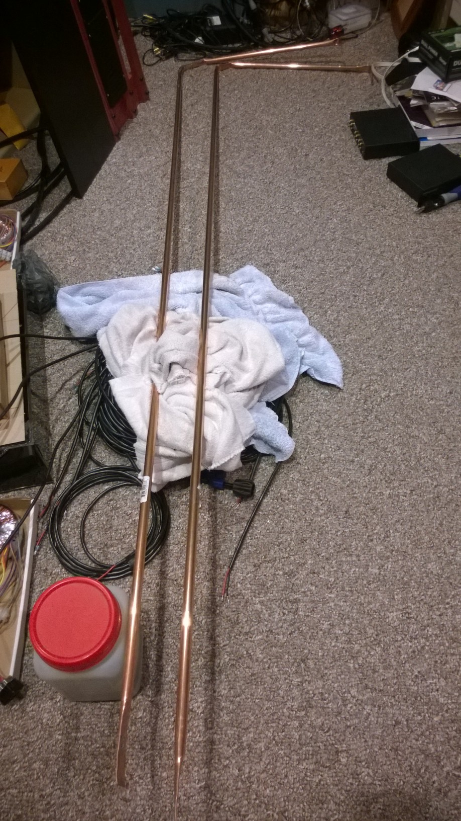

Went to Lowes and purchased an adjustable pipe cutter. Marked the stabilizer length for keeping the baffle vertical and cut off the excess pipe. Very easy to do after seeing a plumber do it awhile back with that style tool. The pipes, shot and tools cost about $85, so less than $43/stabilizer. Could have used a 1"x2"x8' piece of oak, but I like this look better.
Next add the lead shot to the pipe, seal and flatten the other end for mounting hole drilling.

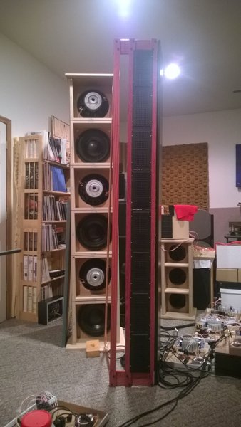

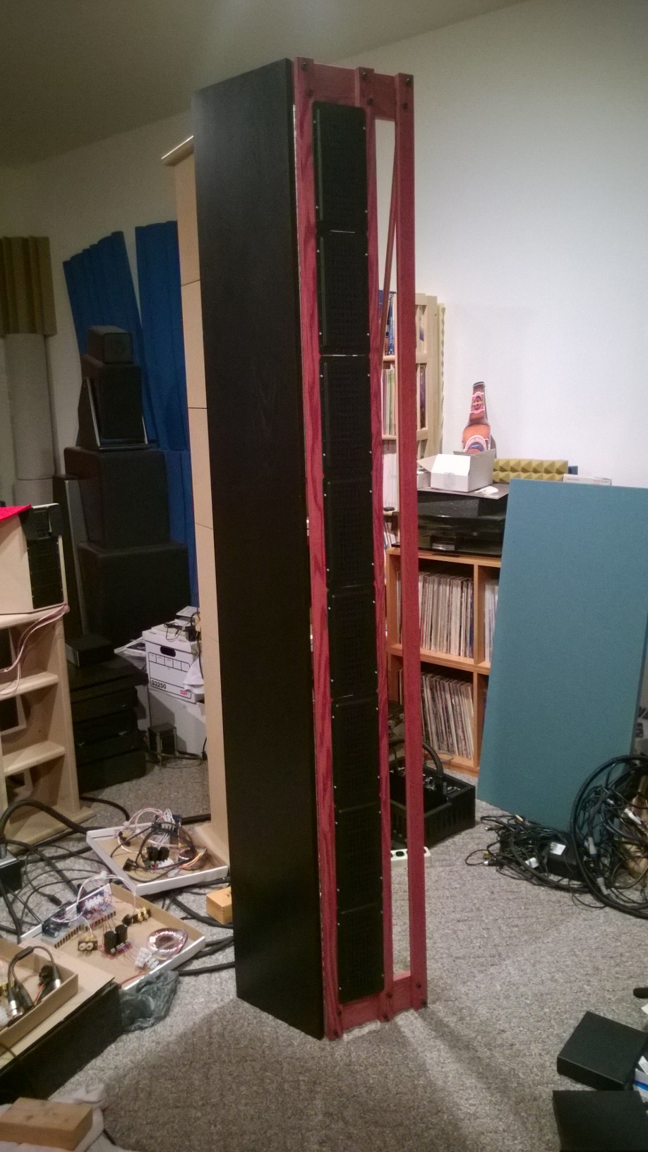

Added the lead shot to the stabilizers today and closed the opposite end. The shot is now captive in the copper pipe.
Next is to bend the angles, drill the mounting holes and attach to the baffle.
PostPosted: June 6th, 2016, 10:17 pm
Posts: 943

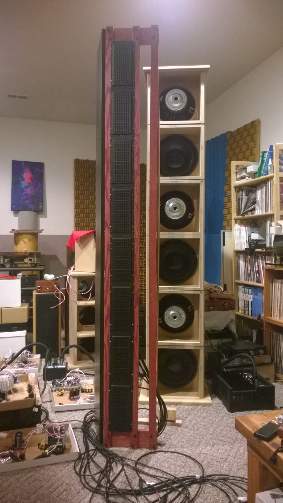

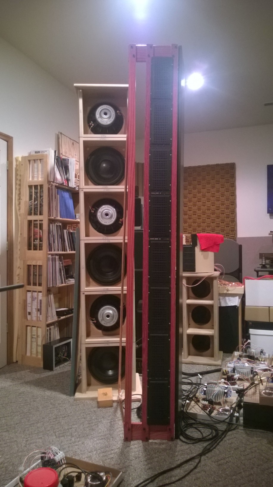

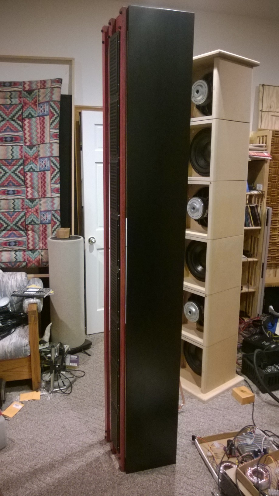

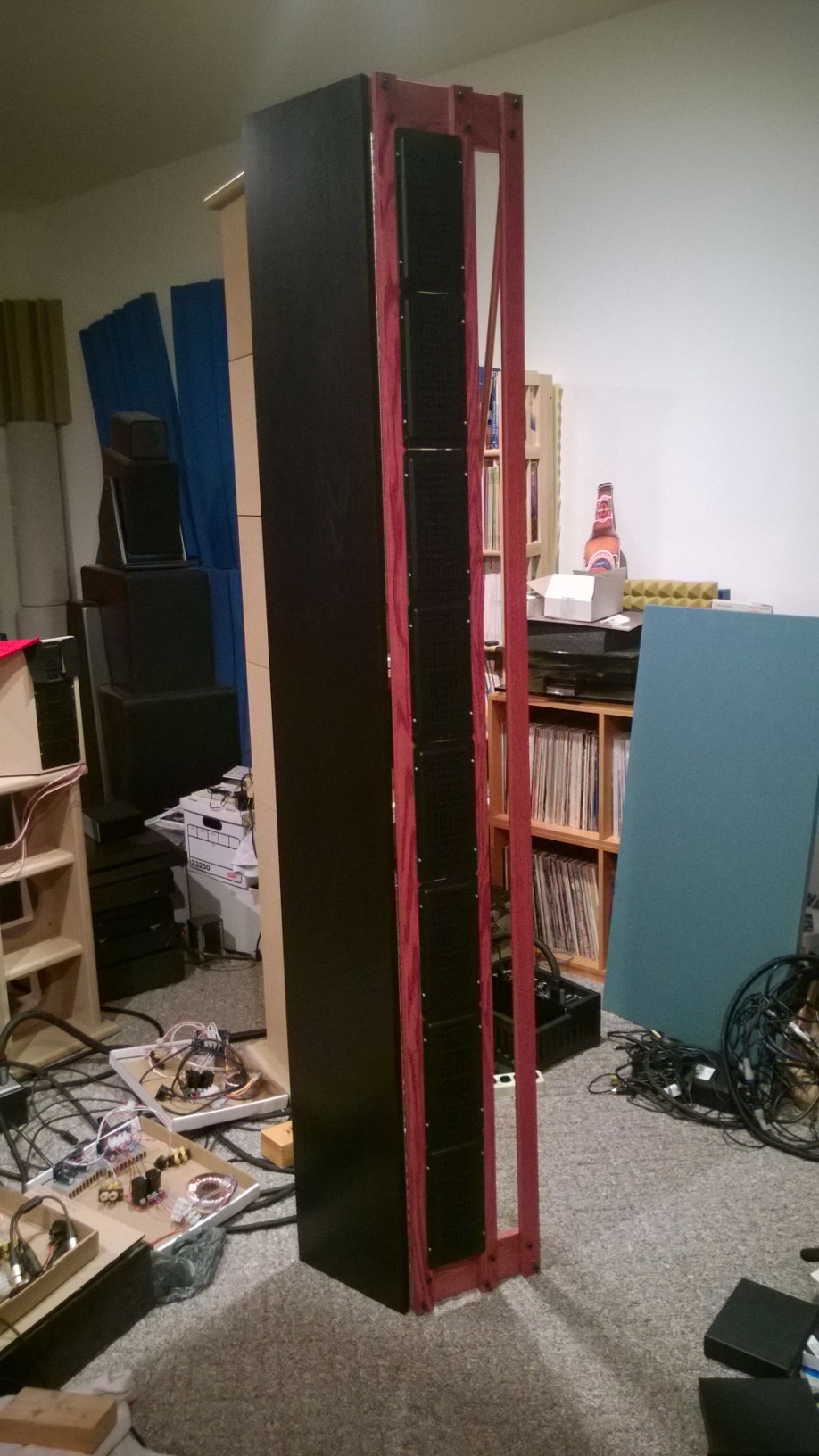

Baffles completed and standing.
Next to wire up the Neo10 drivers and see how they measure.

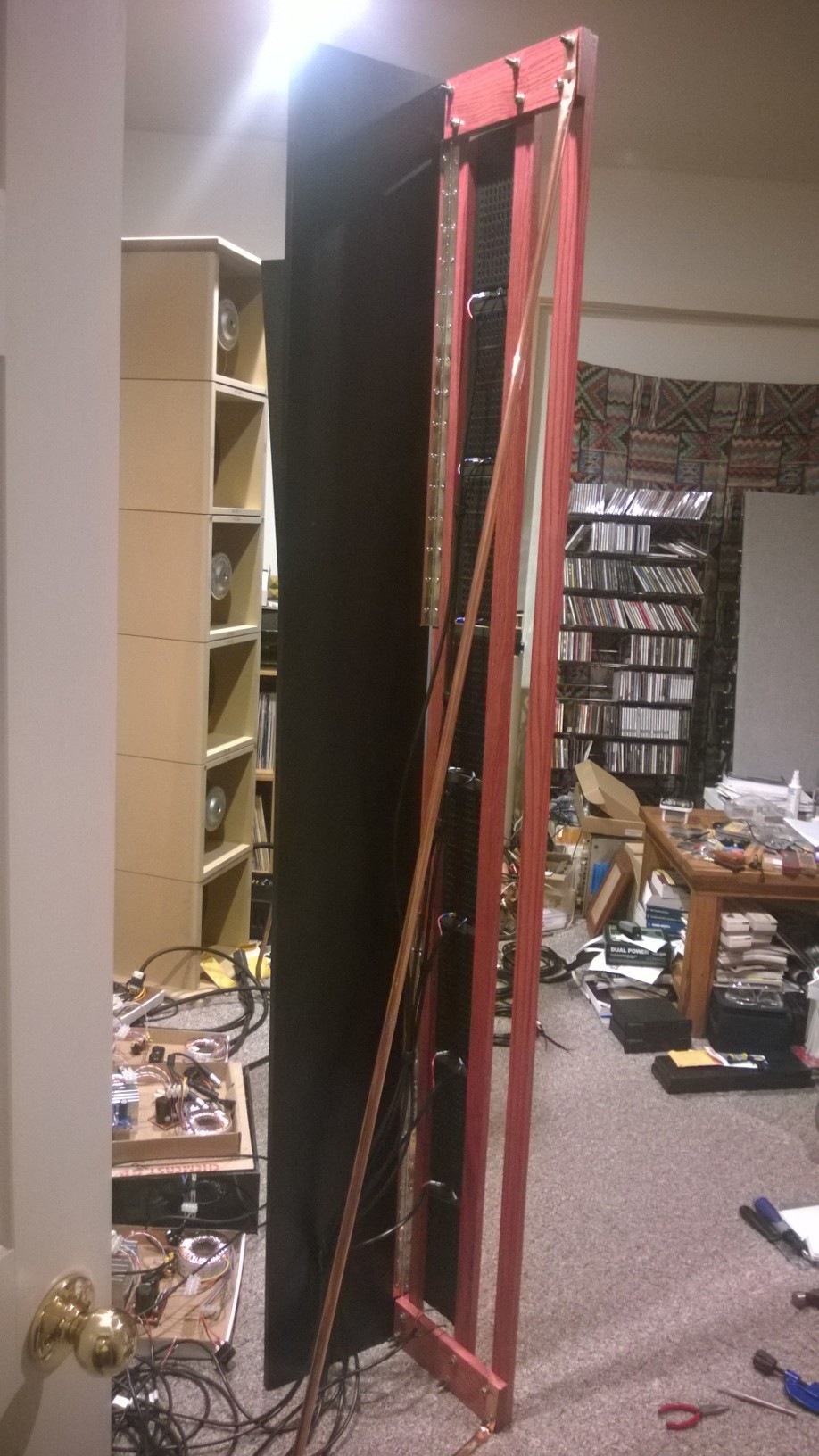

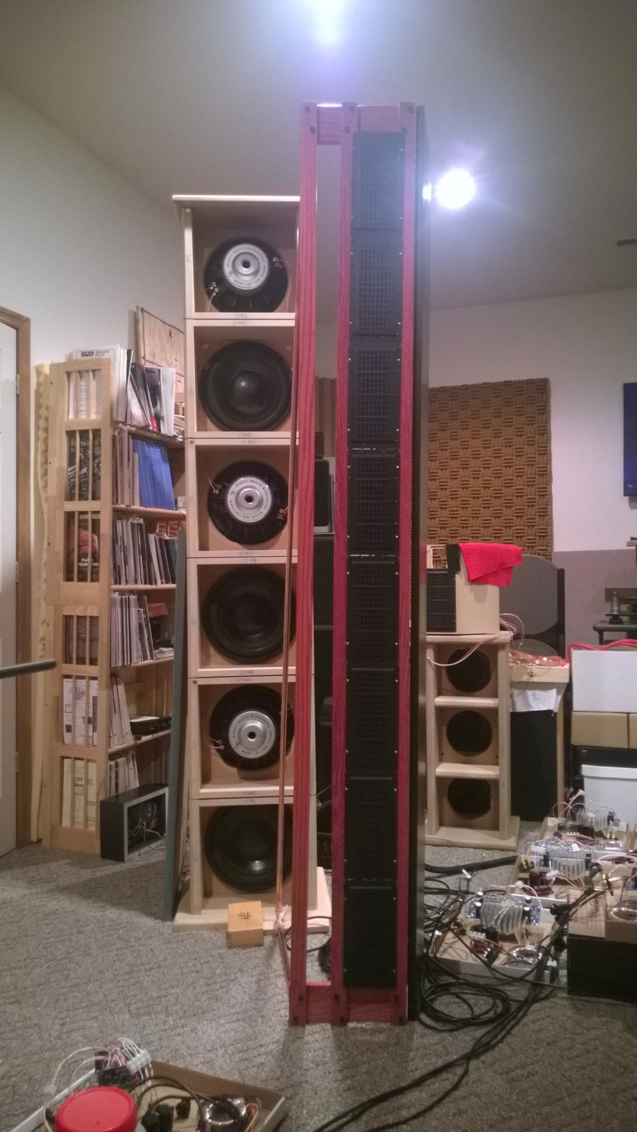

Yes. The wiring of the planars is complete.
Next to check the wiring and then connect to the amp modules. Then try to not let any magic smoke out.

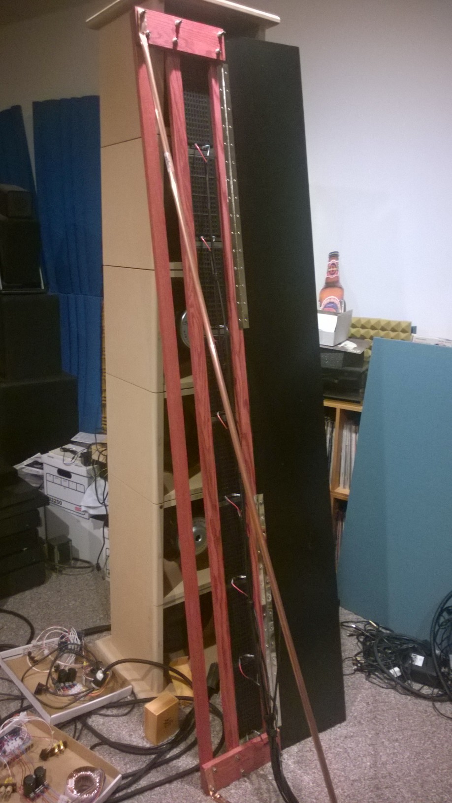

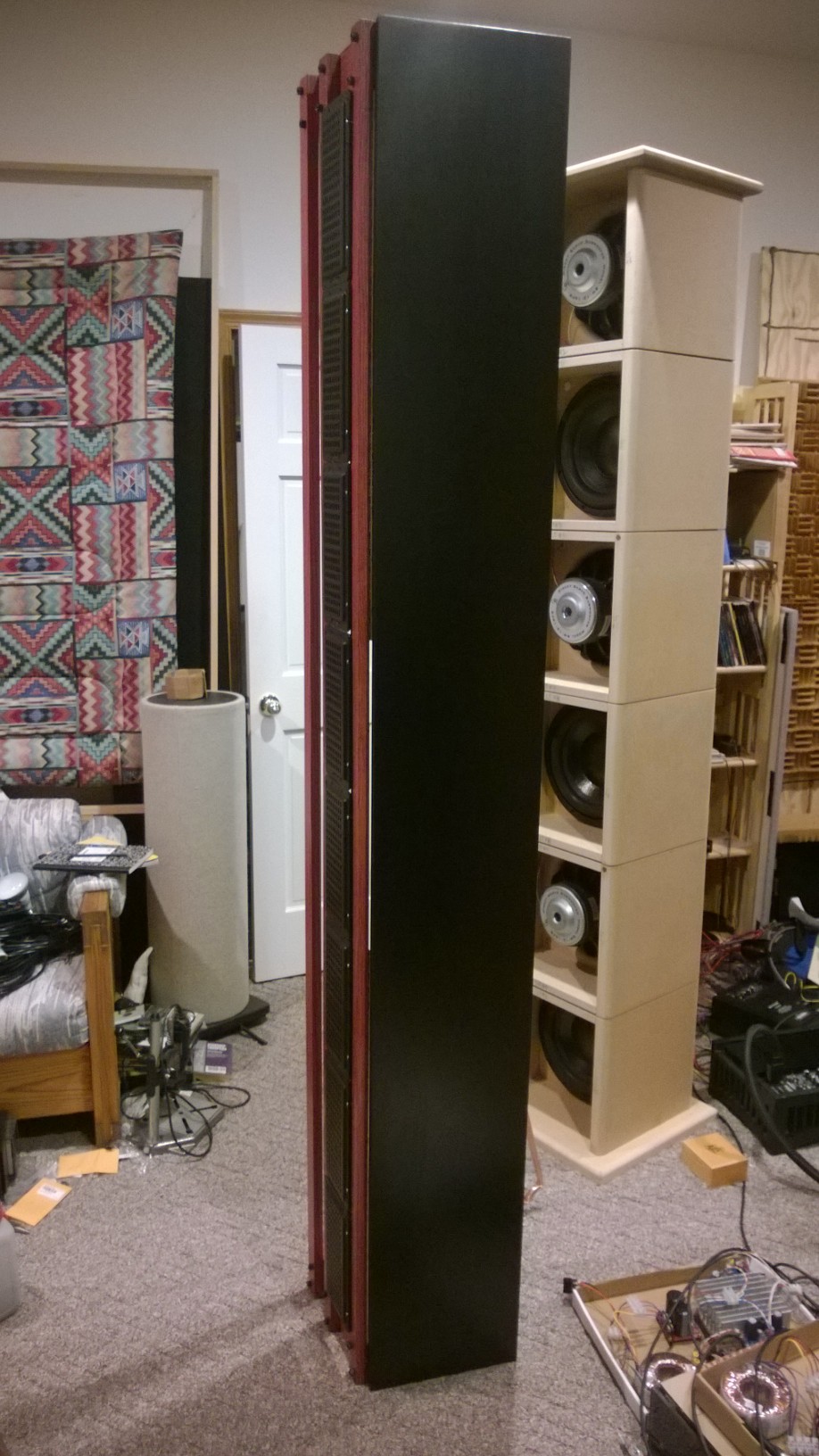

Baffles and servo subs setup.
Wiring is ongoing and will be completed tomorrow. Then on to measurements.
