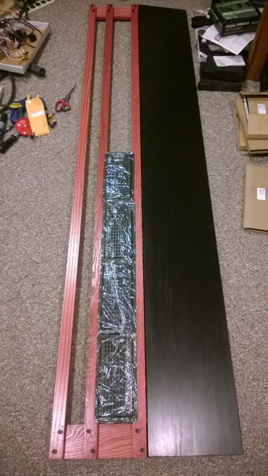

Probably going to end up getting longer #4 wood screws as the rivets are high and not getting much grip with the #4 - 3/8" screws. Longest that McFeeleys have with square drive is 1/2", so ordered more. Glad I went with the smaller pilot hole size for more grip.
Will keep installing and see what happens.

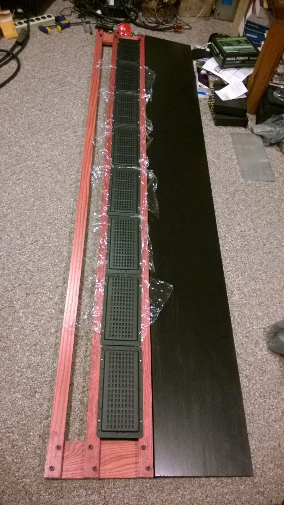

PostPosted: May 22nd, 2016, 9:04 pm
Posts: 943
First half of the array is installed. Will do the second half install tomorrow and then start the second baffle.

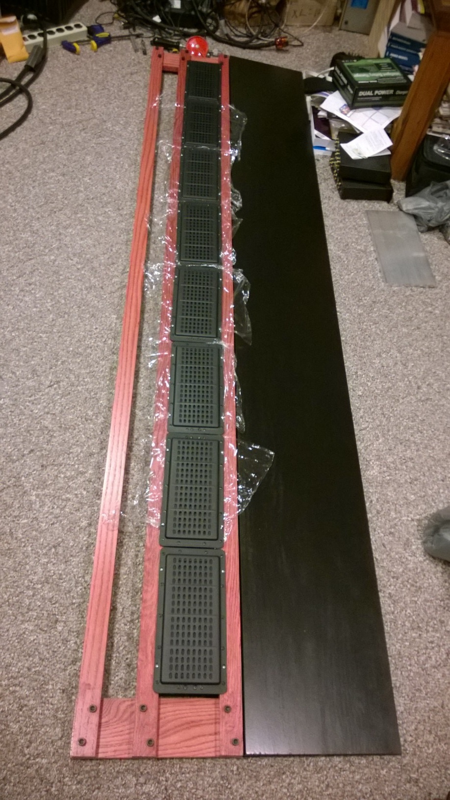

First baffle with 8 - BG Neo10 drivers installed.
Will start work on the second baffle tomorrow. Then align all the drivers.

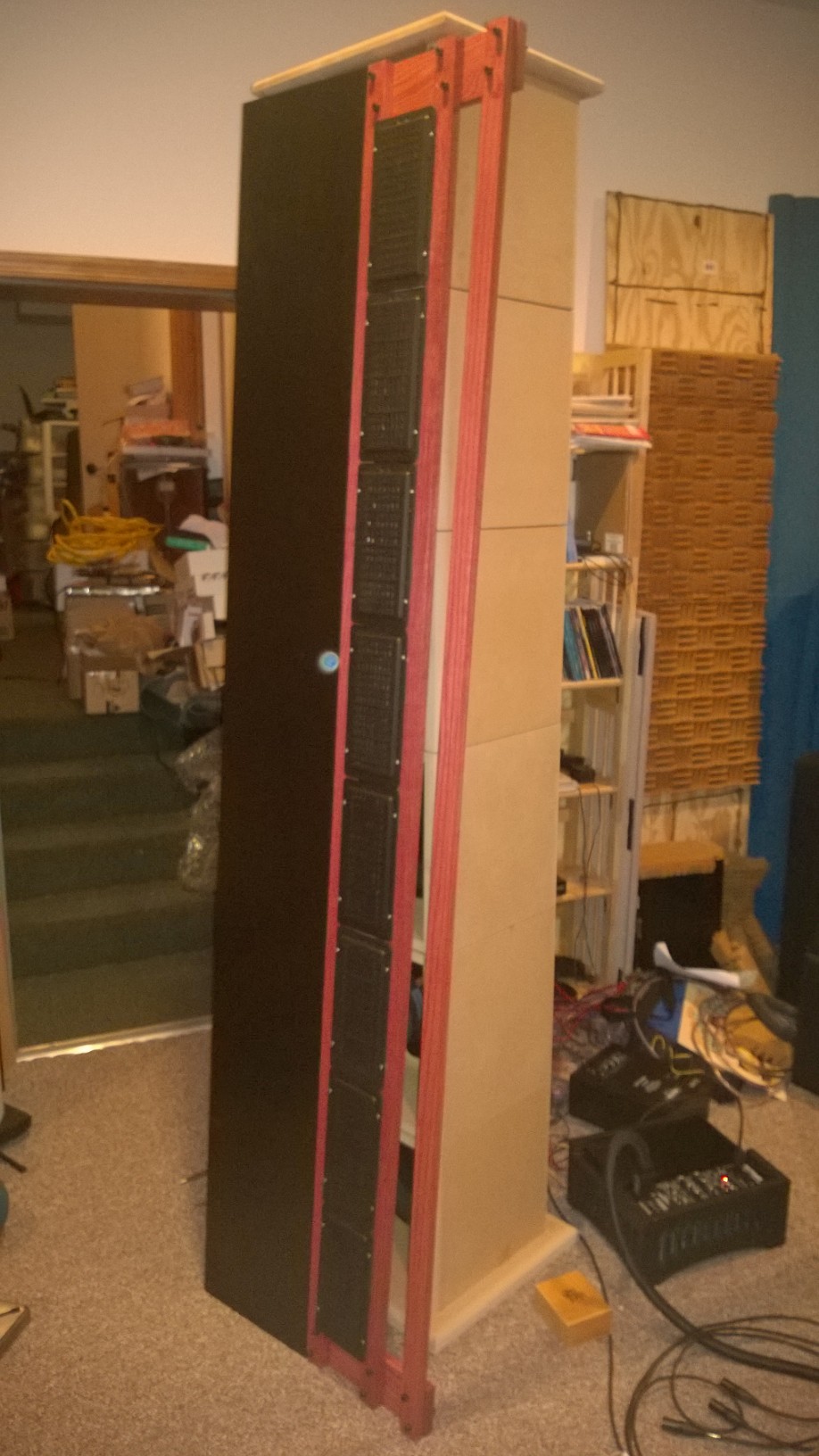

PostPosted: May 30th, 2016, 5:33 pm
Posts: 943

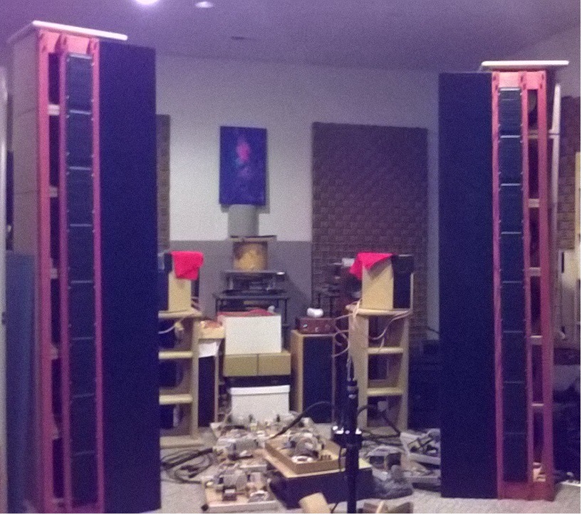

The Megaliths baffles with the BG Neo10 planars are completed.
Time to wire up the drivers to the amp modules for measurements.

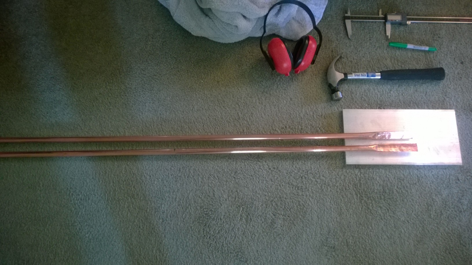

PostPosted: June 1st, 2016, 3:28 pm
Posts: 943
The counterweight stabilizer for the baffle.
Copper pipe with end hammered shut and marked for bends. Bend pipe angle needed to attach at the top and bottom of the baffle. Add lead shot to add weight and then hammer the other end shut. Drill holes on 2" center to attach to the baffle bolts.

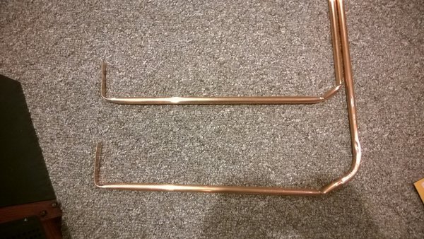

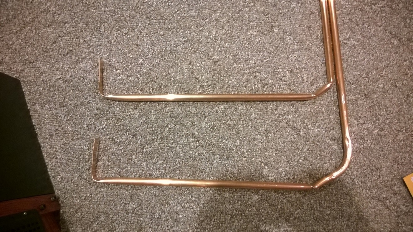

PostPosted: June 3rd, 2016, 5:40 pm
Posts: 943
The right angle bend for the baffle attachment on the bottom of the stabilizer is finished.
Next will be cutting to length, adding weight and flattening and bending the other end to attach to the top of the baffle.
Last steps before wiring up the drivers to the amps.
