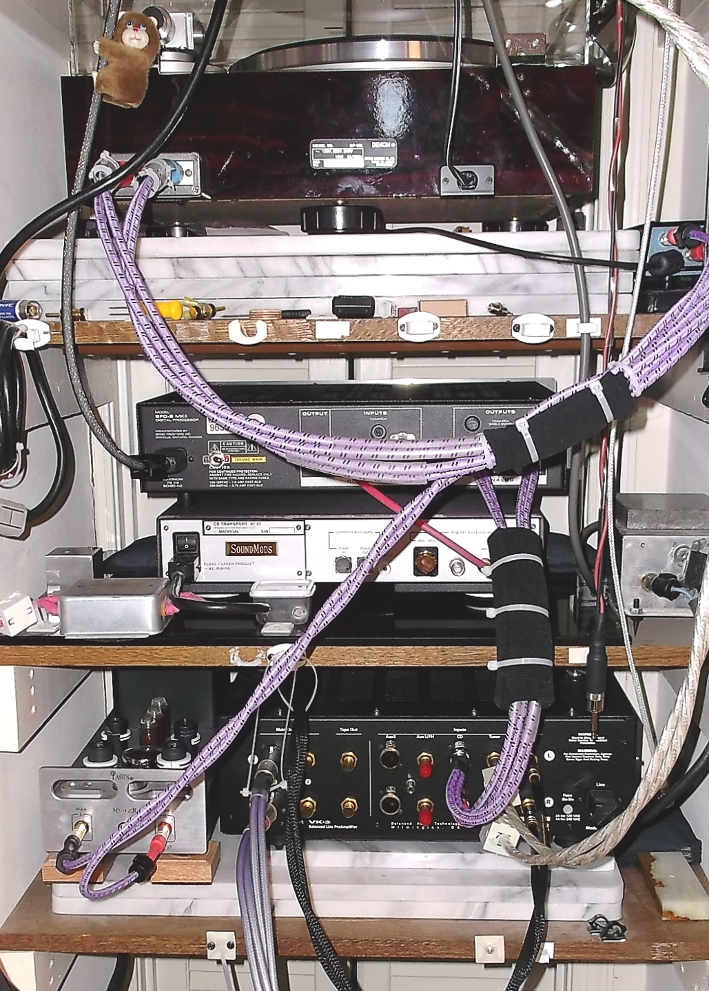

I've attached a photo of the rear view of my set-up with Phaseflex.
