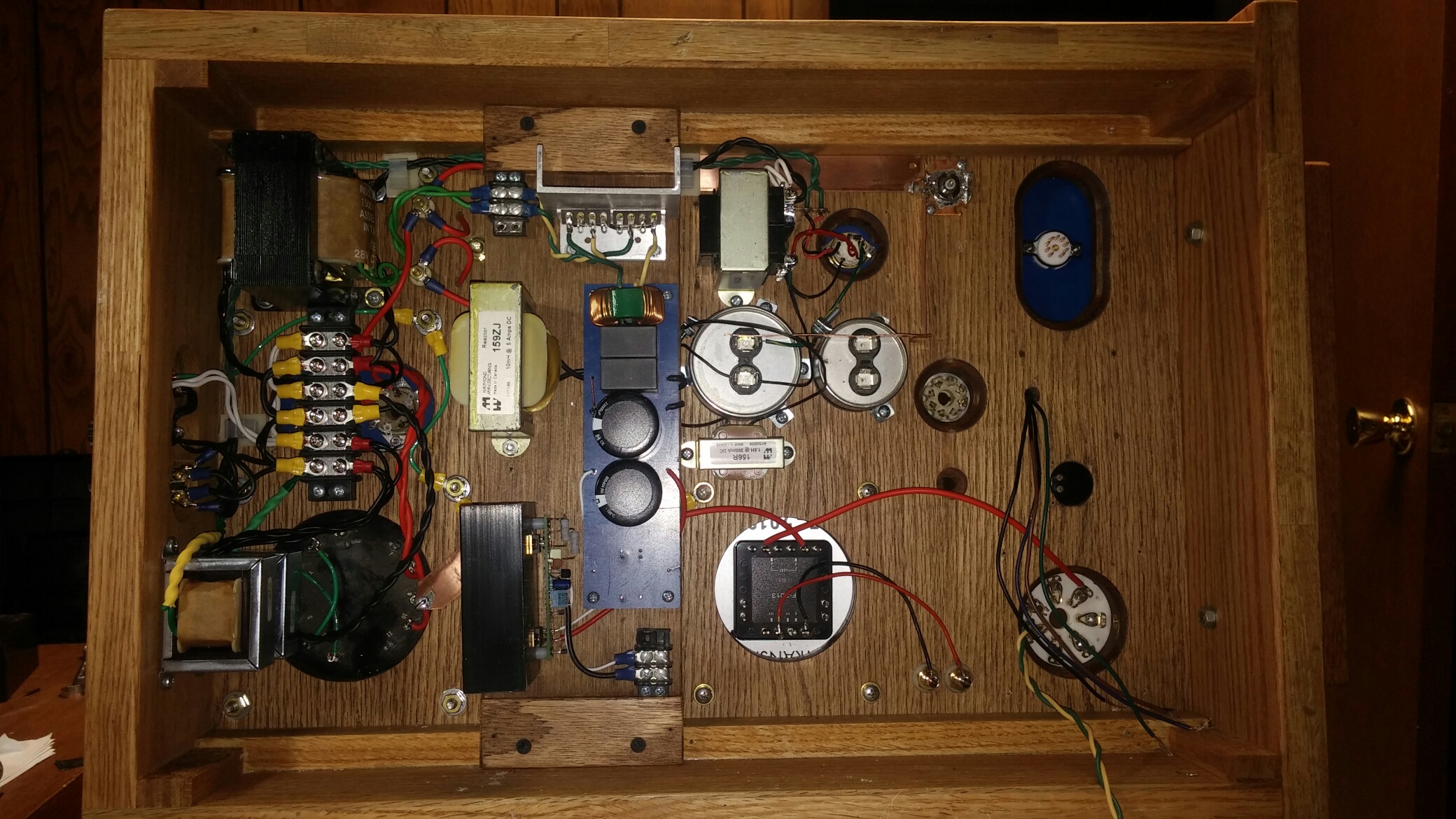

Made good progress last night, power supply wiring nearly completed, output transformer fully wired to GM70 plate and amp output terminals, Coleman current regulator installed, just need to wire up the driver (including finishing the power supply) and the GM70. Looking like I may have this done by the weekend!

PostPosted: February 24th, 2016, 1:28 pm
We po' folks use 3m copper shielding tape for ground busses.

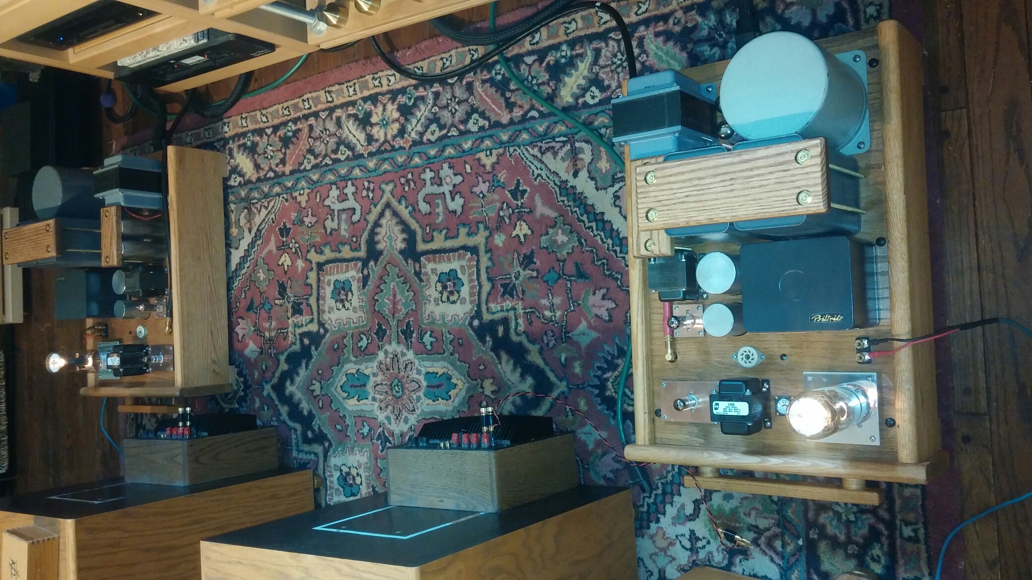

Finished the second amp and both now in the system. Now the break-in process. Highs are slowly coming in, but the amp does have quite a sense of authority. I do not need subwoofers.
