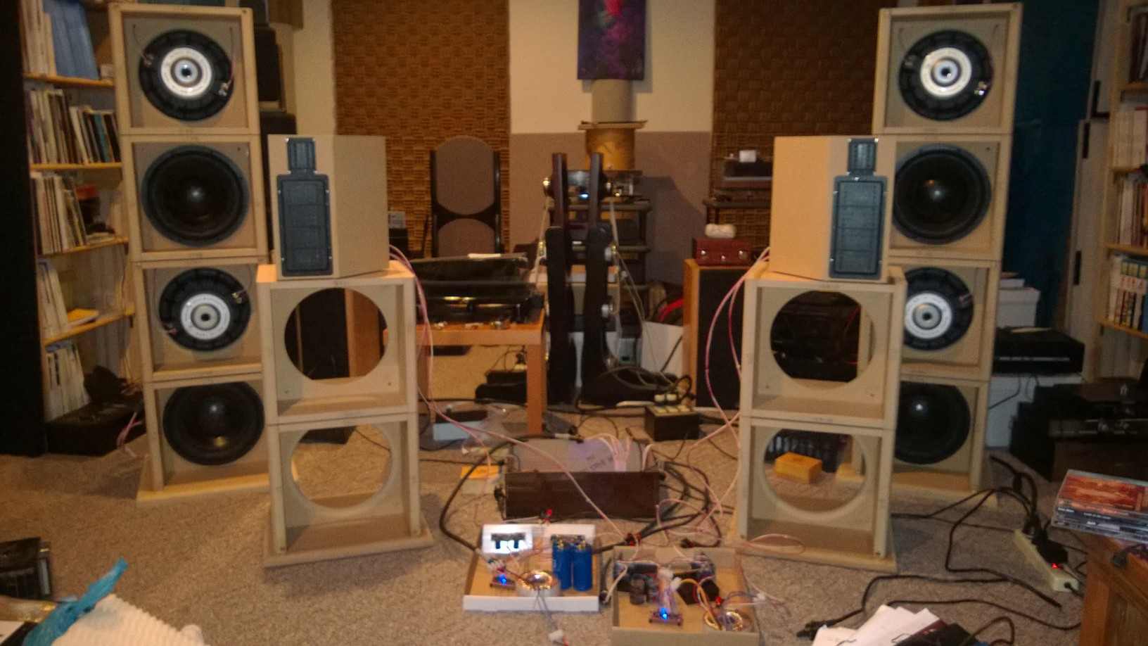

The full servo bass columns will look like this when all the 12' drivers are installed. Just four more to buy and install.

Awesome!

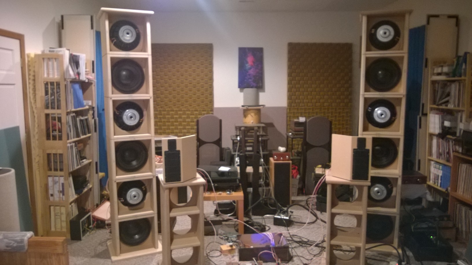

The setup with the planar OB's and 4x12 servo subs.
Have all the modified ChipAmps running and setup with the digital crossover.

We can almost taste it! (Did I say that out loud?)

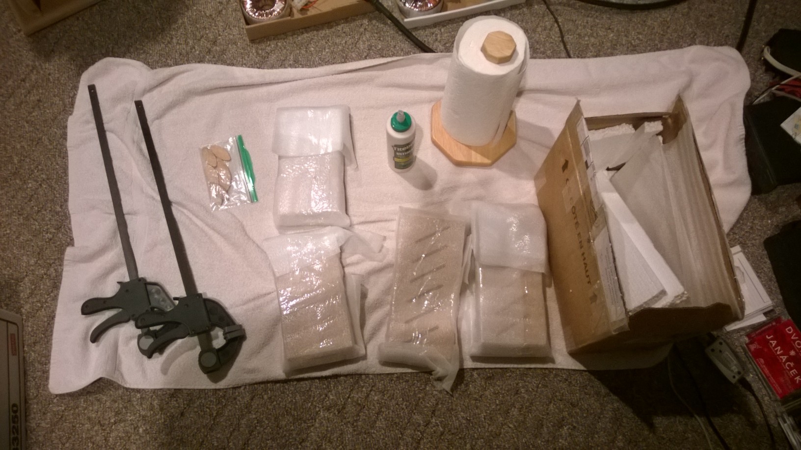

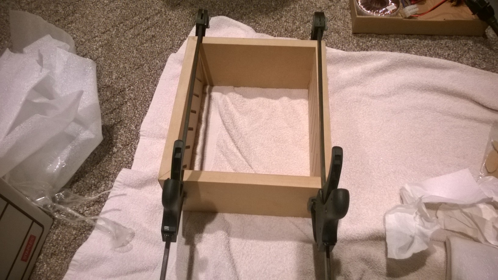

The servo amp boxes are flat packs. Glued the first one up today.

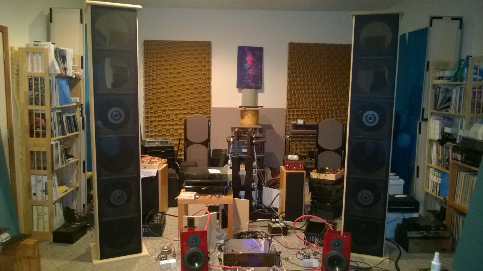

The two open baffle 6x12 servo sub array's are fully operational and sounding very good!
A good day for some pipe organ music!

Don't forget to tell us how they sound! That should push a lot of air around.
Do you have to worry about SAF? (Spousal Approval Factor) ;)
