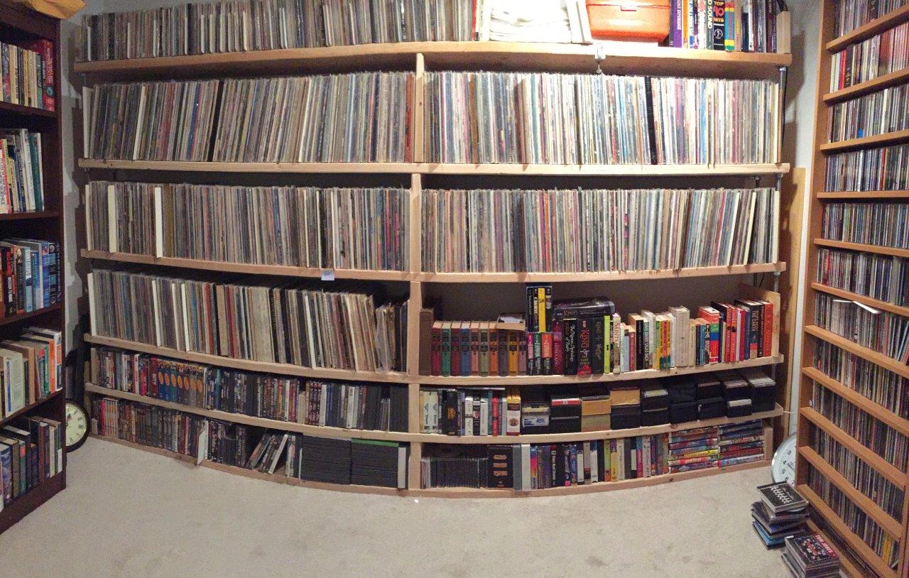

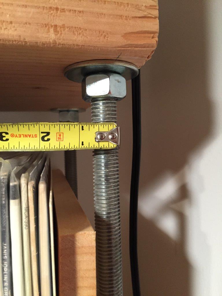

A question was raised would 3/4 rod be able to support a heavy stereo. To that I would say likely yes. attached are two pictures of what I did with 3/4 rod and some 2 x 10 boards. Each shelf is independent so you can say, (approx) 10 feet of records / 4 nuts is the load each nut is carrying.
This is a pretty easy straight forward project but if you have questions let me know. I attempted to add a powerpoint slide show to this post of how I built this record shelf but the pptx extension is not allowed, and the file is 3.7 MB
- John

Break Break - OK 2 corrections, I used 2 x 12 boards (10 feet long) and I do have the center support boards so the weight on each nut is not
10 feet of records divided by 4. It is more like
Approximately 5 feet of records kind of divided by 4.

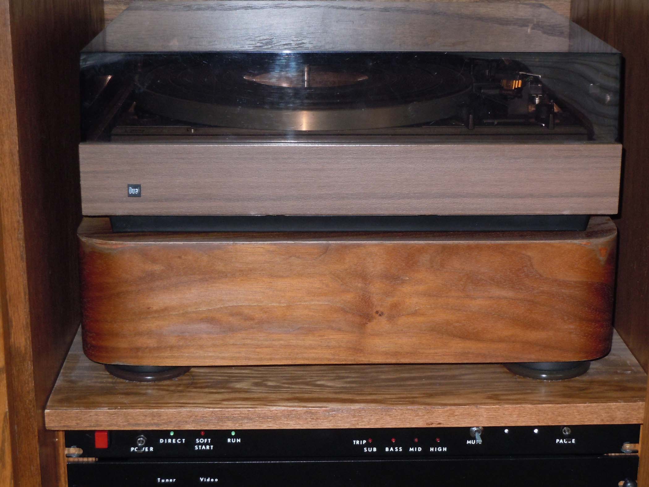

For may turtable I built a box out of MDFD and then filled it with sand. I then placed it on four Sorbothane feet that I had but could just as easily have used squares cut out of sheets. To get a thicker pad you can just use more squares stacked on top of each other. You can get them online from many places. Like any rubber material you should use something to keep it off finished wood to prevent staining. Here is a link:

It comes in many thicknesses and durometers. The lower the durometer the "softer" or more compliant it is. Although you cannot completely eliminate transmission, the resulting frequency of the vibration is subject to a mass-compliance ratio. The greater the mass and the greater the compliance, the lower the frequency. With a turntable it is not difficult to get the resulting vibration below the resonant frequency of the arm/cartridge combination. Once below resonance, the amplitude of the vibration picked up by the cartridge is greatly reduced similarly to the drop off in bass response below resonance. I'm including a photo of my setup. With this setup I can jump up and down on the floor and the turntable will not skip.

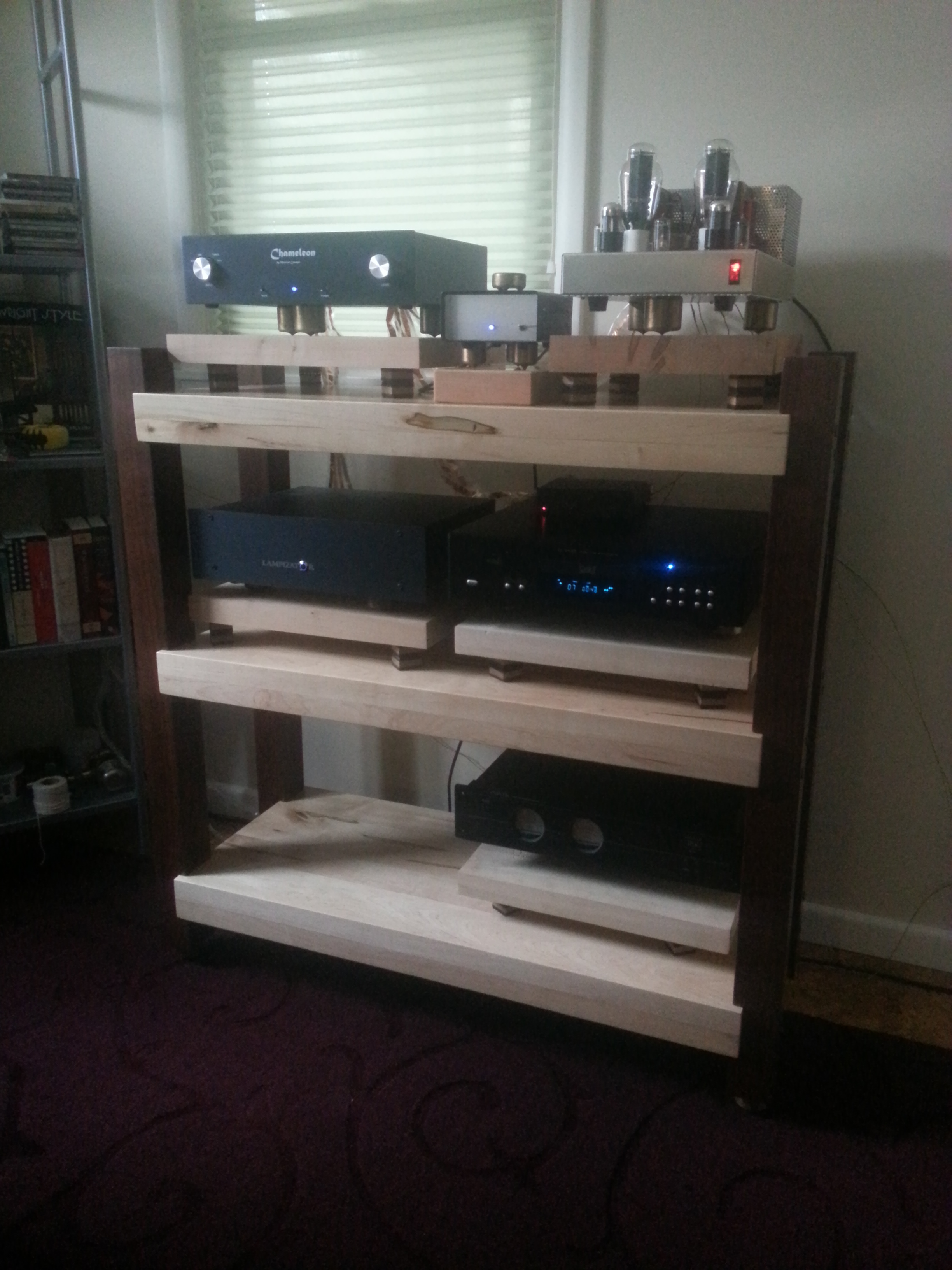

Here's a picture of my rack with the rest of the maple. I decided on fixed height shelves and solid leg attachment, 3-1/2" square legs. Large footers on the bottom, and local isolation of the components.
Jim

Beautiful! I bet that sounds as amazing as it looks! You are a pro!
