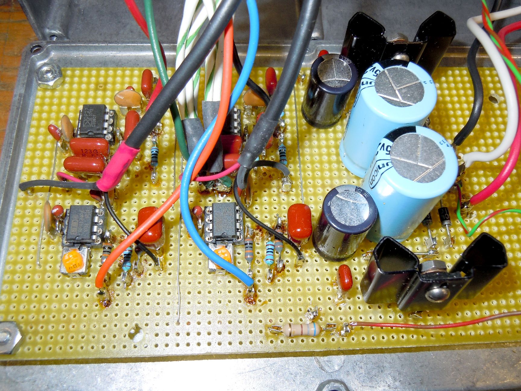

Just for grins, if anyone wants to try a solid state phono preamp, I built a stand alone unit that I use for burning LPs to digital. It uses OP27 op amps for the RIAA section and OPA134 op amps for additional gain if needed and buffering. It also has a gain control pot. The first stage DC power supply is in a separate housing that can be separated from the preamp by up to 6 feet. There is one set of RCA jacks for the input and 3 sets of paralleled RCA jacks for output. I use one output to go to an equalizer and then to the computer sound card, another to go to a headphone amp for monitoring, and a third for anything else like scope monitoring. Here is a photo of the circuit board and links to the spec sheets on the OP27 and OPA134 in case you are interested.

File comment: Circuit board
