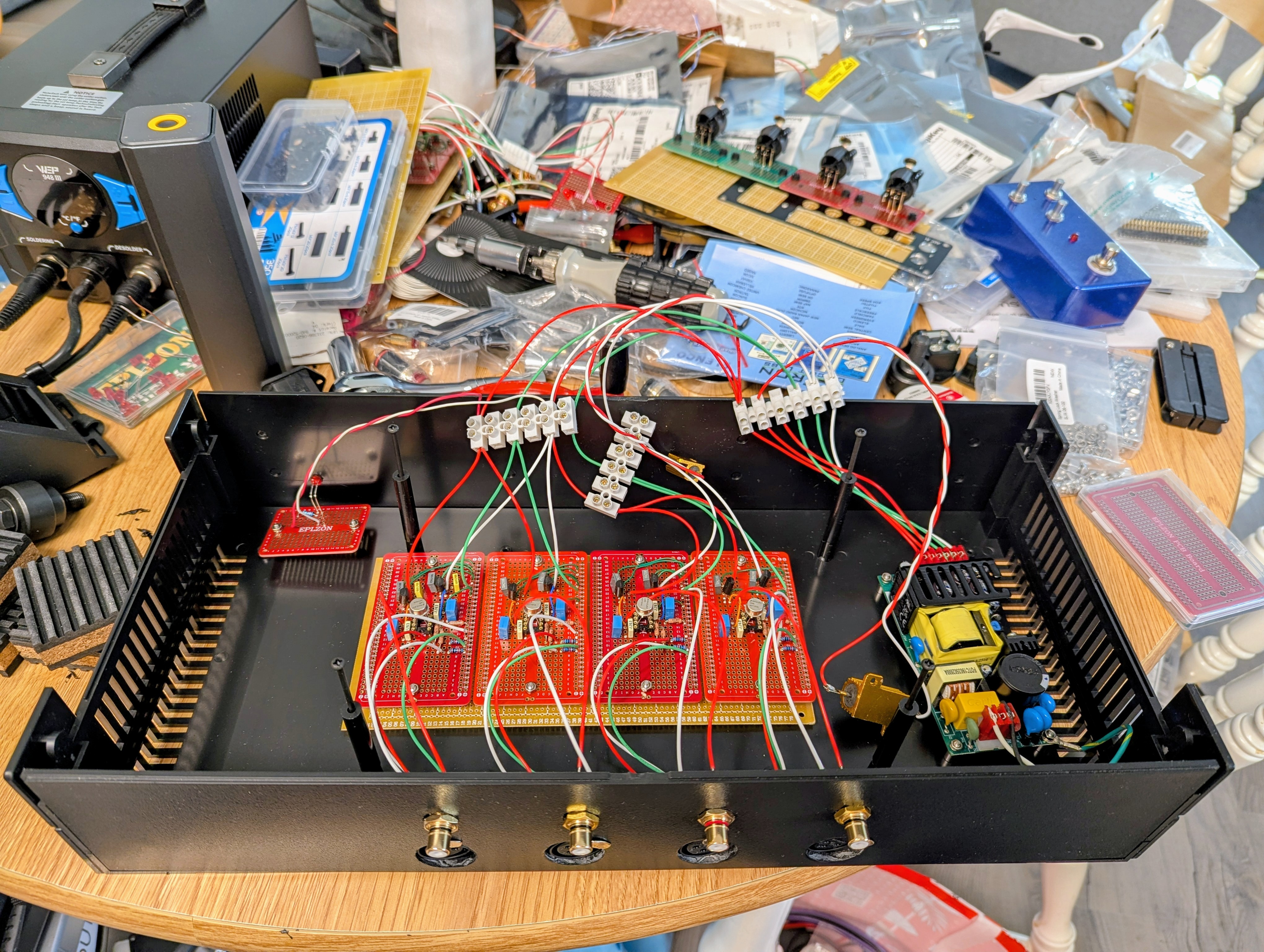

The BUD chassis arrived yesterday and the drilling and cutting has started.
It is 3.5U size for plenty of space to work inside and have height for the discrete opamp heatsinks.

An improvement over his resistor pull down biasing is to use a current source. James Borgiono showed one method. TI makes the NS LM334 an adjustable current source as well.
The chassis is getting drilled and cut for connectors and AC power access.
