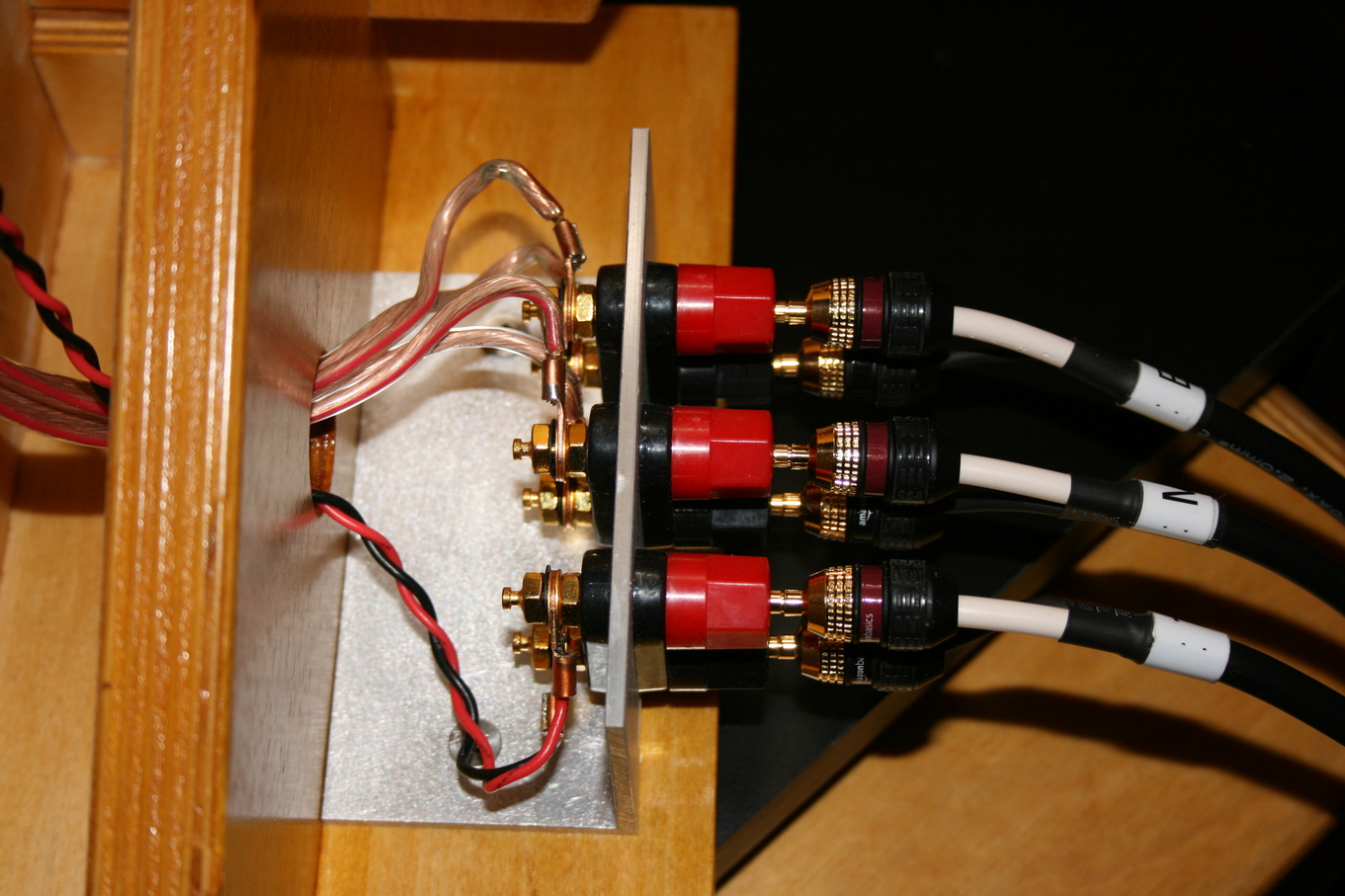

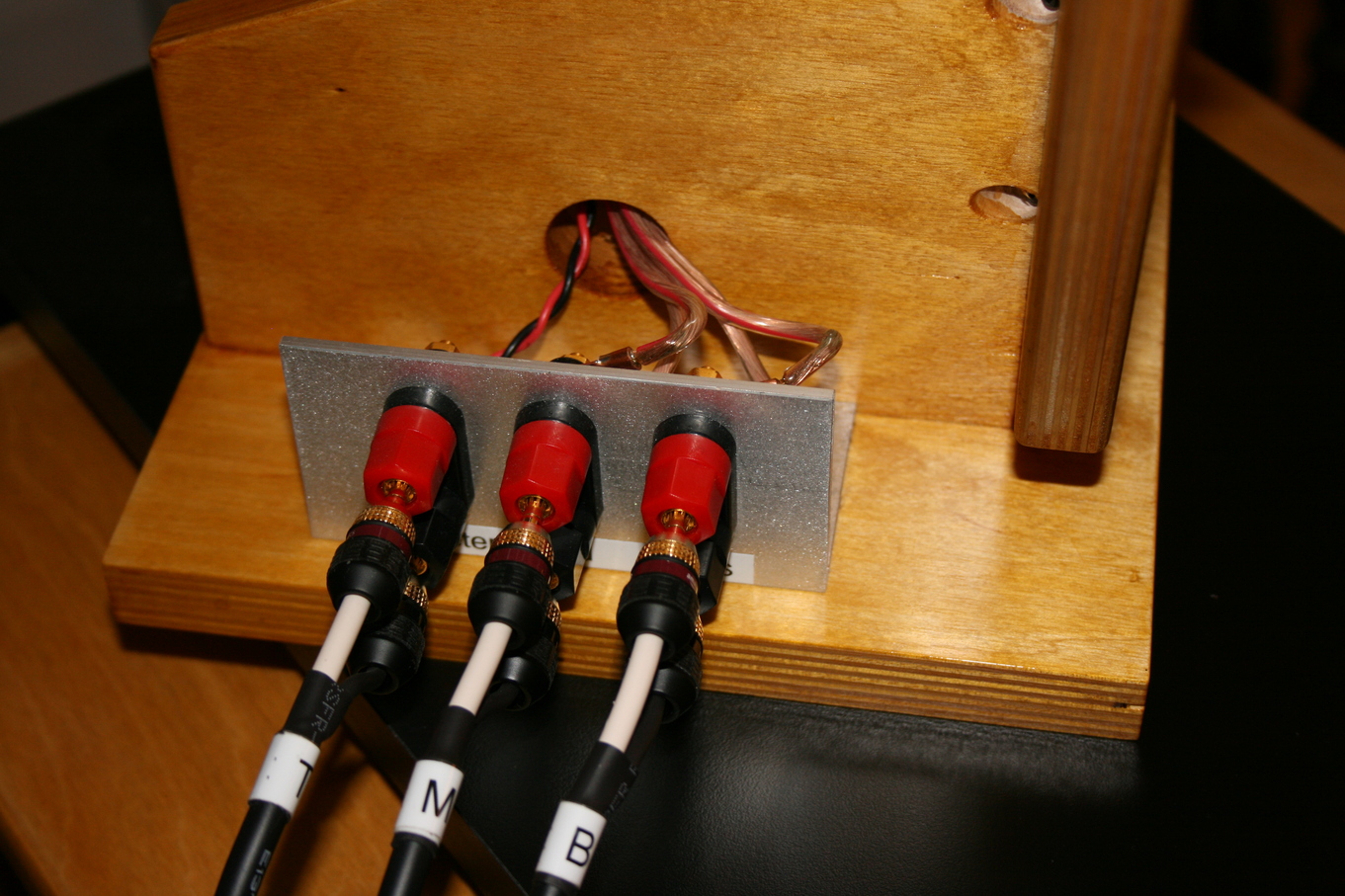

I have a Fostner bit to drill the holes for the second type of binding posts if you want to borrow it (requires a drill press) or drill the holes in my shop. Here is the connector panel for my LX521.4 -

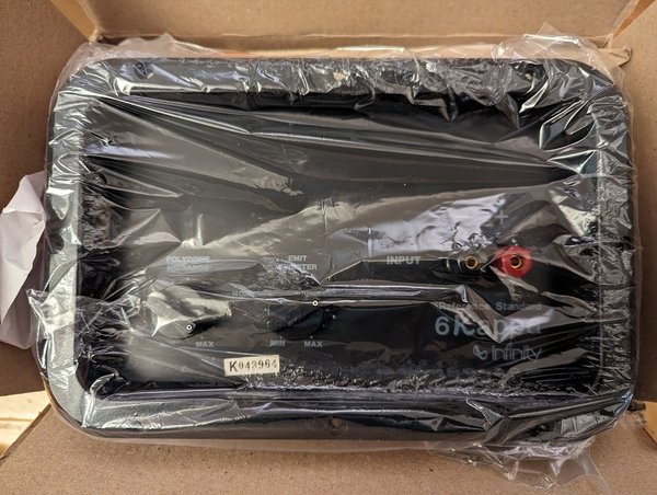

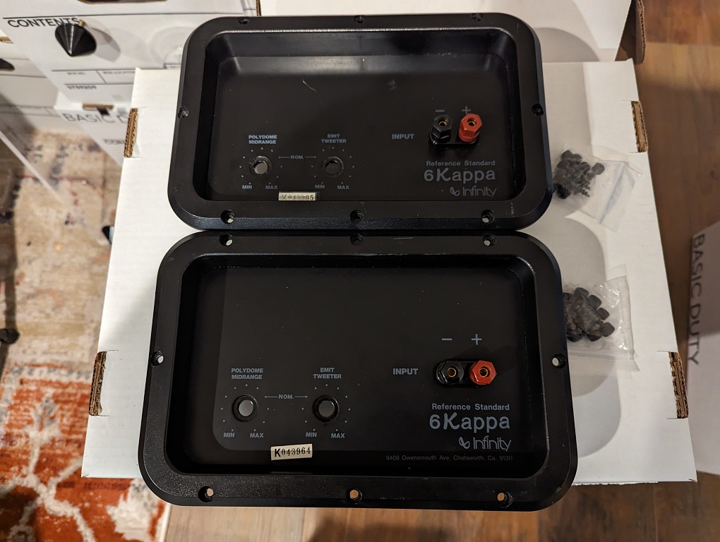

Thanks for the offer! Looks great, but I have two of these to modify to install the new connectors.

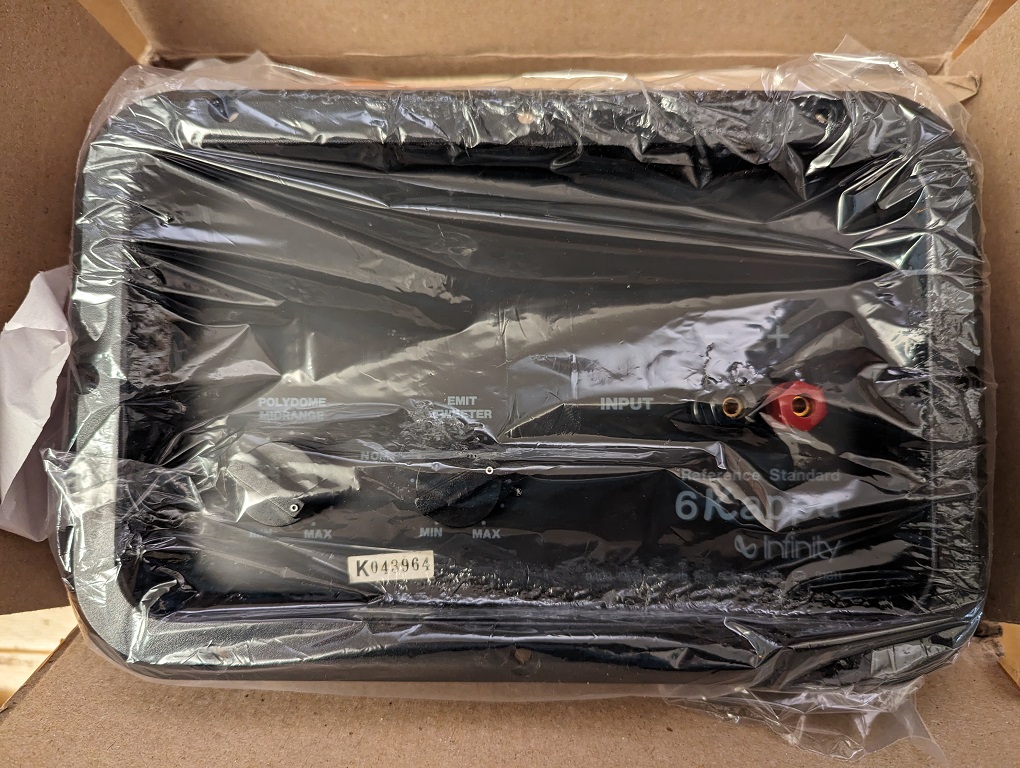

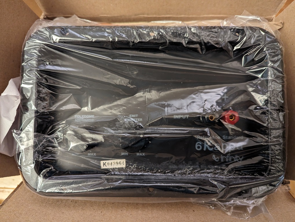

The rear plates are the same from the Kappa 6 to the Kappa 8 and they just arrived to modify with the new connectors.

PostPosted: June 13th, 2024, 10:15 pm
Posts: 928
The original crossover pc boards have been removed and ready for the new 5-way binding posts to be installed.

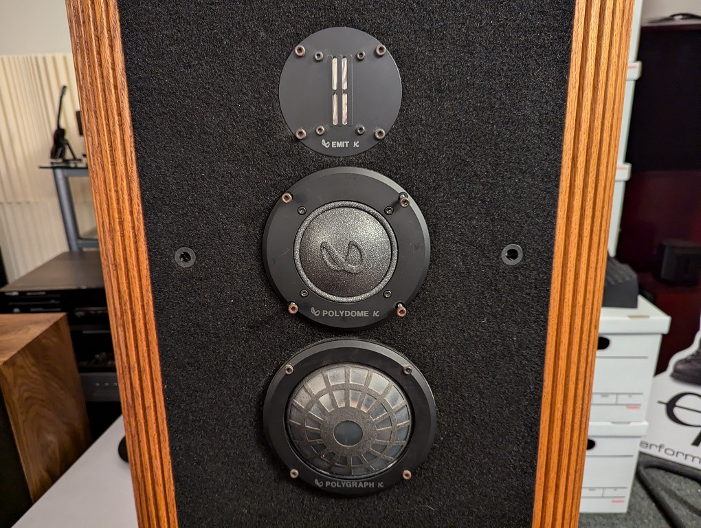

Went to install the Polydome K midranges with new wiring and behind the damping material the original wiring is glued into the cavity.
Looks like I have to put new fast on connectors on the original wiring for use with the external amps.

The Infinity Kappa 8 Polydome K repaired and being reinstalled in the baffle. Wiring reworked with the original wiring as it is glued into the sealed cavity behind the driver.
No problem as there is excess wiring for repairs to be done.
