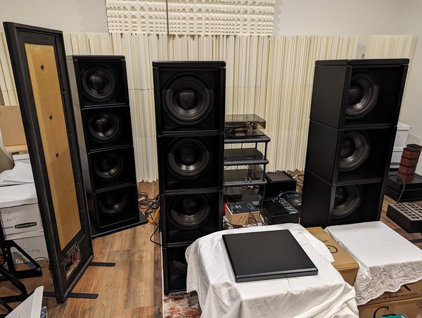

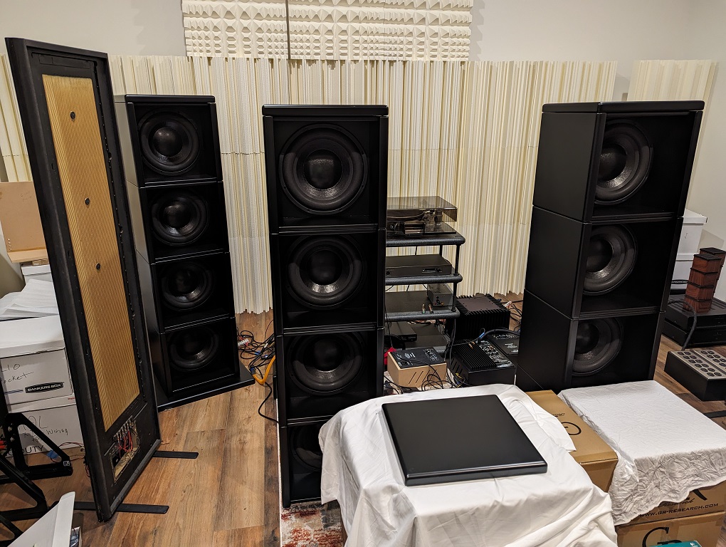

All 12 servo sub modules are complete.
Will bolt the tops, modules and bottoms together in their room locations.
Then build the wiring harnesses from the drivers to the servo amps.

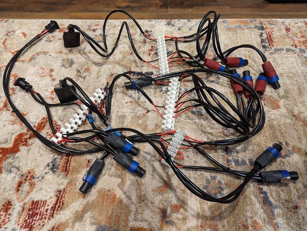

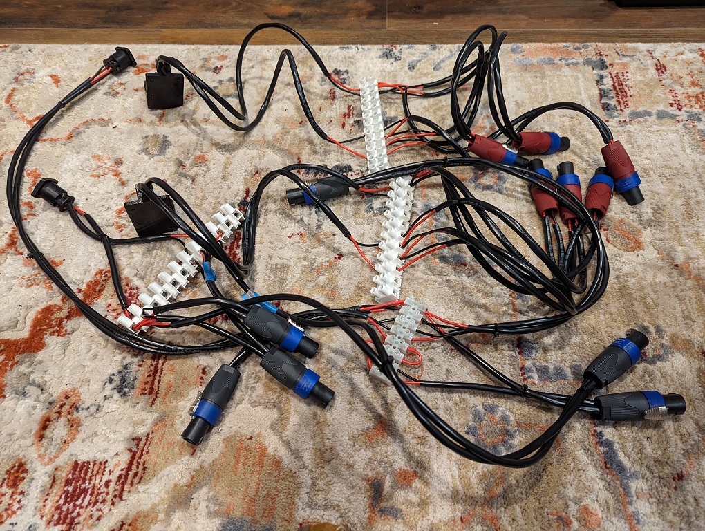

The four cable harnesses from the servo amps to the sub modules are complete.
Now time to assemble the sub towers and test the out.

Posts: 928

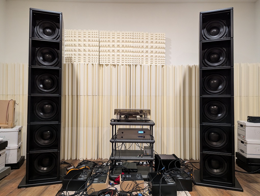

The new Monolith 6x12 servo sub towers are complete and wired to the 4-HX300-12OB servo amps.
Checked and the first 2 servo amps are up and running. Need to wire up the second pair.
So far, so good.

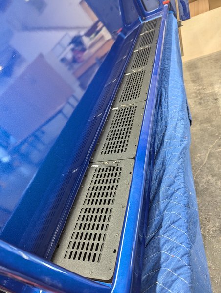

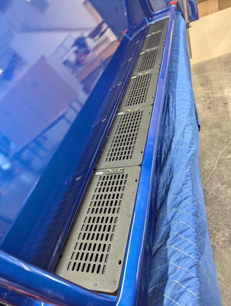

The line array baffles rework has started.
The first baffle is recut for the new planars and the second is in work.
After that some cleanup of the new longer slot and roundovers before returning for install of drivers and testing.

PostPosted: July 9th, 2024, 12:11 pm
So far, so good.
Does your Home Owner's insurance cover structural damage from internal seismic vibration? :wtf:
PostPosted: July 9th, 2024, 12:31 pm
Posts: 928
LOL!
The poured concrete slab underneath is 6in thick. The 9in block walls all around the room should be fine. :)
PostPosted: July 9th, 2024, 12:36 pm
LOL!
Why am I not surprised. :crazy:
