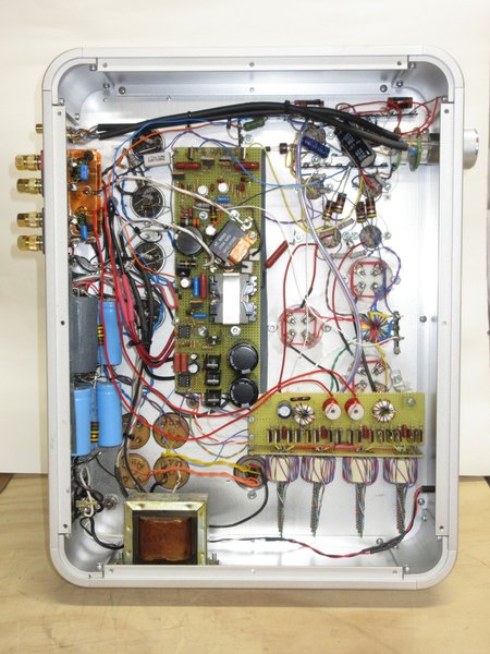

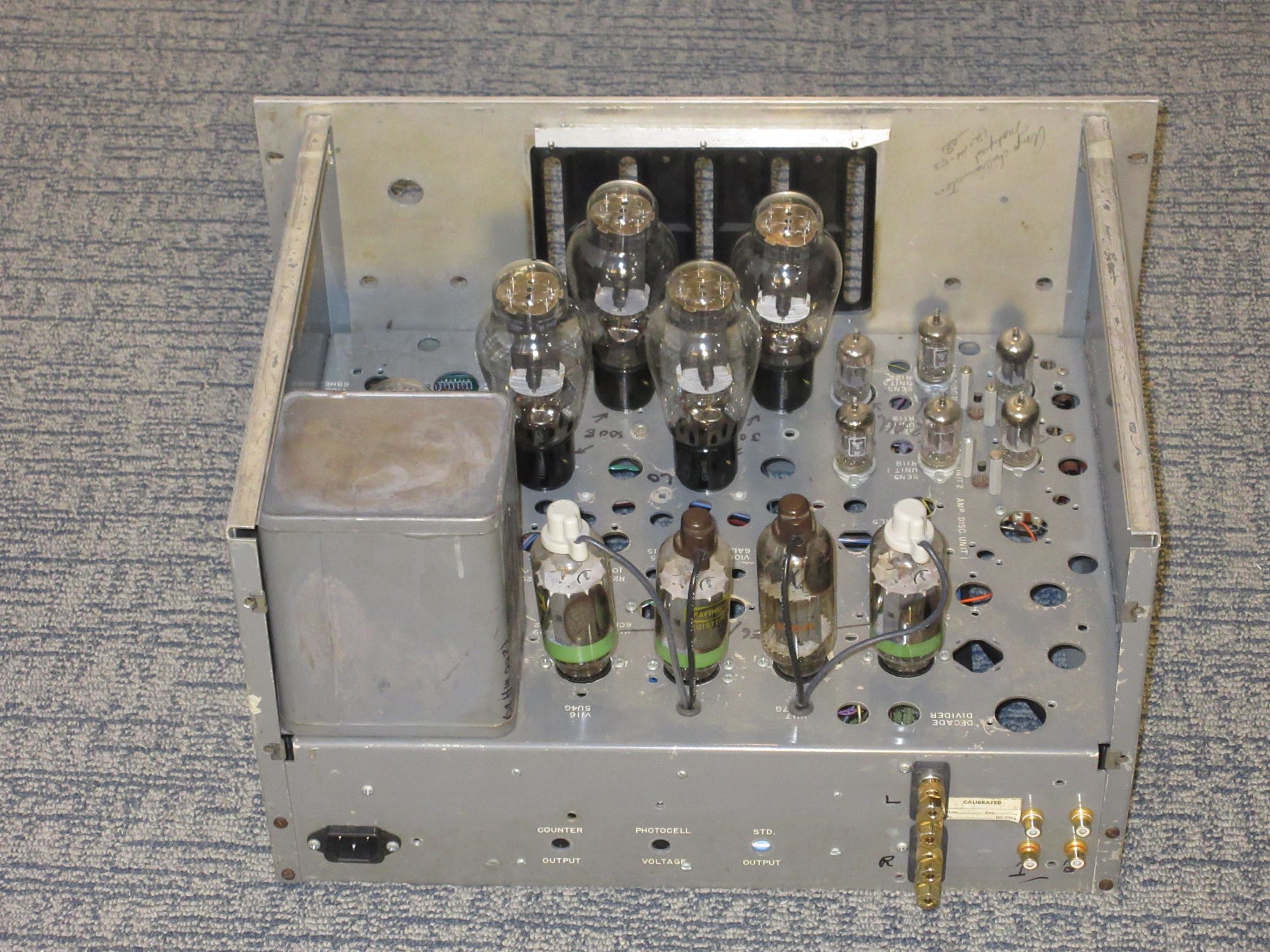

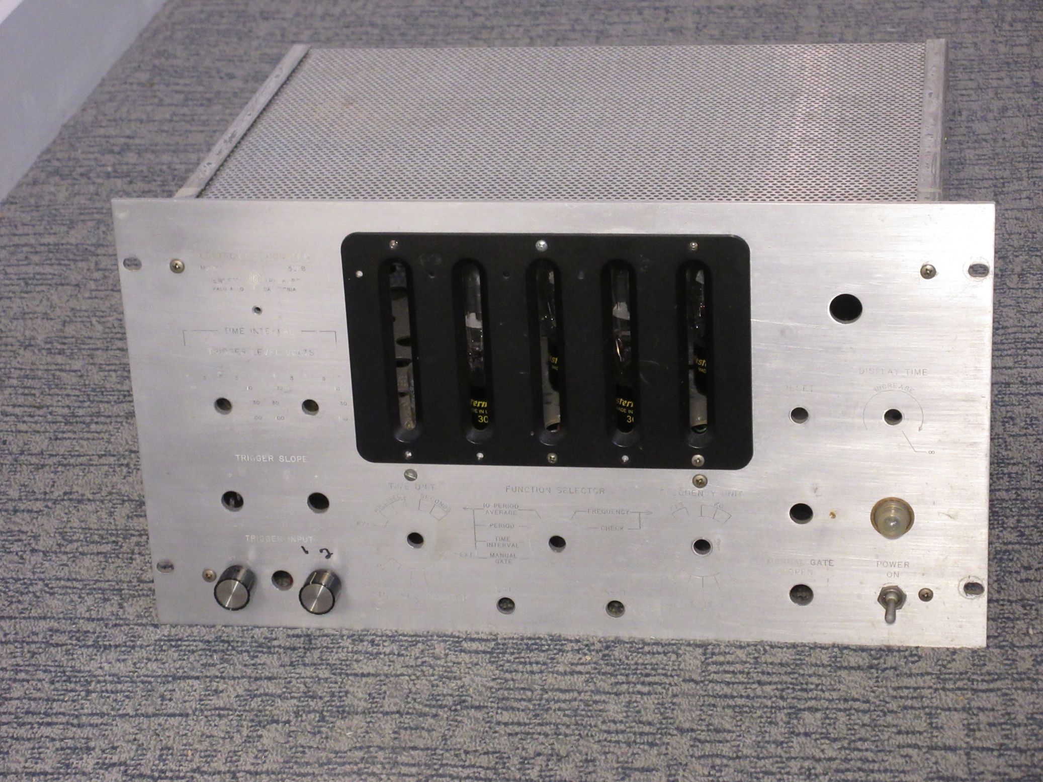

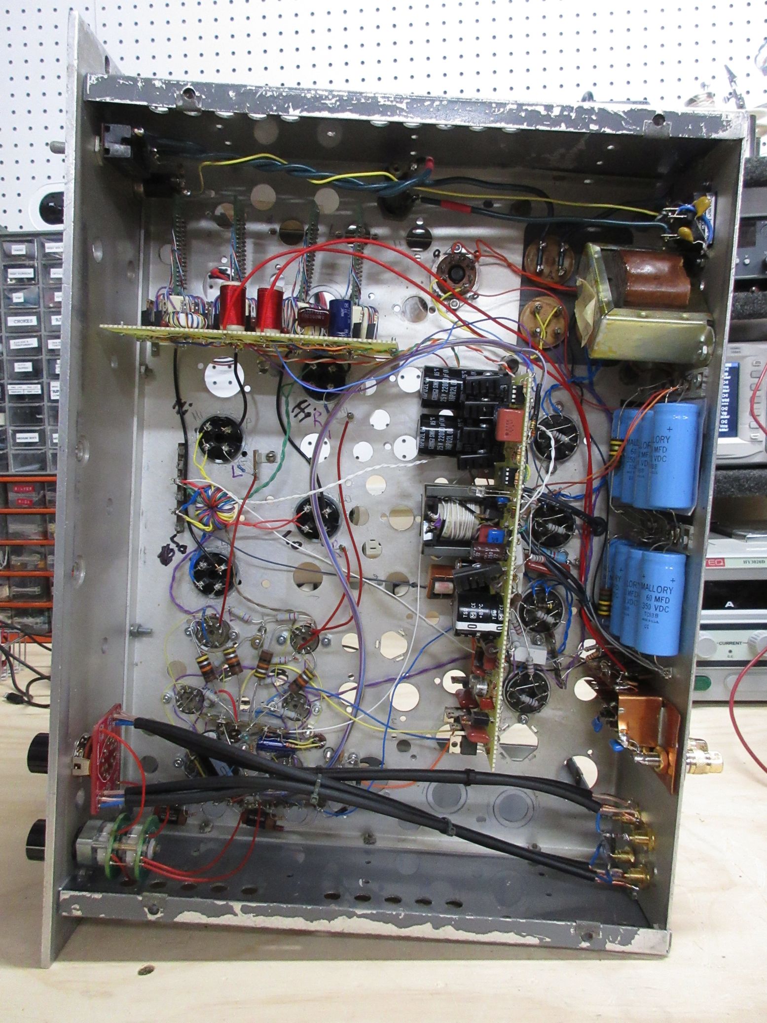

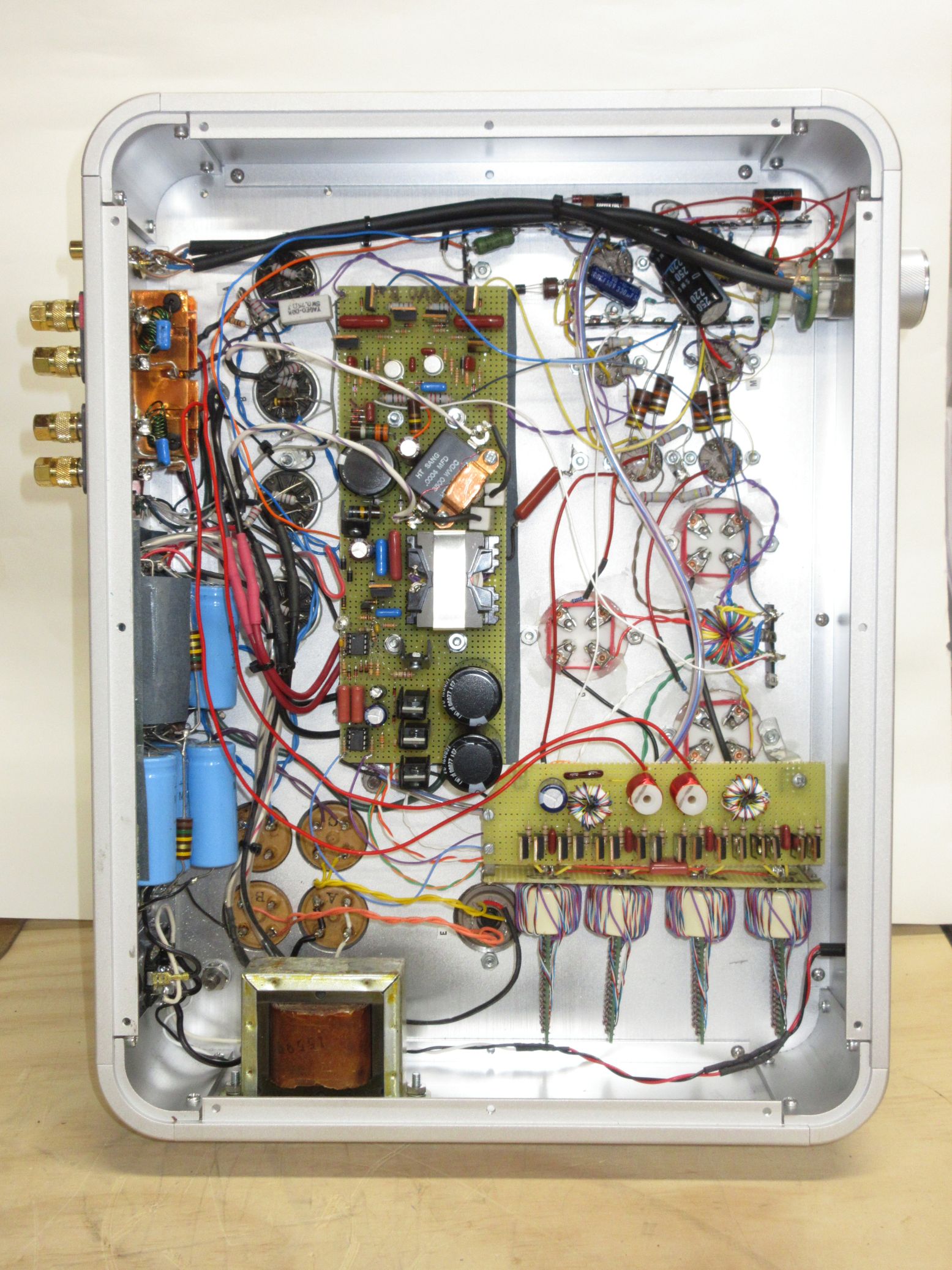

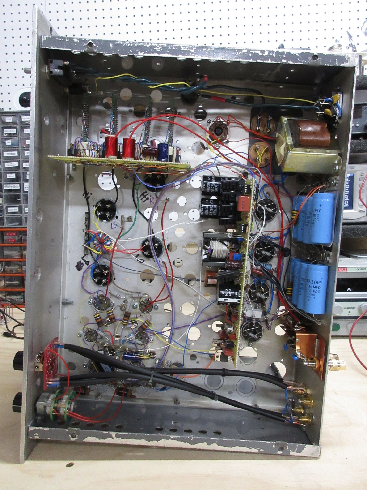

Just finished a remake of a prototype 300B amplifier built by David Berning. One of the guys in the Philadelphia group bought it and loved the sound but couldn't stand the looks any more. (it was a prototype) I rebuilt it on an other chasis. Quite a job but he loved the new look. Here are three photos of the before and in the next link I'll send three of the after's

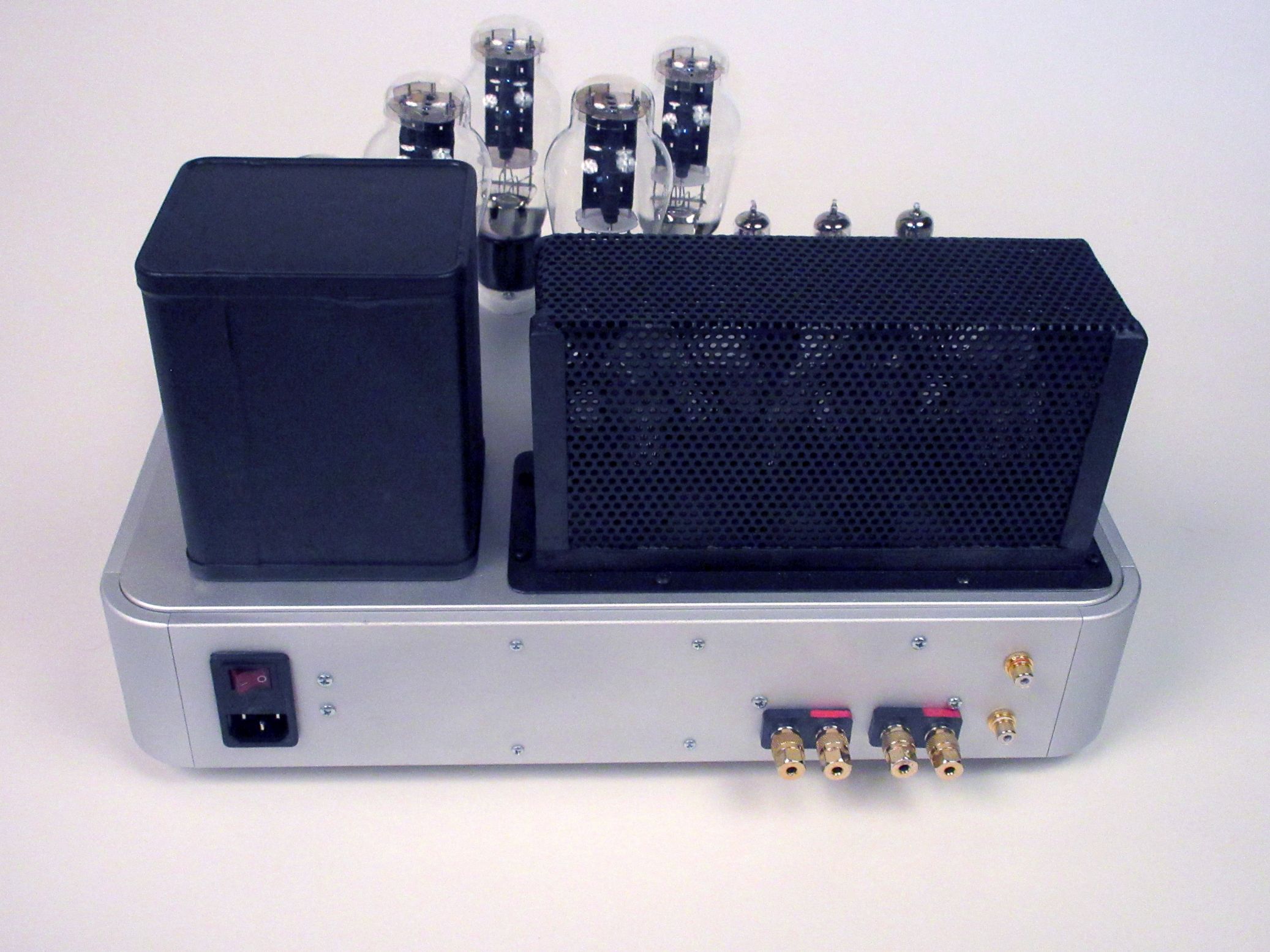

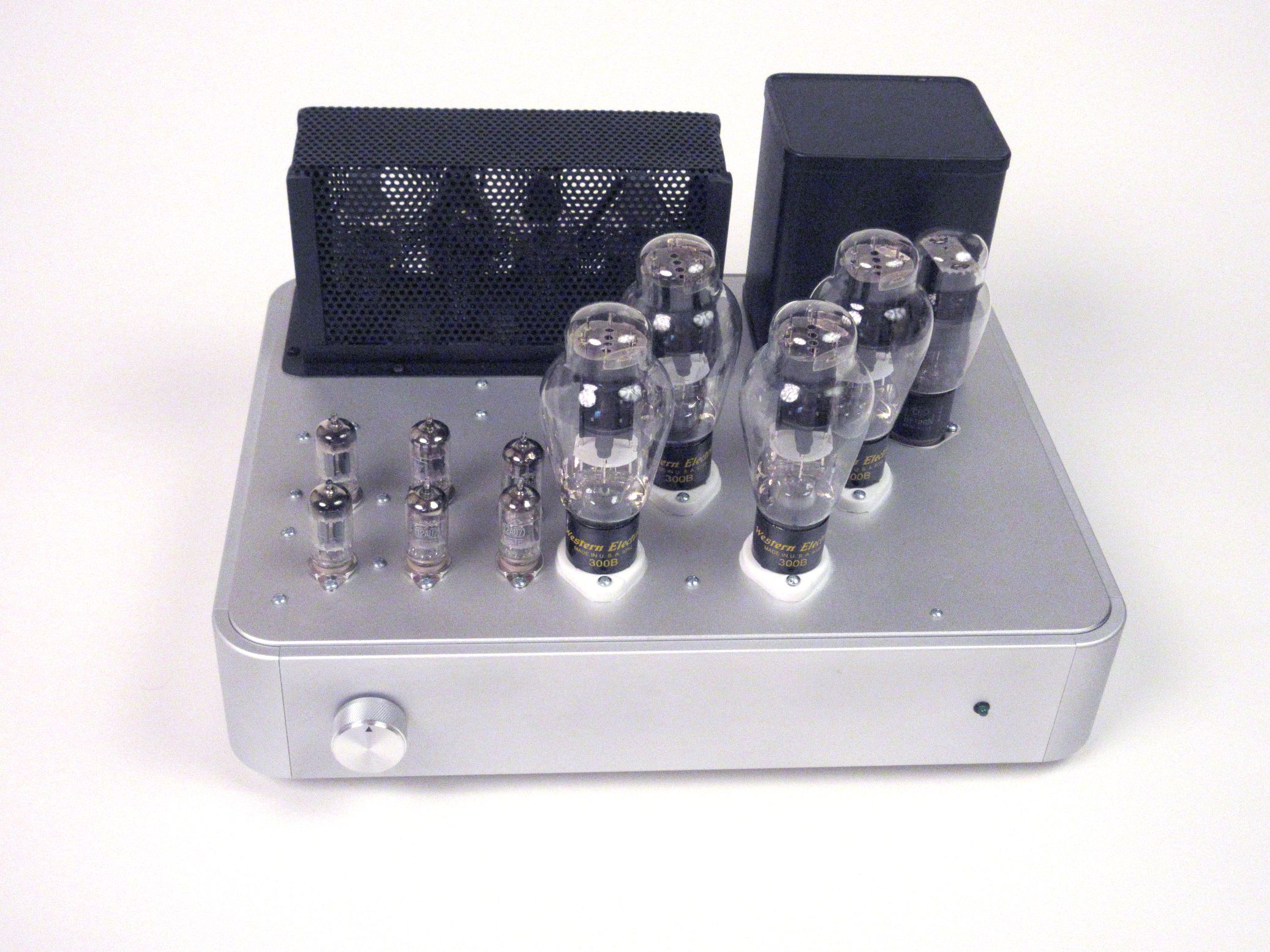

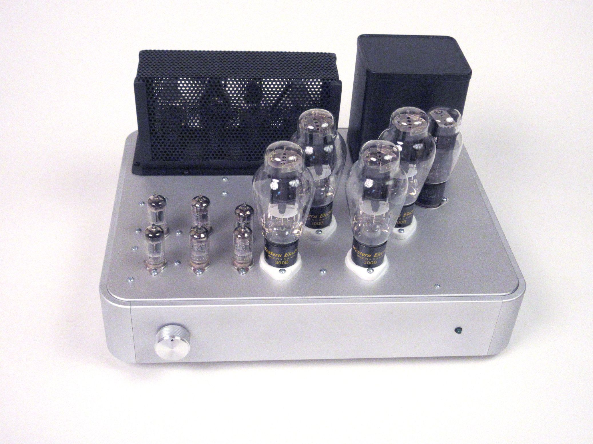

Here are the ones after the remake. I'll be writing it up for audioXpress. Definitely not a beginner's project.
My question is -- where did you get the new chassis from? And for how much?
PostPosted: November 7th, 2022, 1:07 pm
Posts: 1871
Here is a link to the chassis on ebay. Note that the freight is almost as much as the chassis. It is quite substantial which makes it strong but cutting the holes required aluminum cutting fluid for the hole saws. It was done on my drill press. I'm not sure how it would have worked if using a hand drill.
