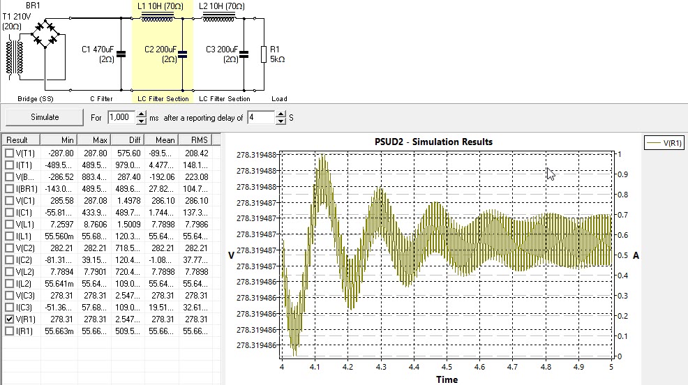

this is the first version of PS schematic for the low-mu preamp. PSUD2 is very limited in functionality. The choice of caps and inductors is strictly based on what I have available.
Todo: Add common-mode and RF noise filtration.

PSUD2 is much more capable than you give it credit. You need to feed the correct information for equivalent DC resistance of the components, and not use the default values. You also need to model the load correctly, you can use a constant current representing the operating current of the circuit, or use a resistive load as you are using that is based on the B+ voltage divided by the operating current. The actual amount of ripple you are seeing is miniscule, due to the capacitor sizes and inductors used. It is good to see the stepload response to see how much ringing you might have with the two chokes in the Pi filters, these can interact. Sometimes it is good to use two different values for chokes, or even add some resistance to the choke to dampen ringing. For a Class A circuit, it probably does not matter that much, but it is something to look at.
Yes, PSUD2 is NOT going to address common mode or RF noise filtration since this is outside the scope of the application, which is to help model and design a stable and well filtered power supply based on 60Hz/50Hz AC input. If you use the correct input information, including line voltage, component resistance, loads, etc., the modeled results are very accurate. PSUD2 is a great tool for power supply optimization.

Also use the rectifiers you intend on using where possible, since it will model the drop across them as well as give you an indication of whether you are exceeding their current capability or PIV. Also, I find that using a 1000mS window is too wide and you cannot see what is happening for all the 120Hz ripple, I like to use a 200mS window. The only case I would use a longer window is if I wanted to see turn on behavior to see if the voltage spikes up excessively and how long does it take for the power supply to charge up.
It is a very useful tool.

In the meantime, this is what your initial version looks like.
Changing the load resistor R1 to a constant current of 30 ma (15 ma per channel) and setting a stepped load. The stepped load facility is more useful in higher current applications.
Your chokes are too large as well as your input capacitors. Using a $20 Hammond 155H ( 5H @ 50 ma) and just a 10 uf input cap, you get the following if you use 30 ma current (15 ma per channel).
And here is your ripple which should be fine.
PSUD is a wonderful tool.

That was a great little demonstration for Shashi on using PSUD2. Since this is for preamp use, I would tend to add another RC after the last, maybe accept a 5 to 10V drop into a large capacitor but get better filtering. Or use the current filter as input into a regulator.
