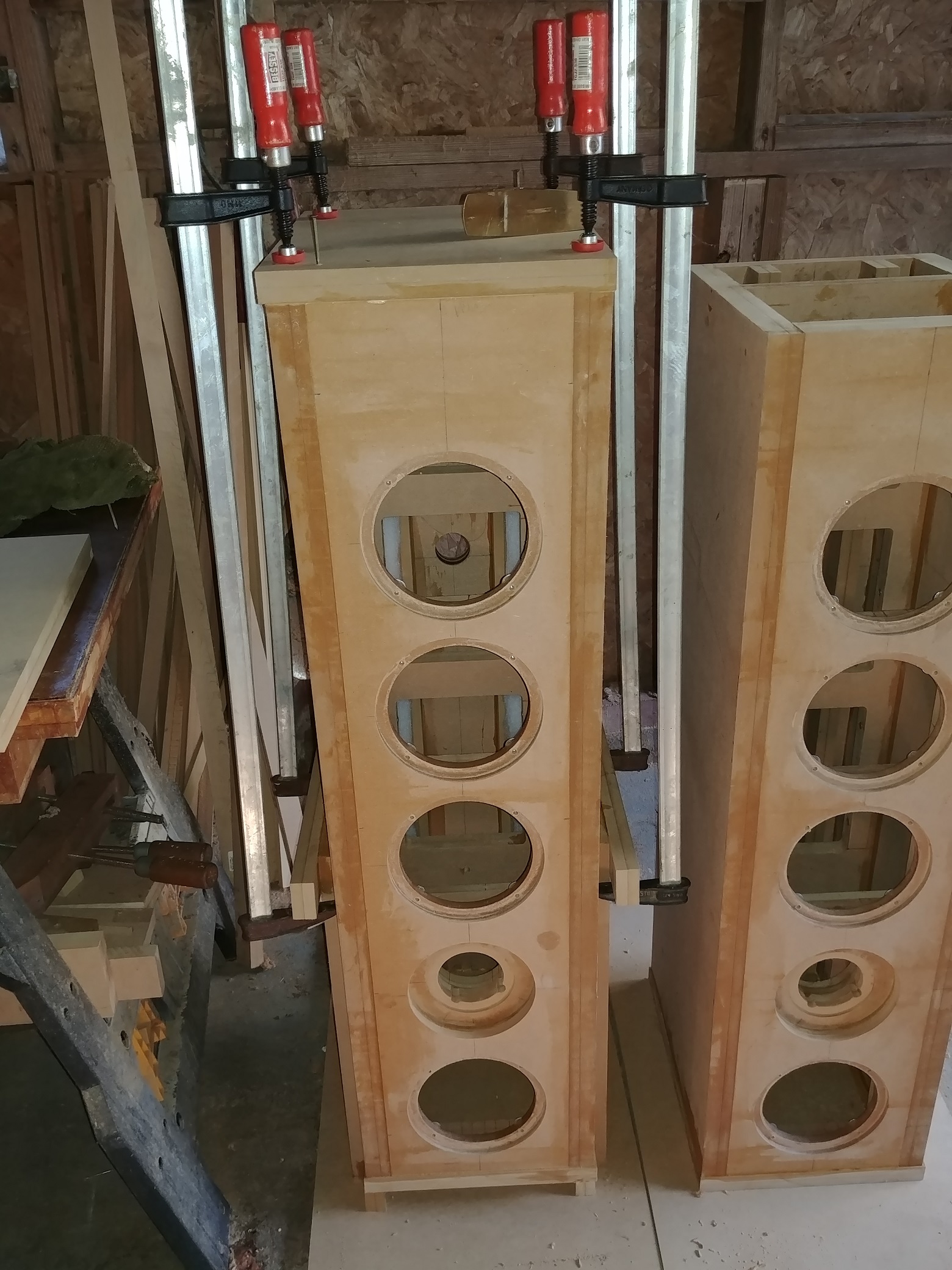

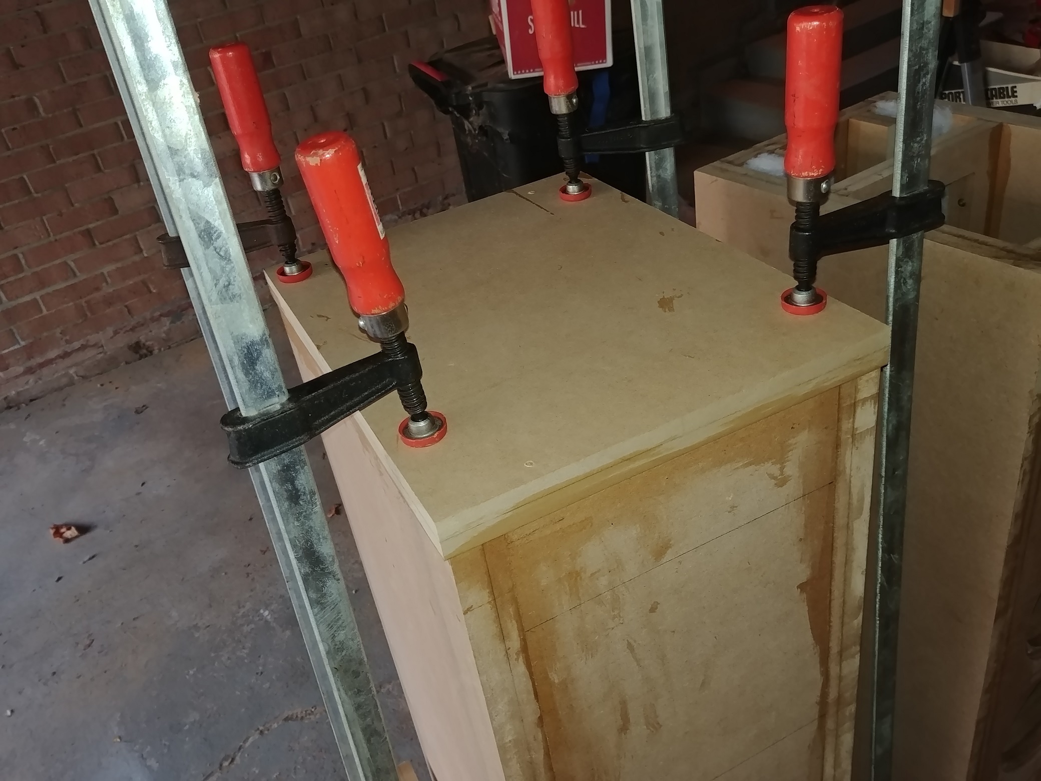

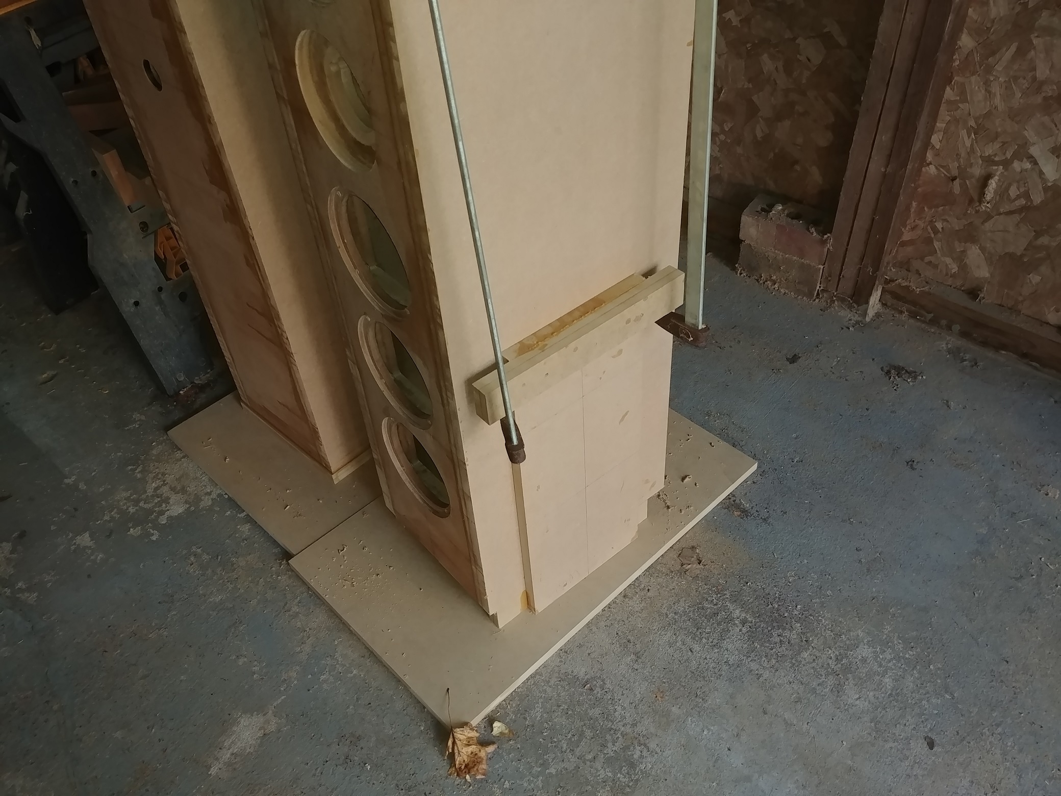

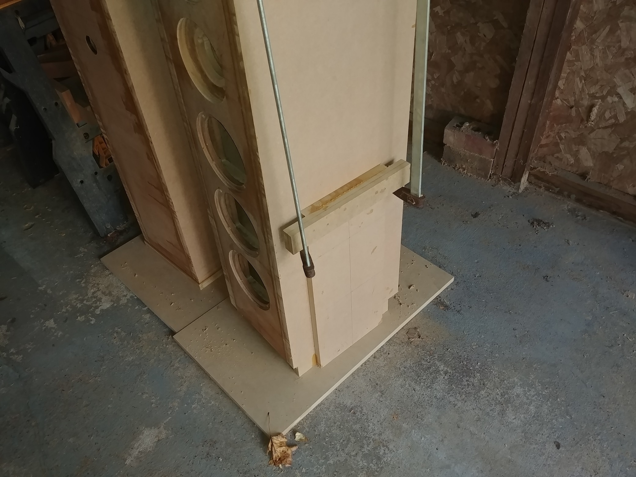

Nails as registration pins worked great. The pictures show the clamp extenders I made for gluing the top and bottom on the enclosures. Worked like a charm.
Looks like this weekend I start patching, sanding, and sealing the cabinets.

Very cool idea with the clamp extenders. Another one of the many fixtures you need to build with a complicated project. Glad the nails worked.

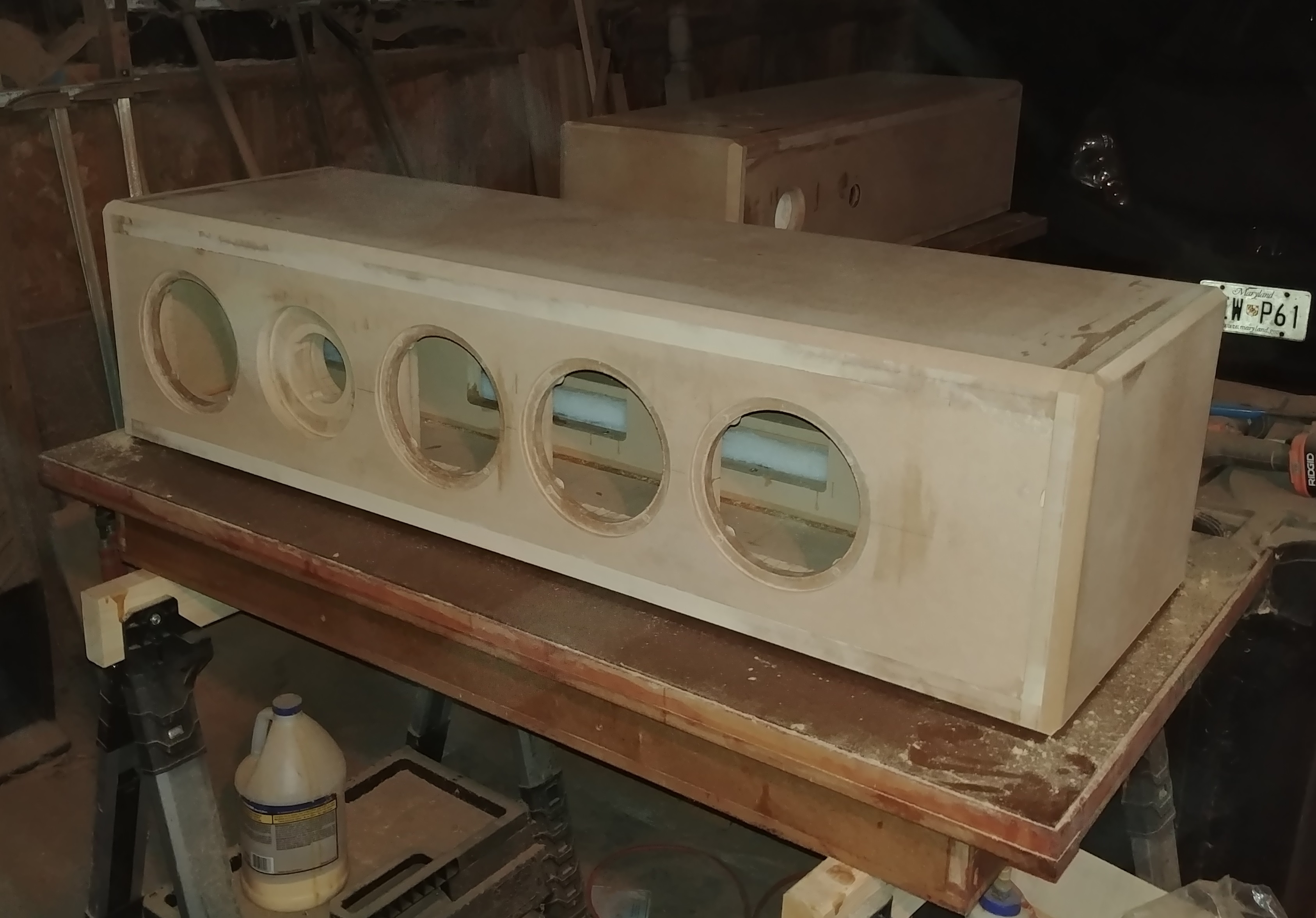

Router Fun!
I patched and routed out the edges of the cabinets over the weekend. For patching I used Bondo wood filler. The pot time on this is a few minutes, had to mix up a couple of batches just to do the face of one speaker cabinet. However, it sanded down nicely and really holds a good edge, better than any other wood filler I have used. For routing, I used a 30 degree bevel bit on the front (and back) baffle, and 45 degree on the top and bottom edges. Need to do some hand work to cut faceted corners. Should start final filling and sealing of the raw MDF edges later in the week.

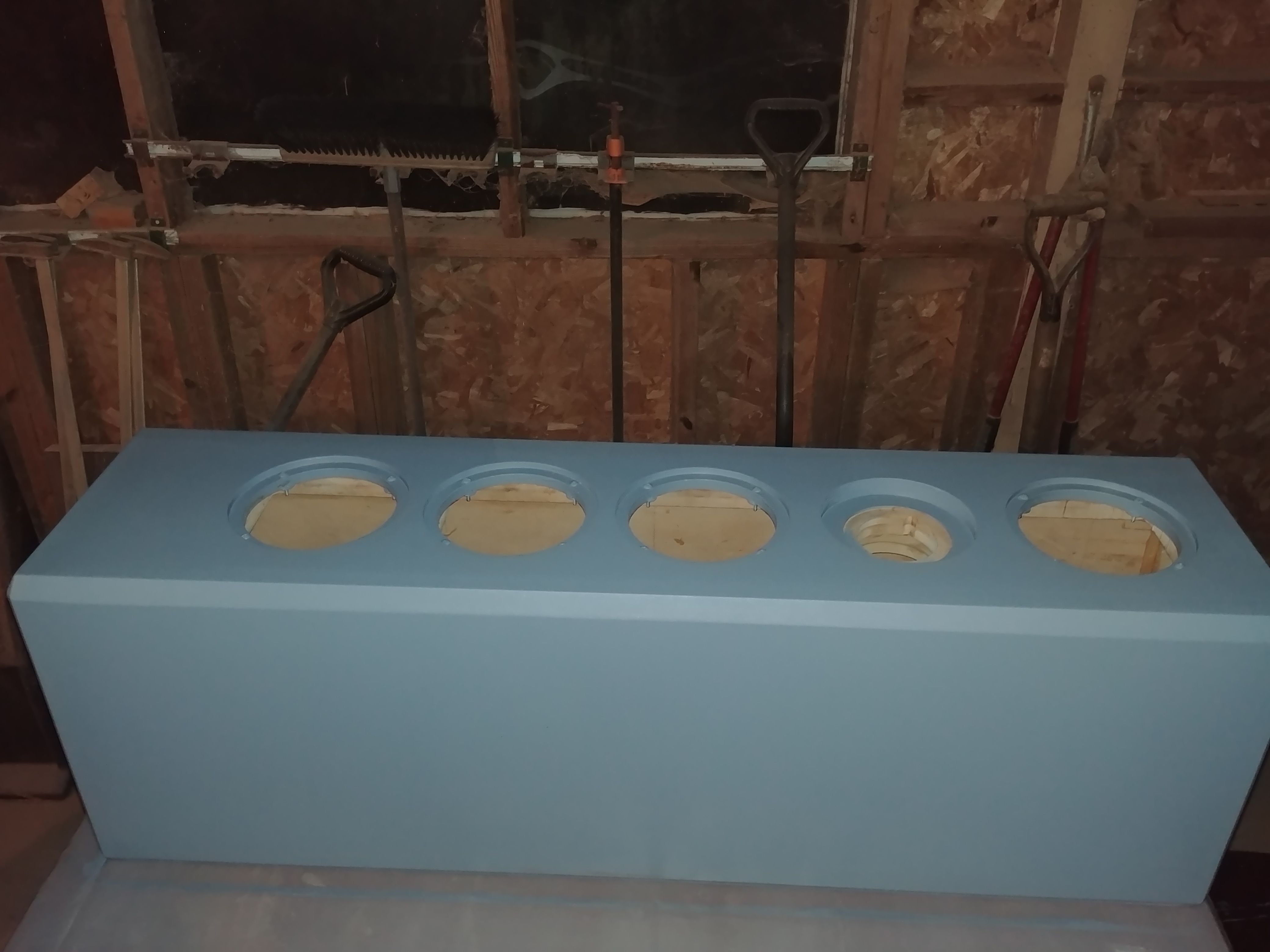

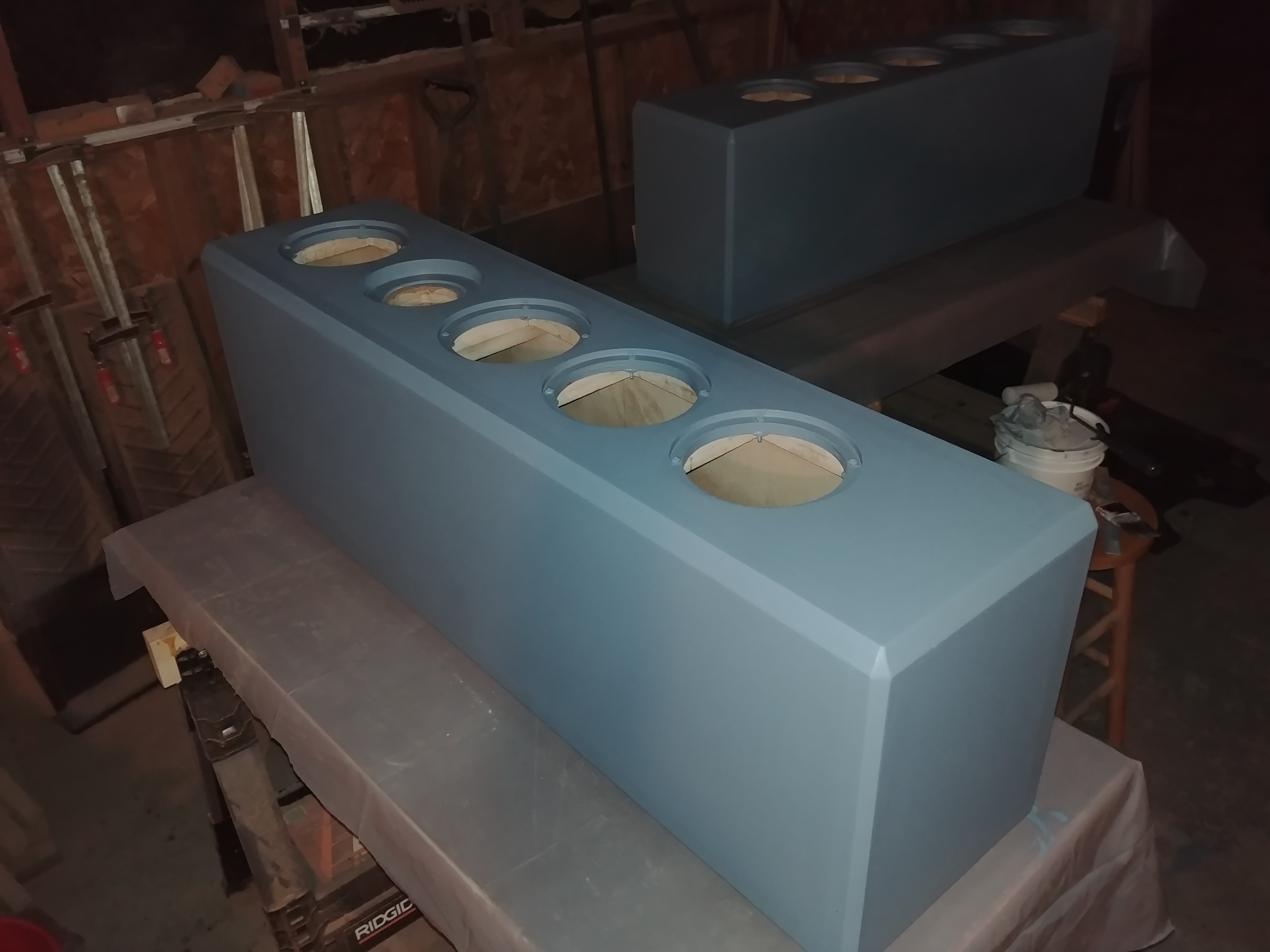

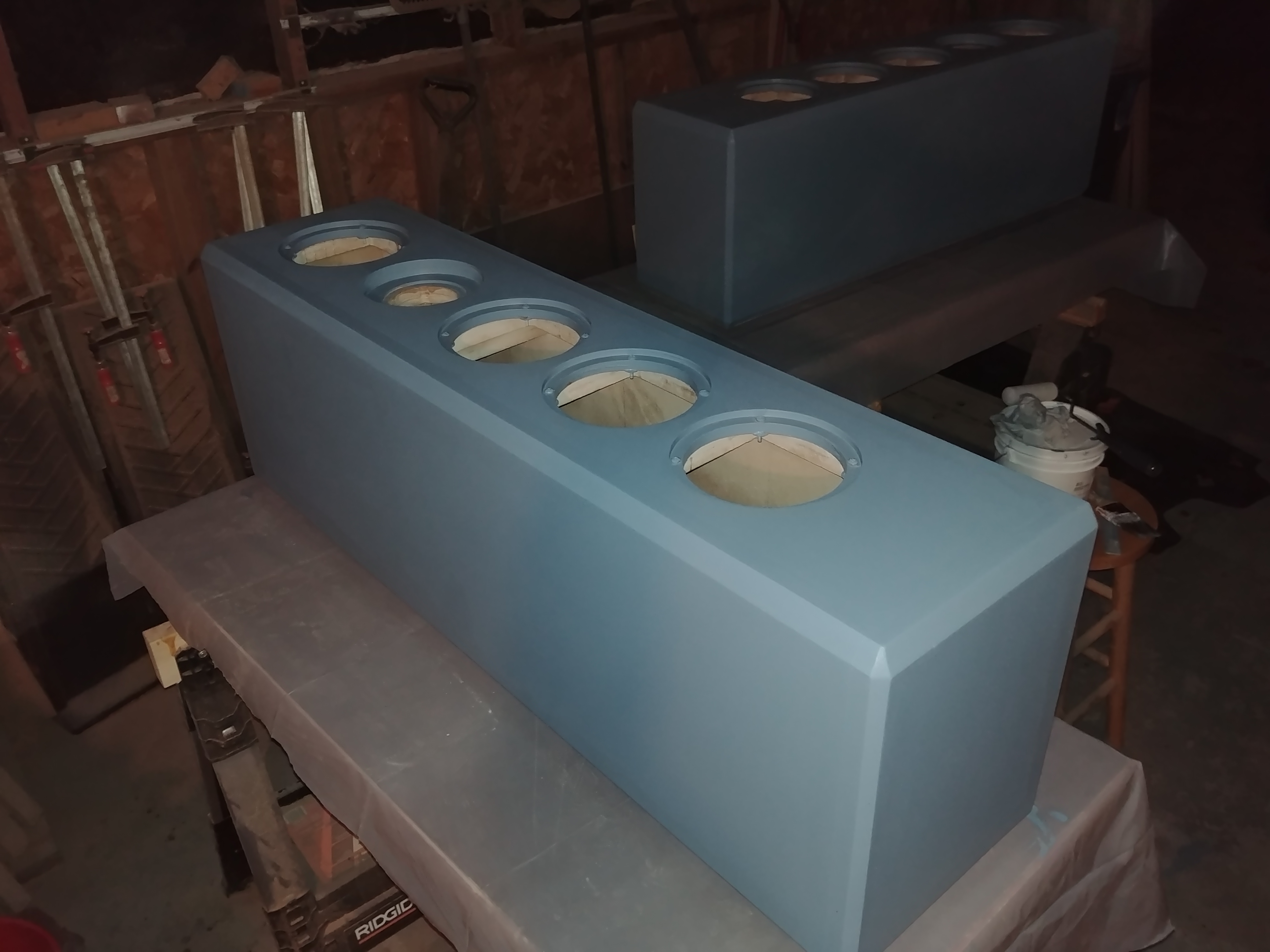

I took the day after my birthday (Wednesday) off to work on the speakers (being stuck in a 6-1/2 hour meeting on my birthday was no way to enjoy it). So I patched, sanded and finally applied shellac as a sealant on the raw MDF. Used wax-free clear shellac (Zinsser Seal-Coat). The MDF really soaked up the shellac, I went through a quart of the stuff, with two coats on each of the MDF edges and a single coat on the flat surfaces. I could have used another quart, I think. After it dried, I sanded the surfaces down with a 180 grit sanding disc, and they turned out pretty smooth.
I decided to use Duratex to paint the cabinets, based on my satisfactory experience with it on a another project. It drys and cures super hard, and tends to cover-up minor surface imperfections. I like using a fine foam roller to apply to get a relatively smooth (matte) surface rather than the highly textured surface used on road cabinets. I bought a gallon of white spray grade (based on reports of it being easier to apply with a smooth foam roller) and tinted it to a blue-grey color using concentrated Cal-Tint lamp black and blue liquid tints that I picked up on Amazon (I have lots left if anyone wants to experiment). I just added equal amounts of the black and blue tints to get the desired color. After thoroughly mixing with a drill powered impeller (trying to avoid splattering the paint all over), I let it sit a day. Last night I painted the first coat on all but the back surface of the speakers. Really easy to get a smooth (fine textured) surface with no overlap marks. This is the initial coat, which will probably be sanded down before applying the next coat.
