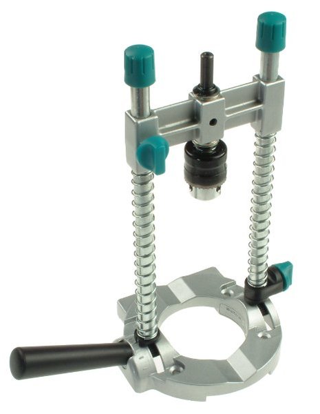

Going to give this a try.

I have used that tool before which will help keep the holes perpendicular but a hole jig will make precise positioning easier. I would make the jig the size of the driver with small holes to just start the main holes. I would then mount one driver and use the jig to make the next set of pilot holes. If you place the next driver against the first and the pilot holes line up you are good to go. I would drill and mount only one at a time because small errors can grow when you have so many drivers to mount.

I have placed all 8 drivers on the baffle end-to-end and will mark all the hole positions. Once those are done, remove the drivers, nail set the start hole in the center of each before drilling to guide the bit. After that, use the drill adaptor to do the holes. The planar is it's own jig in this case.

Probably too late to chime in, but Tom is right concerning using a template. I know from experience that using a hand punch on wood will result in some mispositioning, since the punch will follow the grain of the wood (as will the drill). Depending on your tolerances, you may find holes not lining up with the driver. I would fabricate a template the same external dimension as the driver from some aluminum or brass plate or even 1/4 thick hardwood and carefully mark (or precisely layout based on the technical drawing) and drill out the holes to the driver. Then mark the driver positions on the baffle, position template, and drill out the holes using the template as a guide. You will get much less drift since the drill bit will be supported at the hole rather that at the chuck of the drill. It is time well spent, and will save time in the end.
