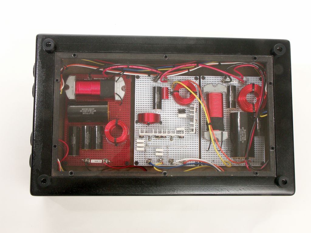

Agree on the external crossover. That is what I did for the eggs and it helped through the four sets of changes I had to make to get to the final version. Some people would not like the external version and you have to make two additional enclosures with extra connectors although not necessarily with the acrylic bottom that I did for display at shows.

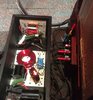

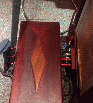

This is the external xover for the Maggy 3a's
