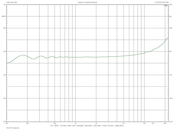

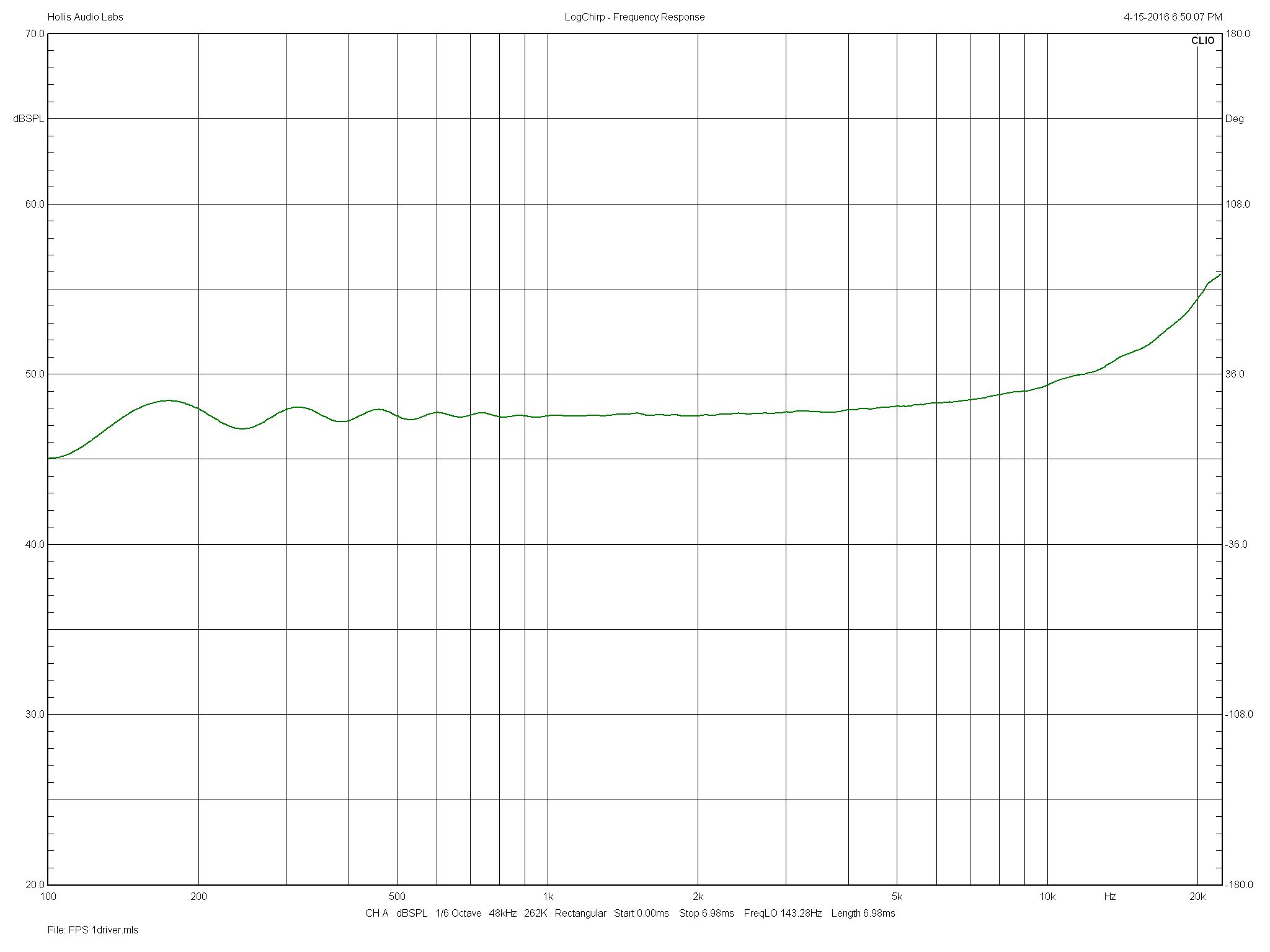

PostPosted: April 15th, 2016, 2:47 pm
See if it goes away with one. It may be comb filtering off the adjacent ends.
PostPosted: April 15th, 2016, 2:50 pm
Posts: 943
Ok, will get another measurement of a single. Just have to disconnect the speaker cable from one driver.
PostPosted: April 15th, 2016, 7:09 pm
Posts: 943
Here is a single FPS driver in the open baffle. The one above center for reference. The comb filtering is not as pronounced, but there. Time gate is 5.4mSec, so below 188Hz it will have artifacts in the measurement.

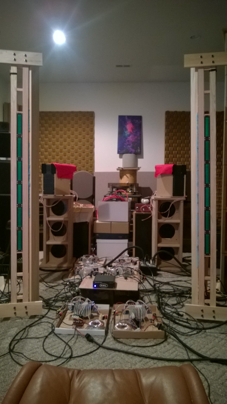

Almost done. Just some wiring left, but that has to wait for a week. It's beer time!

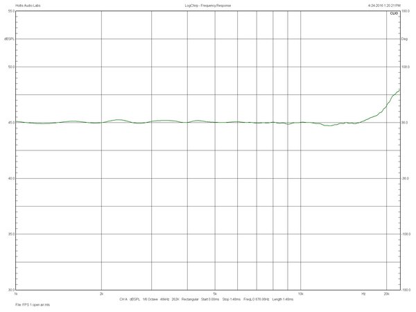

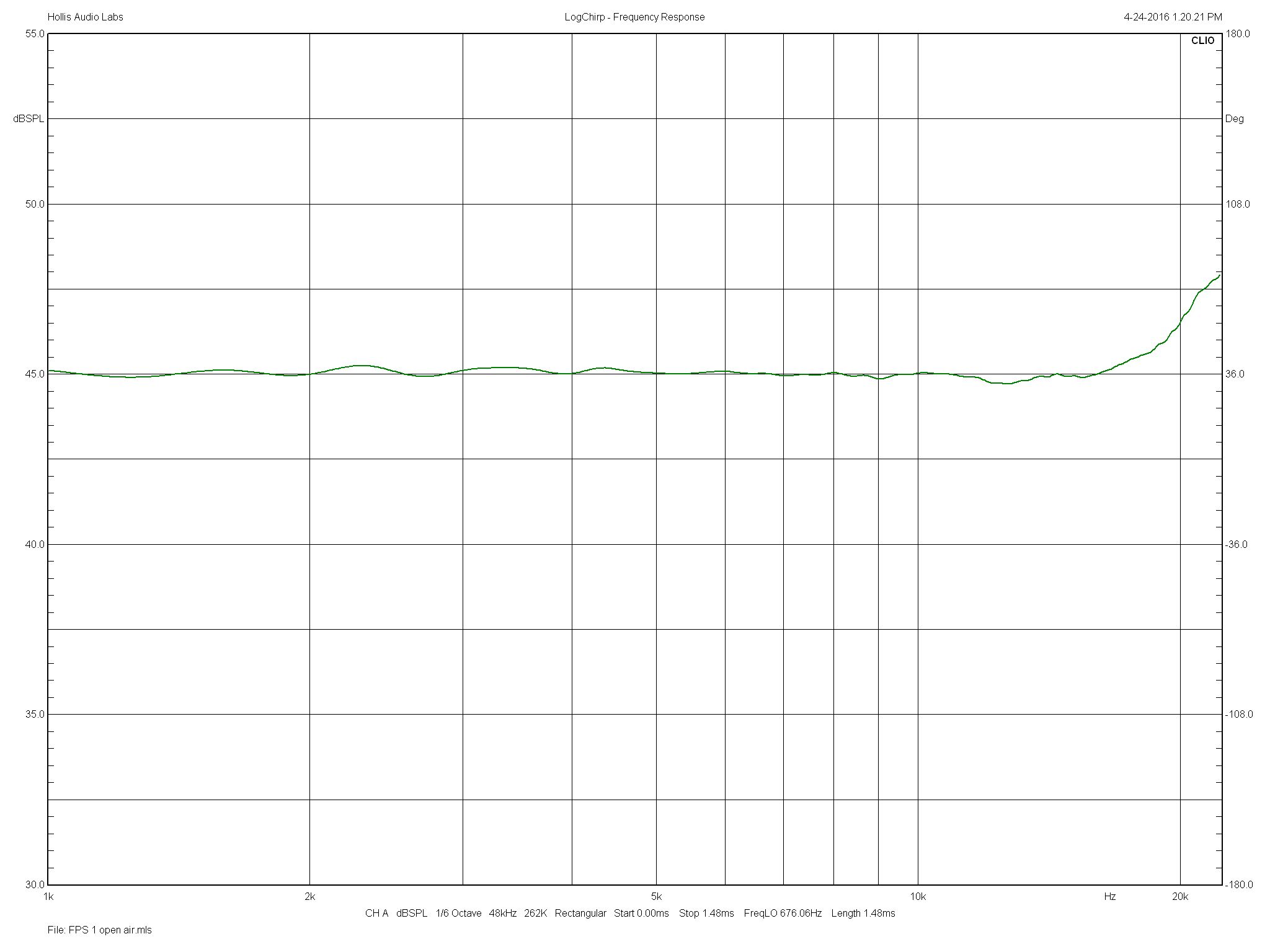

Posts: 943
The frequency response plot for one FPS planar in open air. This is in a different spot and had a reflection at 1.4mS, so cut the frequency response at 1KHz. Still see some ripple in the response, so some of it is from the planar itself and the rest from the baffle.

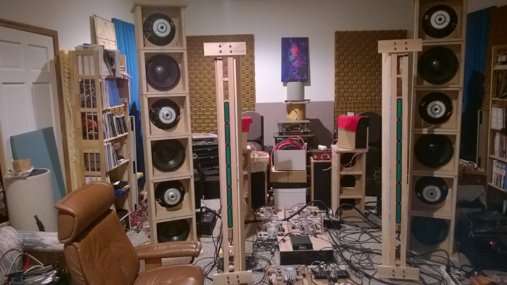

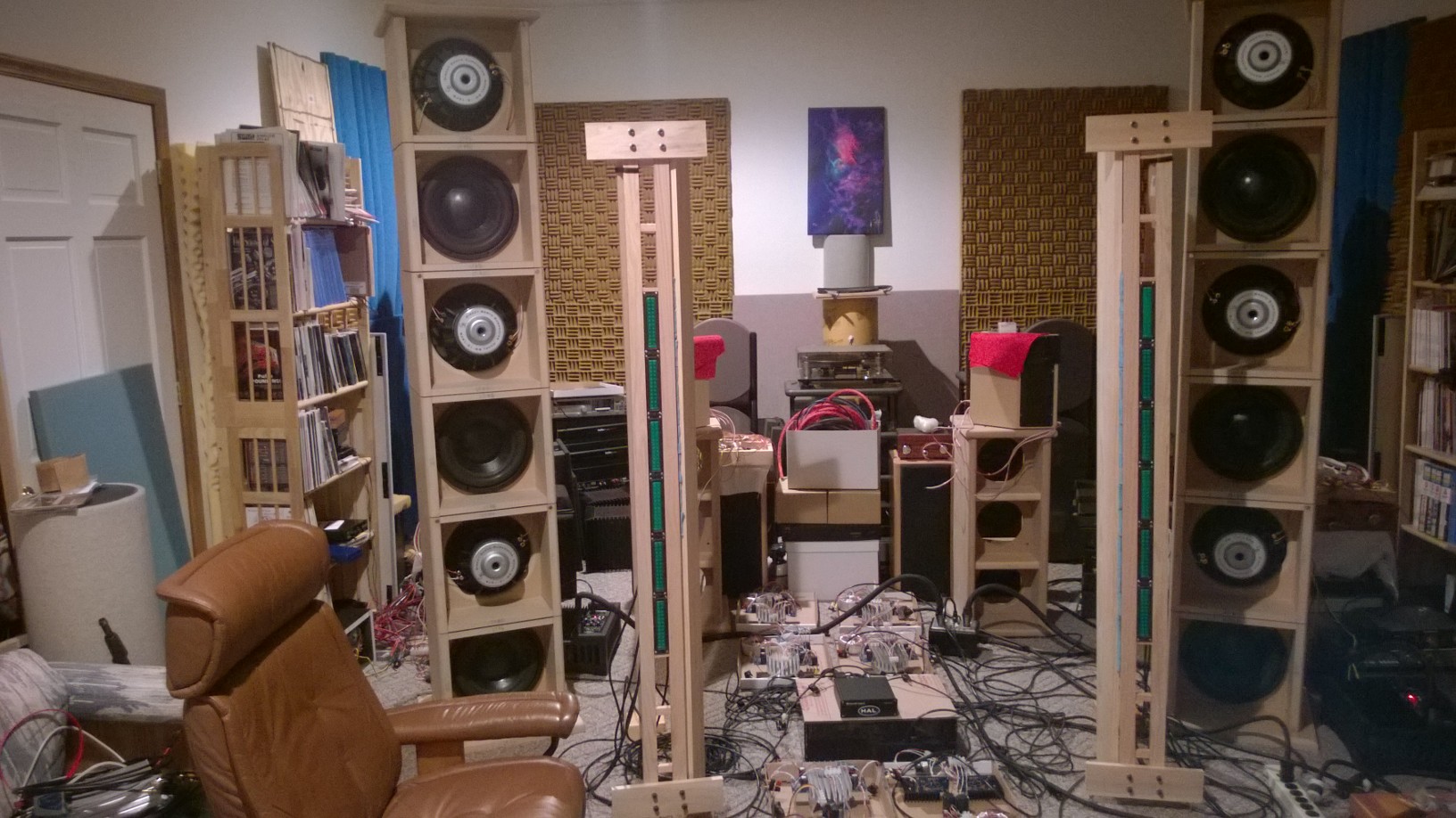

First test of 8 channels of amps running 8 of the FPS planars with the servo subs.
They are making music. https://youtu.be/gVYR0-6X_uE
Next is adding the last 4 amps and FPS drivers.
PostPosted: April 24th, 2016, 11:57 pm
Posts: 943
Second test all 12 amp channels and 12 FPS planars are running and making music.
Tomorrow is seeing how the setup measures with the servo subs.
