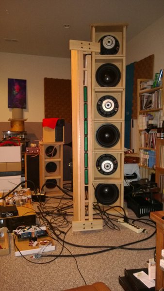

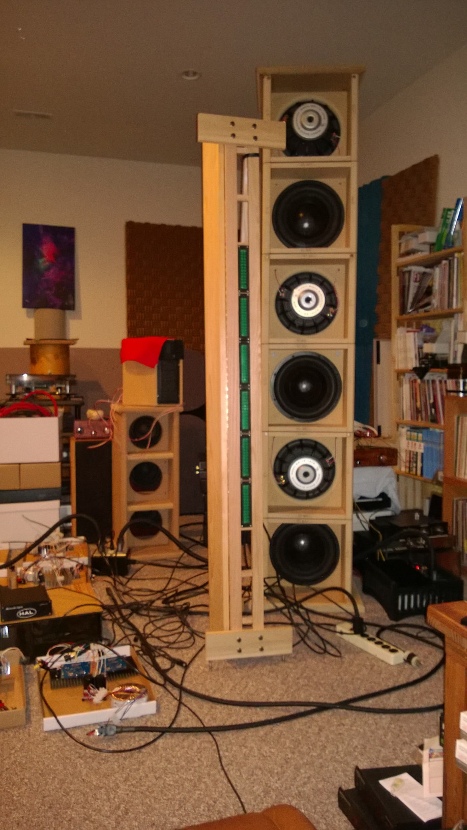

Second baffle complete and #4 screws arrived.
Now waiting for the second batch of correct drivers from PE. No tracking info yet.
Will be testing the first one soon.

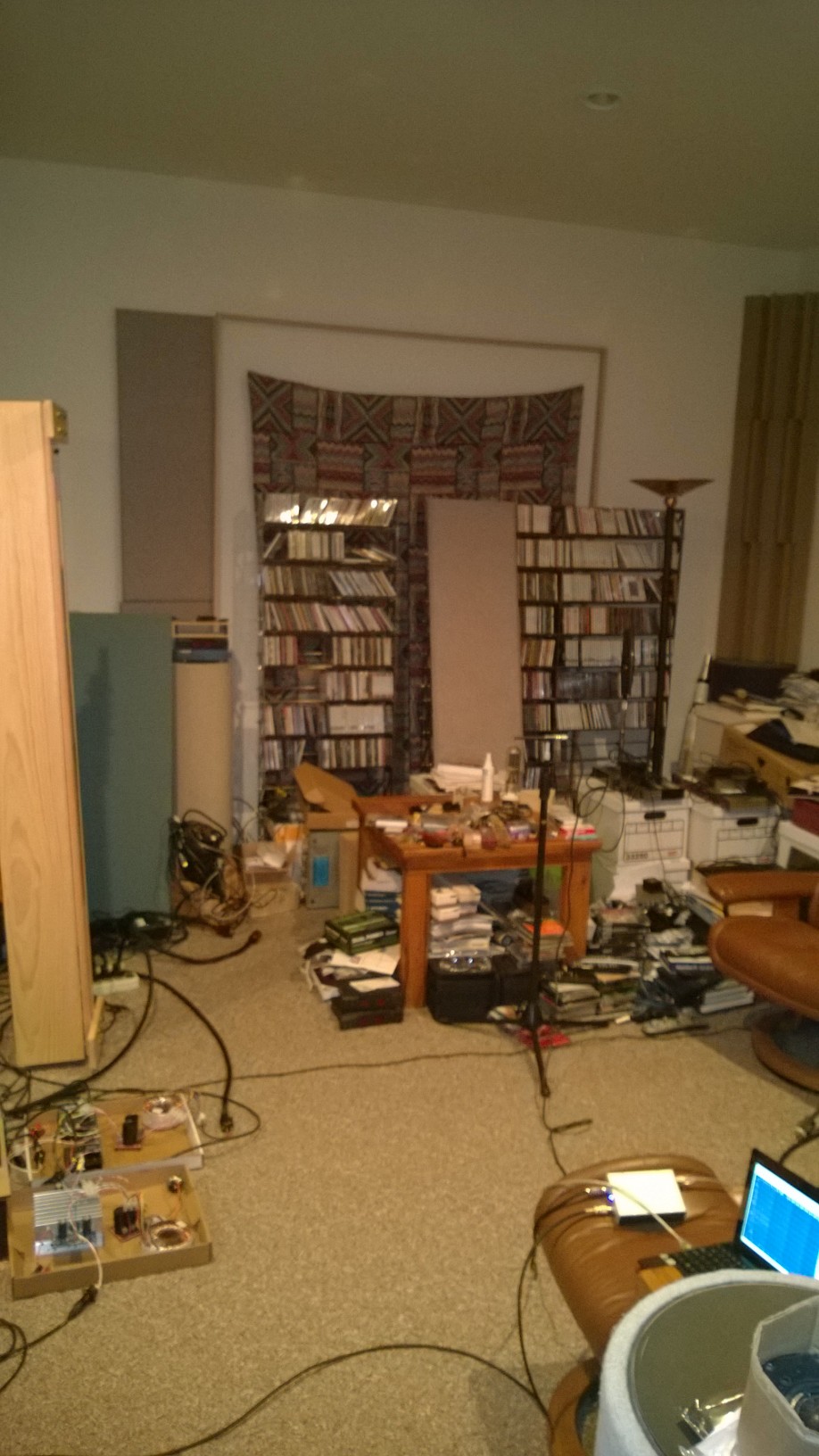

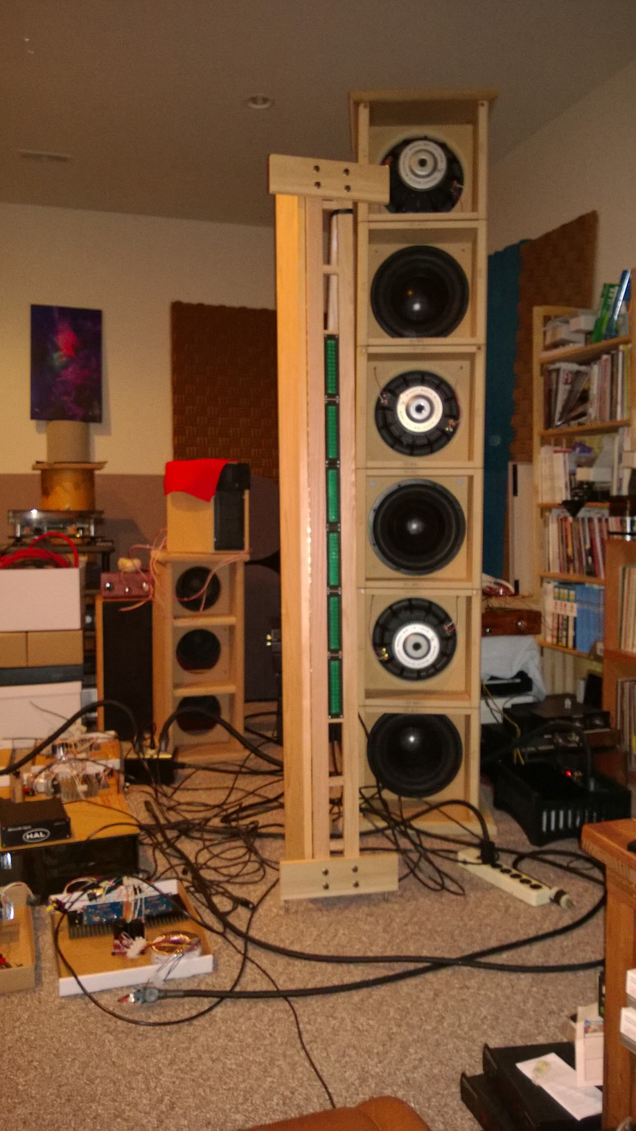

First line array is completed and ready for response measurements. Will setup Pocket CLIO tomorrow into the dspMusik digital crossover for the testing.

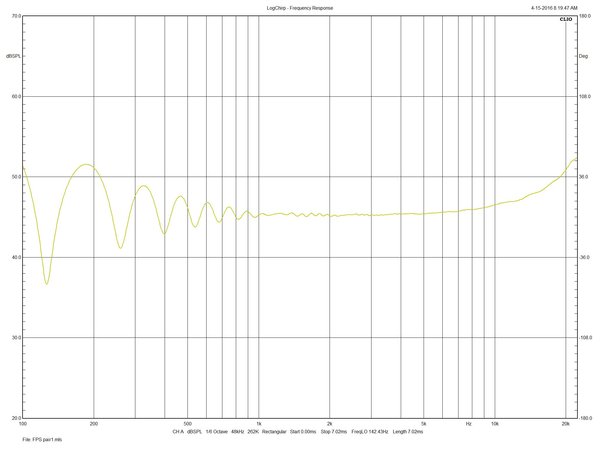

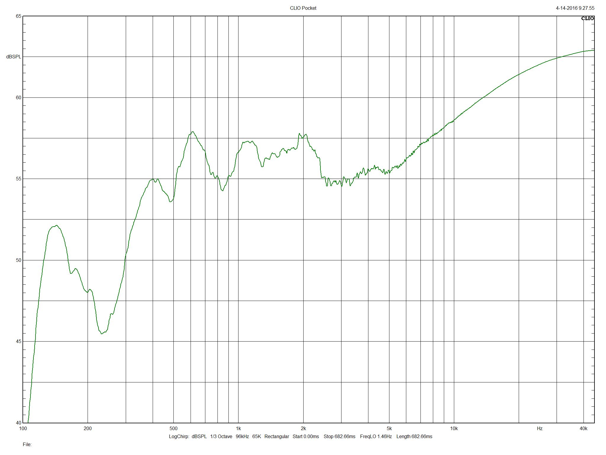

Posts: 943
First CLIO Pocket measurement of the FPS array without the servo subs. With some simple shelving filters should be able to flatten out the HF response of the array.

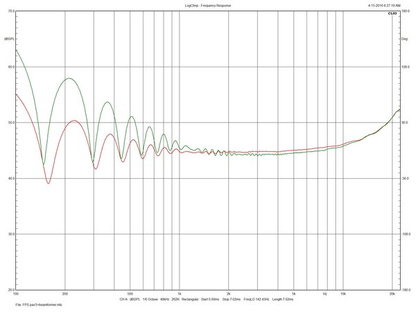

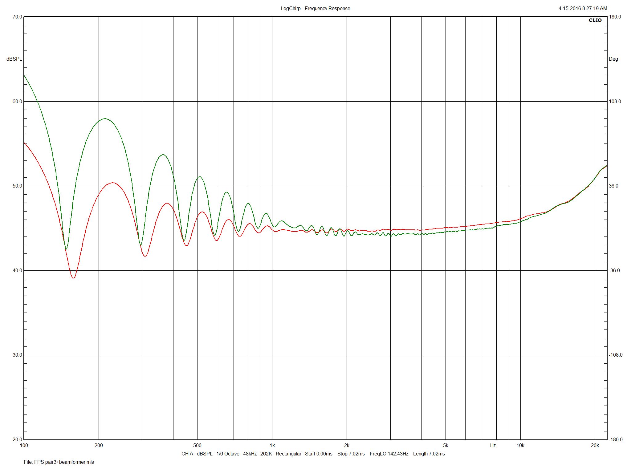

Figured out the MIC-02 cable was not working correctly, so switched over to a new mic cable and my CLIO Standard 8.5 system for measurements. Now it's better!
Here is a comparison of the FPS line array with the beamformer. The red plot is the beamformer off and the green plot is with the beamformer on. About 5dB of gain at the low end with the beamformer running. I did not select FPS drivers for sensitivity matching, so that might make it a little better.
Net step is to try some absorption material on the baffle to see if the surface reflections can be tamed. Felt or foam has worked well in the past, so will try some and see what happens.

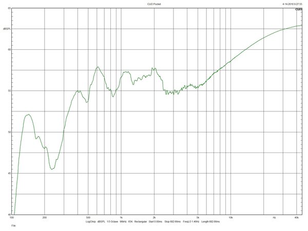

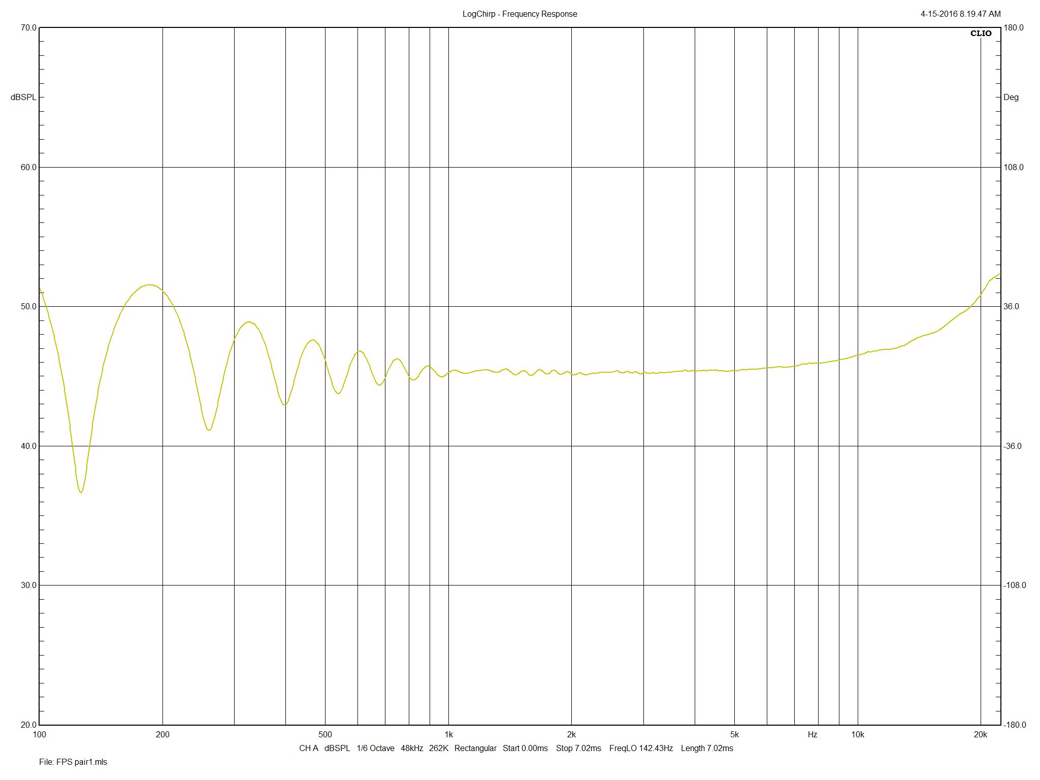

Posts: 943
Did not do a single driver, but here is the center pair of drivers. No time delay difference between them, just direct drive from the HP filter. Looks very similar, just lower in level in the LF end.
