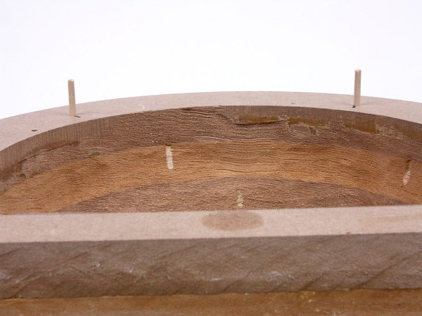

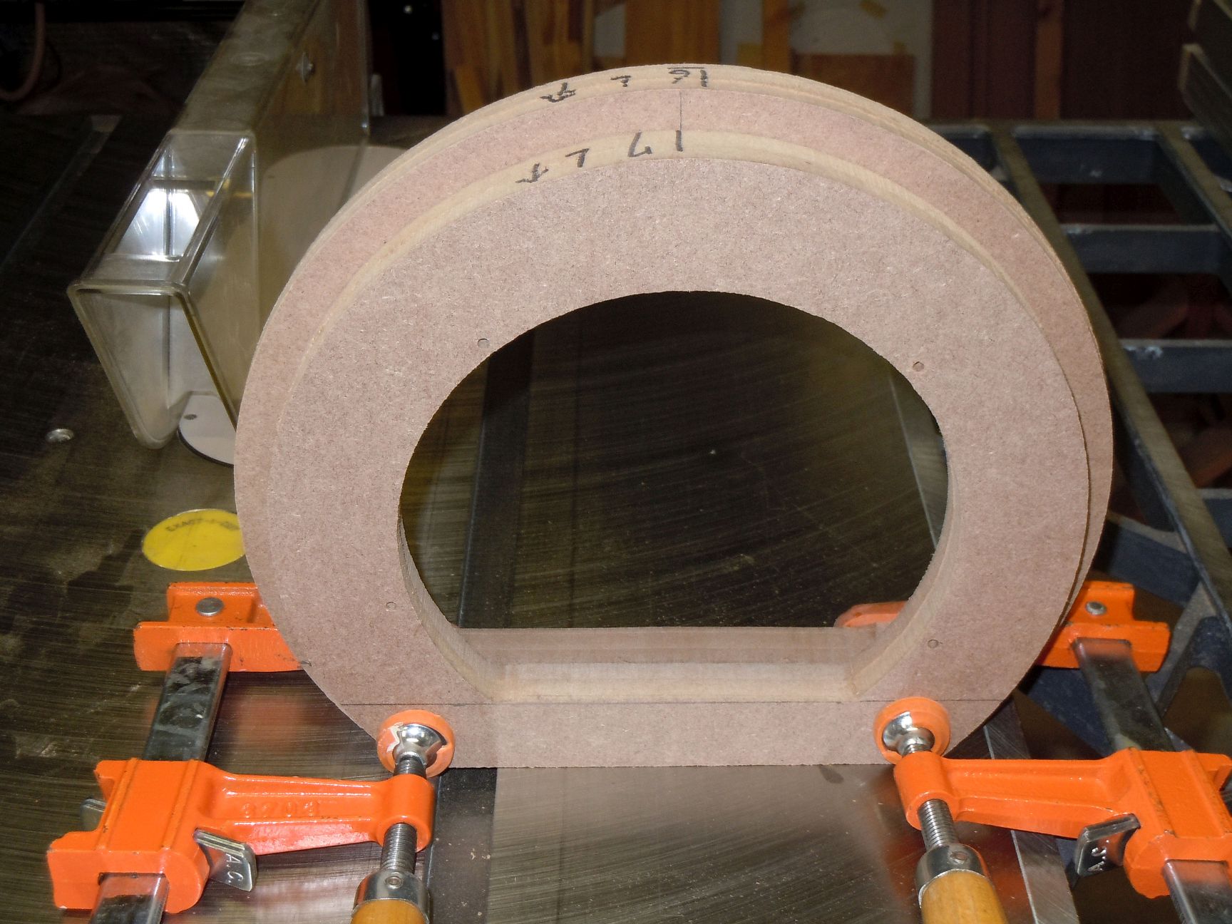

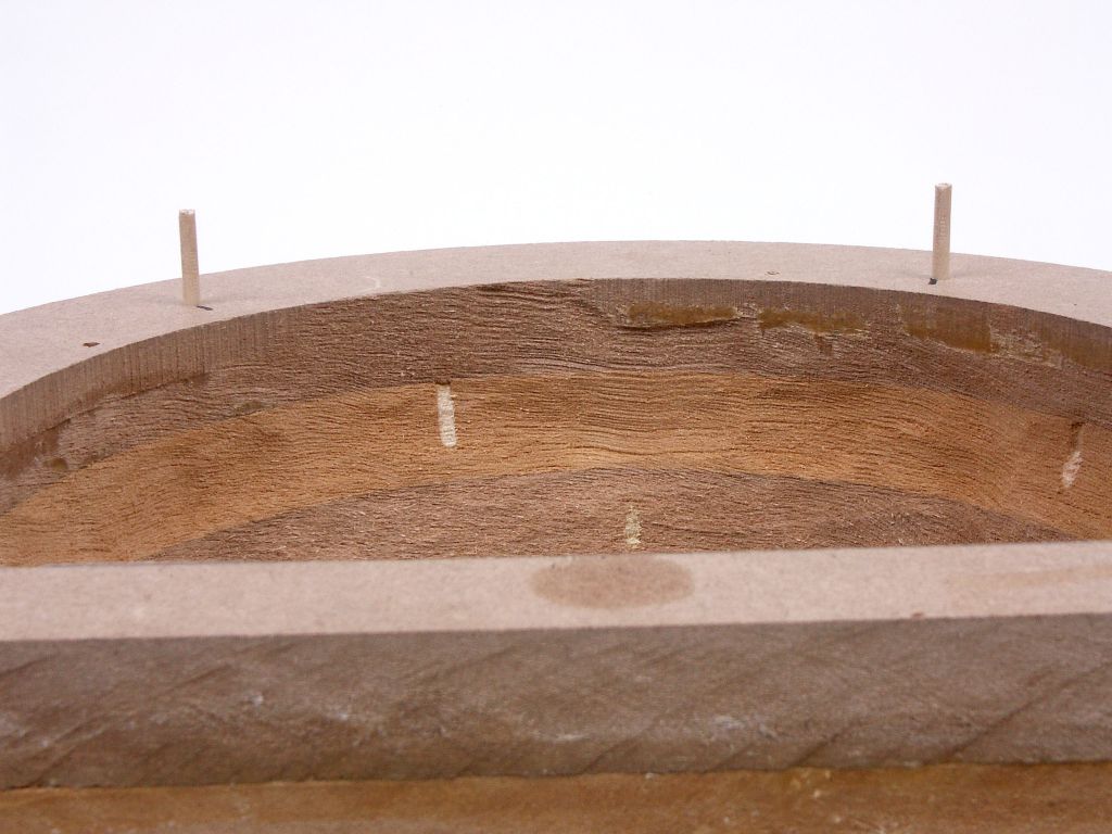

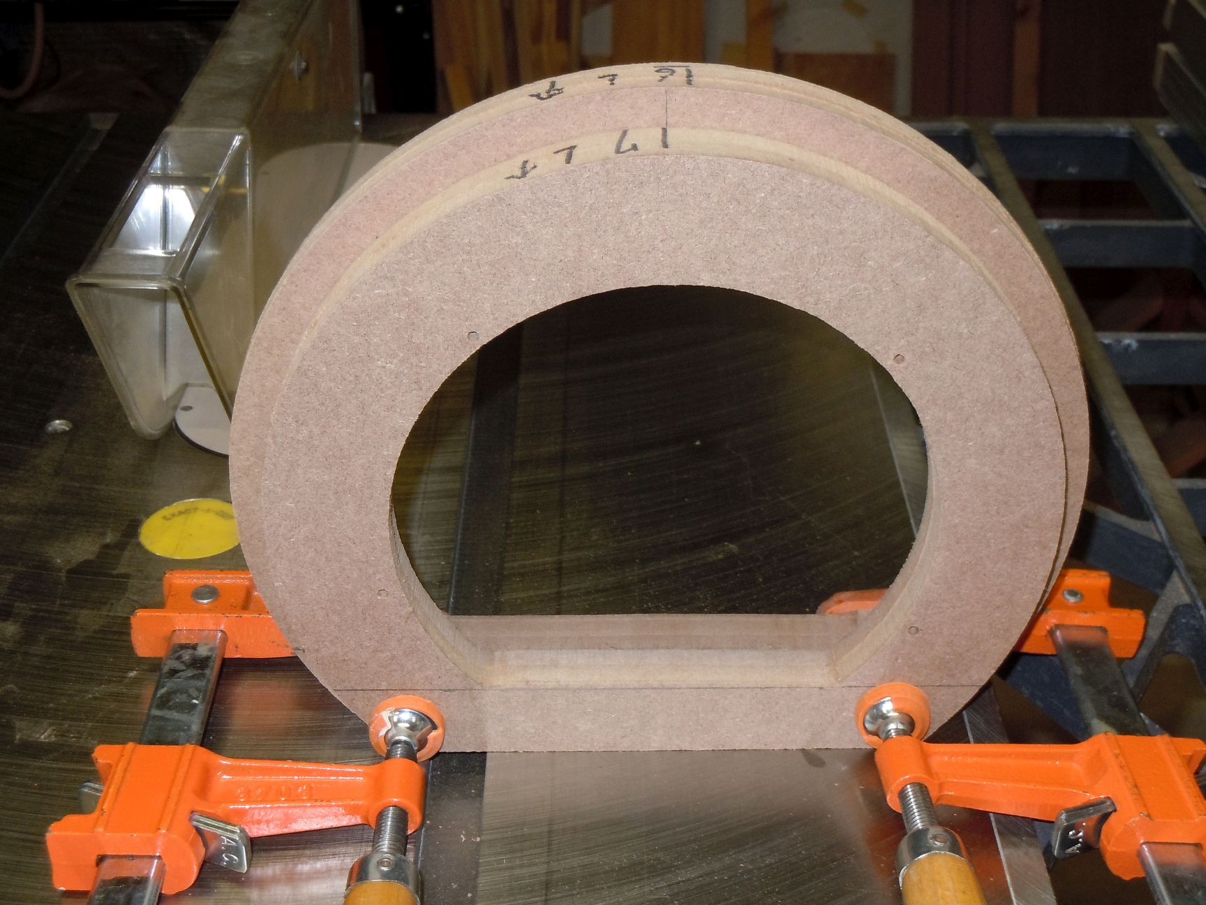

It's a tough call whether to do it with a CNC router or using templates for each layer and cutting out with a jig saw or router. Shashi is correct that the shape will change in both directions. You will also have the problem with registration of the individual layers. For my eggs I cut 18 sections with a router and used 4 1/8" holes in each piece that held sections of 1/8" dowel as registration pins when I glued the pieces together. That was a total pain and you still have to shape the rough edges by hand. I'll never do that again. If you could afford it I would go with the router. In either case you may wind up with a shape that does not give you the results you expect.

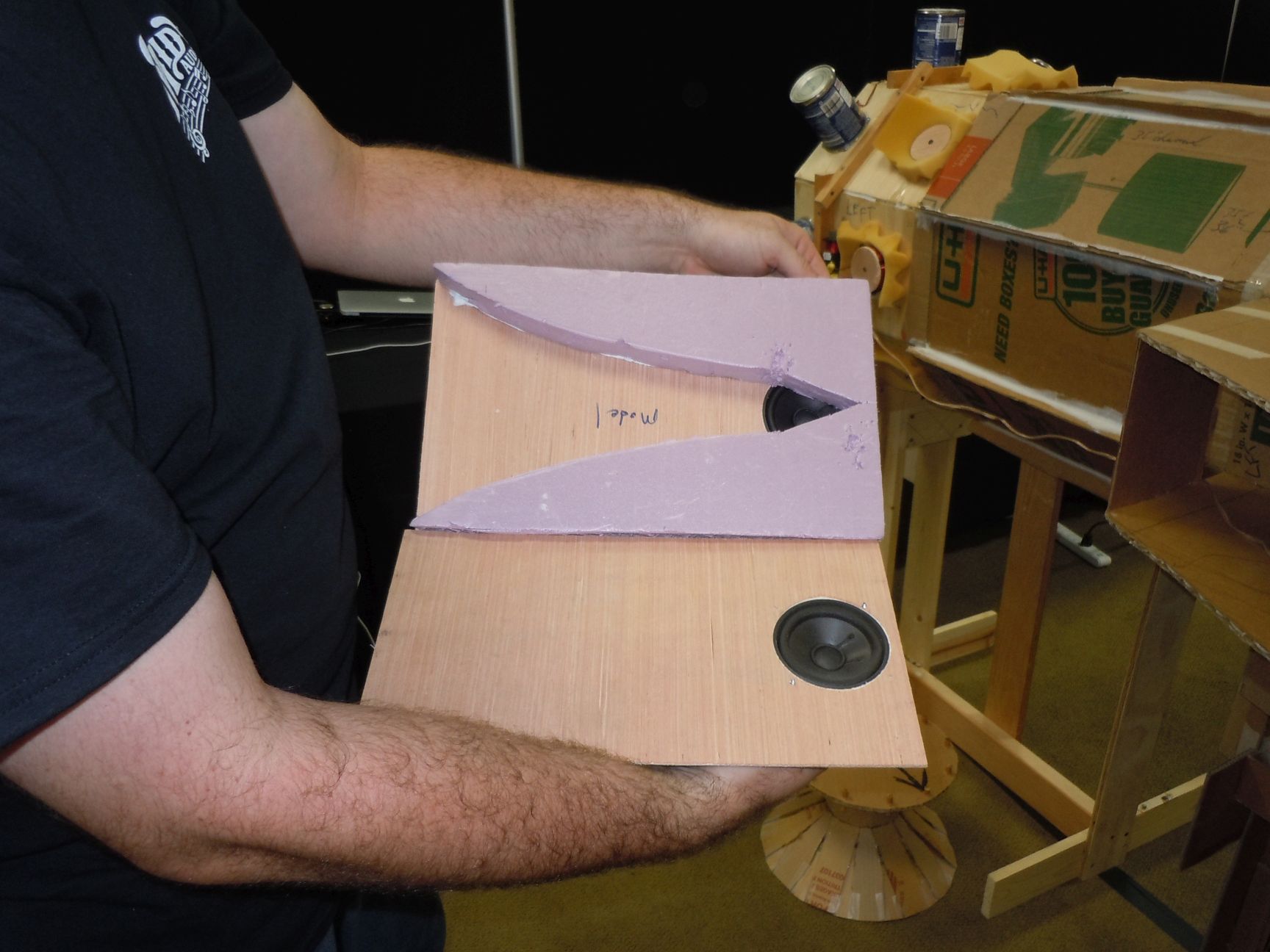

As long as you are only doing the foam core process for shape that will work. However, it will be useless for sound evaluation. Someone did that with a strange horn design at the MWAF Speaker Design Competition this year and it was the worst sounding thing I have heard. Here is a photo. There were lots of other things wrong but the foam core construction did not help. In past years there were other horns made out of foam and they never sounded good.

the foam has to be sealed. This will work if done right.
