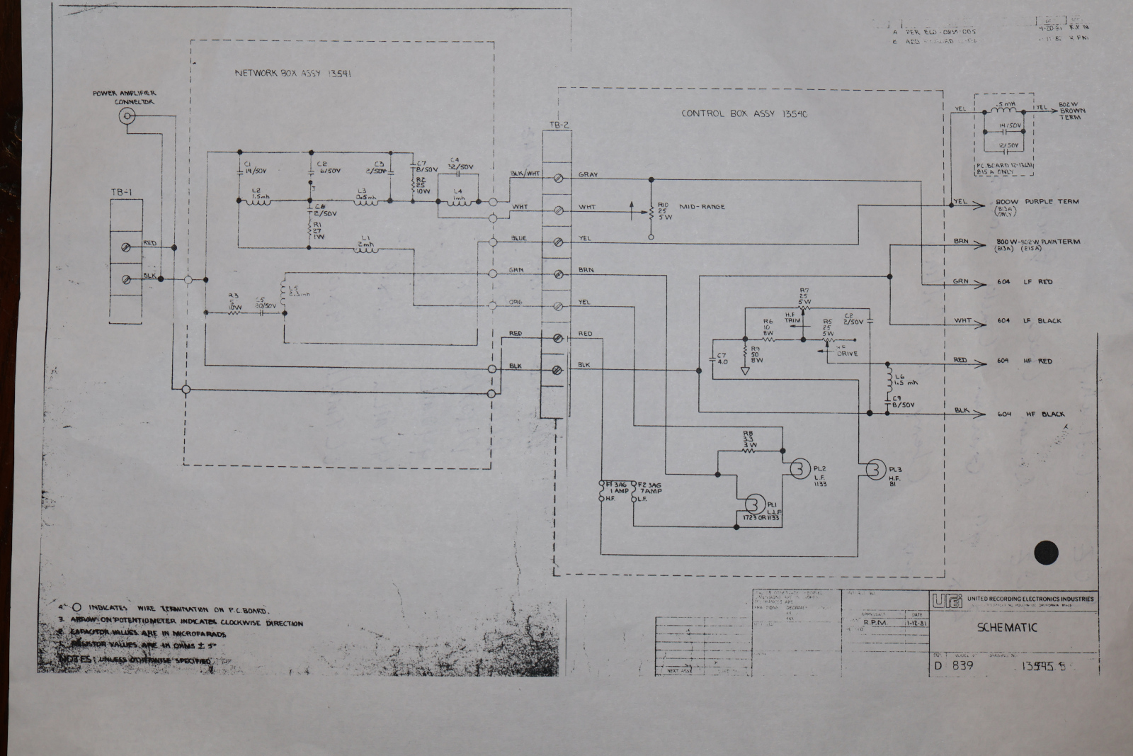

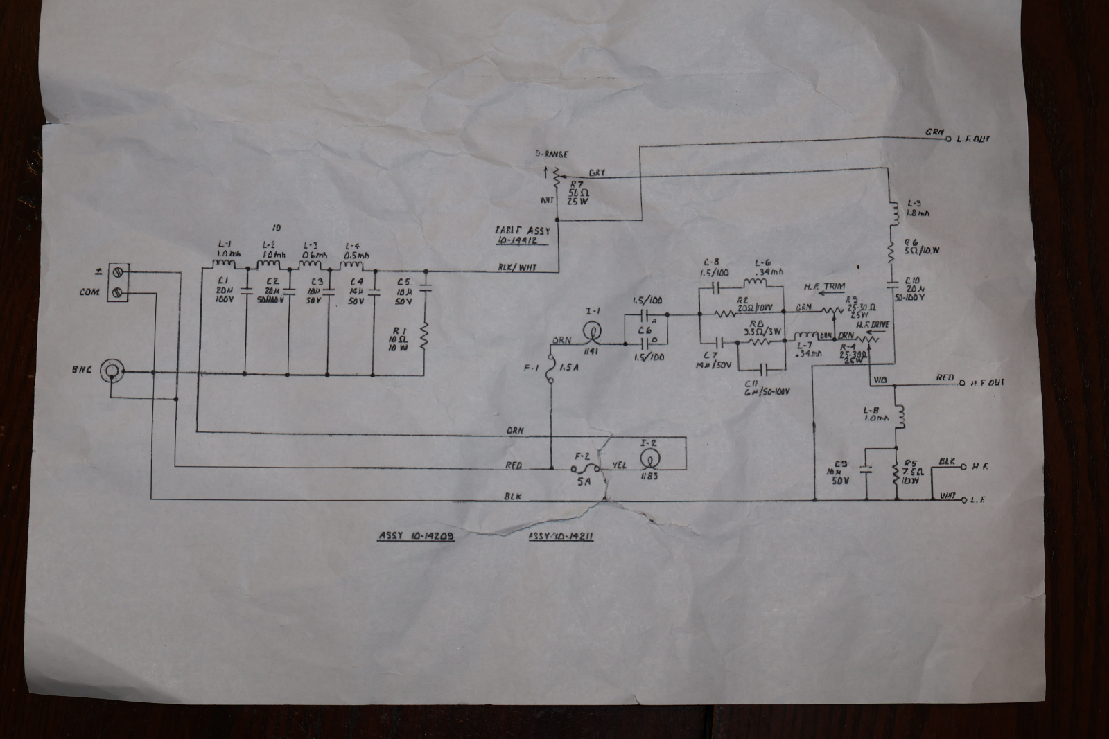

Roscoe,
Any chance you downloaded those UREI schematics from these links 10 years ago? Someone else at Lansing just asked for the same information you did and those links are dead. Naturally, I didn't download and post the readable schematic there at the time for posterity. If not, can you tell me the C3 and C4 values? Thanks
 Post subject: Re: New xovers...
PostPosted: November 19th, 2023, 11:33 am
I’m pretty sure I have it around here somewhere, let me see what I can find….
PostPosted: November 21st, 2023, 12:13 pm
I've got two different ones, on paper only (that I can find), and C3/C4 are different values, and different places in the circuit, for both...
For this one:
C3 10uf/50v, C4 14uf/50v
For this one:
C3 2uf/50v, C4 32uf/50v.
PostPosted: November 21st, 2023, 1:45 pm
Roscoe, thank you very much for digging those up. Per our text exchange it does appear the first one is the 830 network for the 811B. I shared that link at Lansing Heritage and we're looking for confirmation from a member there who has built several 811B crossovers with high quality parts.

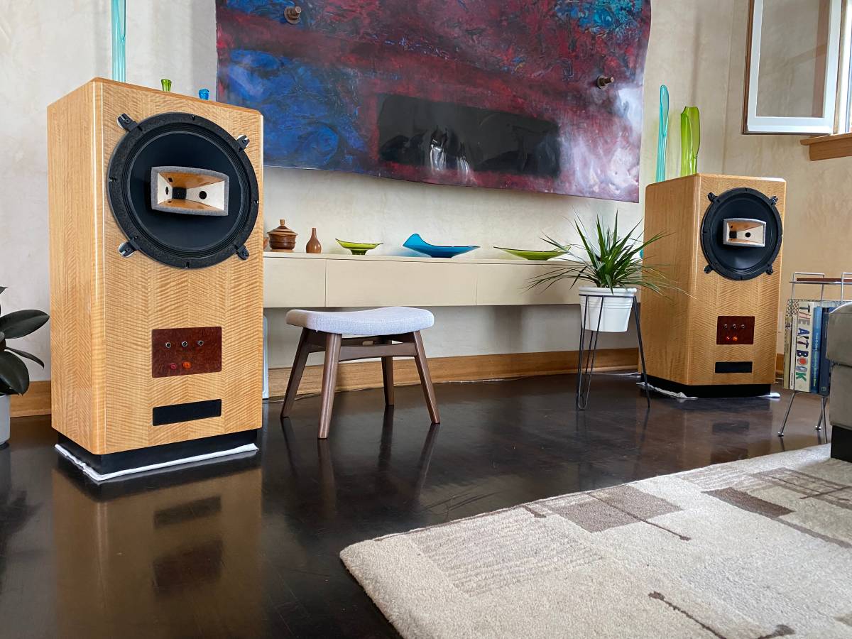

Oh, like these? ;-) Here's a little 811B porn for you Roscoe.
PostPosted: November 22nd, 2023, 5:48 pm
Not quite in that kind of shape.... Or in such nice cabinets, or as well-built crossovers...
PostPosted: November 22nd, 2023, 10:09 pm
Yeah, that guy does really nice work including making those wood horns to replace the blue plastic ones. :-)
