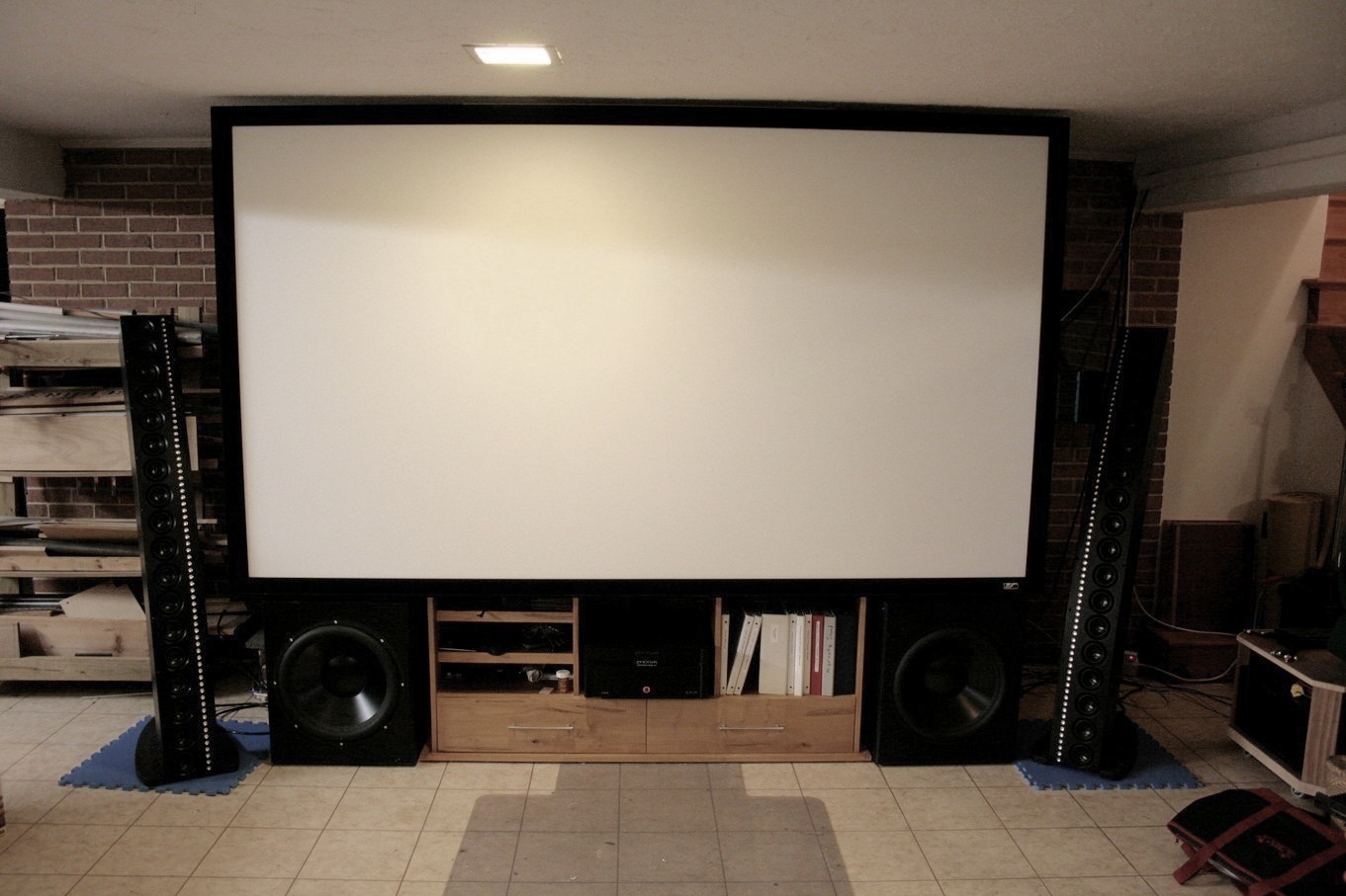

What you also can use to finish the cabinets on all surfaces without curved edges is formica. I used it on both the cbt36k's and the sub woofers. You would need a trim router and ball bearing guide bit to trim the formica to size after applying it with contact cement. For the speaker mounting panel (everything is mdf) I first used a large (a big as I could find) indelible magic marker and then several layers of black shellac and buffed it.
File comment: cbt36k's and subwoofers
