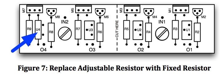

There are provisions on the PCB to replace the current-adjust resistors (U1-U4) with fixed resistors like those used for (R2-R9) once the required values are found by experiment. The builder may want to buy a single adjustable resistor to find the required value, and then buy cheaper fixed resistors for the CCSs.

Install the CERMET pots (U4-U1), followed by the grid-stopper resistors (R9-R2). If fixed current-adjust resistors are used, replace the pot with a fixed resistor. For example, Figure 7 shows the leftmost adjustable resistor U4 replaced by a fixed resistor. The other three CCSs have similar pads for fixed resistors.
File comment: Replacing a TrimPot with a Fixed Resistor

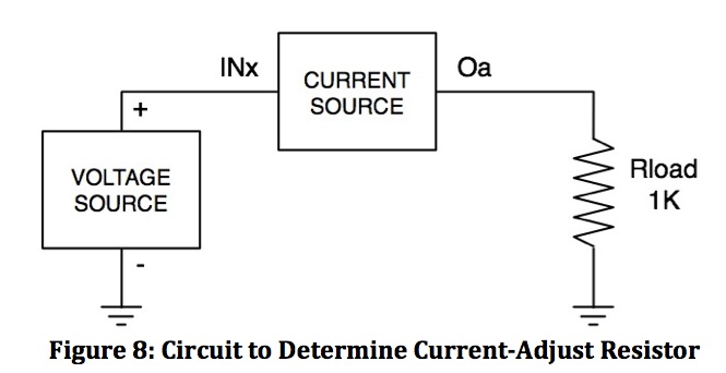

An easy way to set the current is to connect a 1KΩ resistor from one of the outputs (O1 O4) to ground, and a power source from the appropriate input (IN1, IN2) to ground as shown in the figure below. Apply at least 20V DC to the current source and adjust the appropriate current-adjust resistor to the desired current output. Measure the voltage across the load resistor (Rload). Compute the output current, which is the measured load voltage divided by the load resistance (1,000 Ohms). For example, to adjust for 30 mA, there will be 30 Volts across the load resistor and at least 20 Volts across the current source, so a minimum of 50 Volts DC is required from the power source. Other values of load resistors can be used to allow other voltages for setting the output current - just use the value of the load resistor in the equation.
File comment: Circuit to Find Current-Adjust Resistor

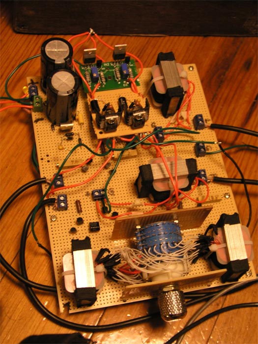

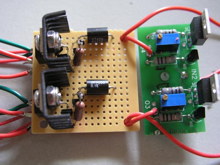

I finally got around to trying some out. The two CCS are for the left and right channels. The CCS (suppling 110mA per side) feed two TL431 based voltage regulators in a high current, shunt circuits that sink around 85mA each. The shunt voltage regulators provide a nice path for the AC current loop. This whole unit replaced a single LM317 for the positive rails of a jfet buffer preamp. The two CCS isolate the left and right channels so stereo imaging is improved. The other improvement was with the high frequencies which became more focused allowing more detail to be heard like the atmosphere of the recordings. I'm very happy.

Jetbat, aren't those DN2540s getting hot without a heatsink? And you're sourcing 110 mA apiece? That's cool! (as in groovy, because they're probably thermal hot!)

No they are cool. There is only a five volt drop from +27V power supply to +22V regulator. The shunt transistors needed heatsinks though.

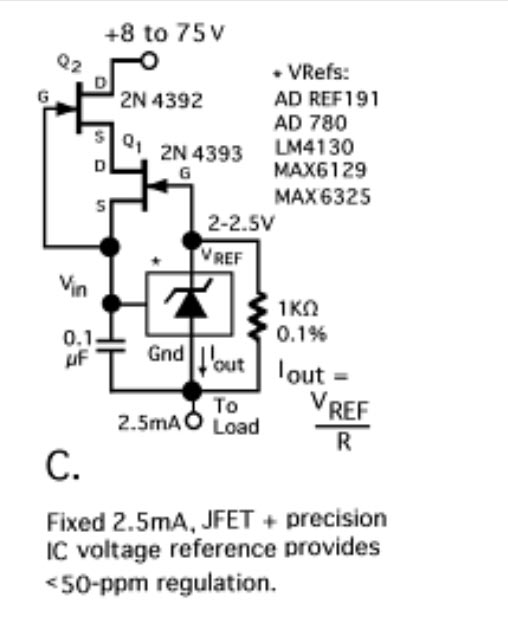

This is a circuit I found which seems very promising. This is the text describing it.
'Circuit C combines a JFET cascode together with a high-quality monolithic precision voltage reference. The reference IC keeps Q1's Vgs constant over a wide temperature span, to create a high-quality current source with less that 50-ppm regulation. The output current is set by the reference voltage output divided by the value of the precision resistor (a 0.1% or better tolerance and less that 50-ppm metal-film type). The addition of the voltage reference also improves overall temperature stability and boosts output impedance to about 1 GΩ.'
I have experienced a noticeable difference between a single jfet CCS and a cascode CCS in sound quality. With the cascode CCS having a output impedance of >5 MΩ, the reference voltage CCS should give even better results. I will try this out and see.

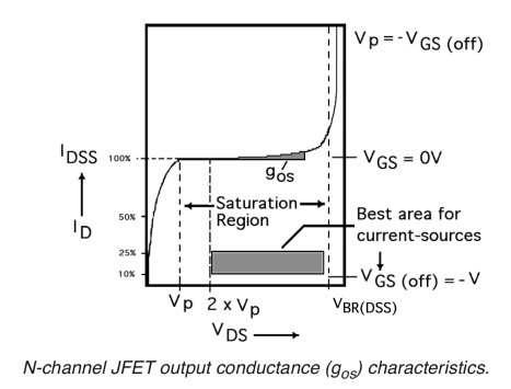

Guy, I'm still learning here. The internet teaches me things but does not correct me when I am wrong. In trying to understand the DN2540 CCS I found this graph which helps me immensely. The graph is for a single jfet CCS but it puts things into perspective that I can apply to a cascode CCS. I now understand that while my application of this circuit works, it is no where near optimum. The 5V across CCS is too low. I need to increase that to at least 10V but 20V would give me some margin. Looking back through this thread I see you did recommend at least 20V across the CCS. Duh! So while it does work in this application, the isolation/impedance of the circuit is probably much lower than it could be. Looks like a new power transformer is in my future. :)

I was surprised that you had stable performance with 5V across the CCS, but why questions success? You noted improvement in channel separation and high-frequency response so I delayed in suggesting an increase in supply. Fortunately your supply is low voltage relative to an EL84 supply so the transformer shouldn't be too expensive.
Heat sinks on the DN2540s may be important once the dissipation rises from 1/2 W to 2-1/4W each.
I like your proposed circuit and am eager to see what you think about its sonic performance compared to the cascode-MODFET circuit. The cascode is not an extreme circuit, but has great performance given the simplicity of the circuit. I offered the PCB because it's a fast and inexpensive way to get a circuit going, and I'm gad you gave them a try!
