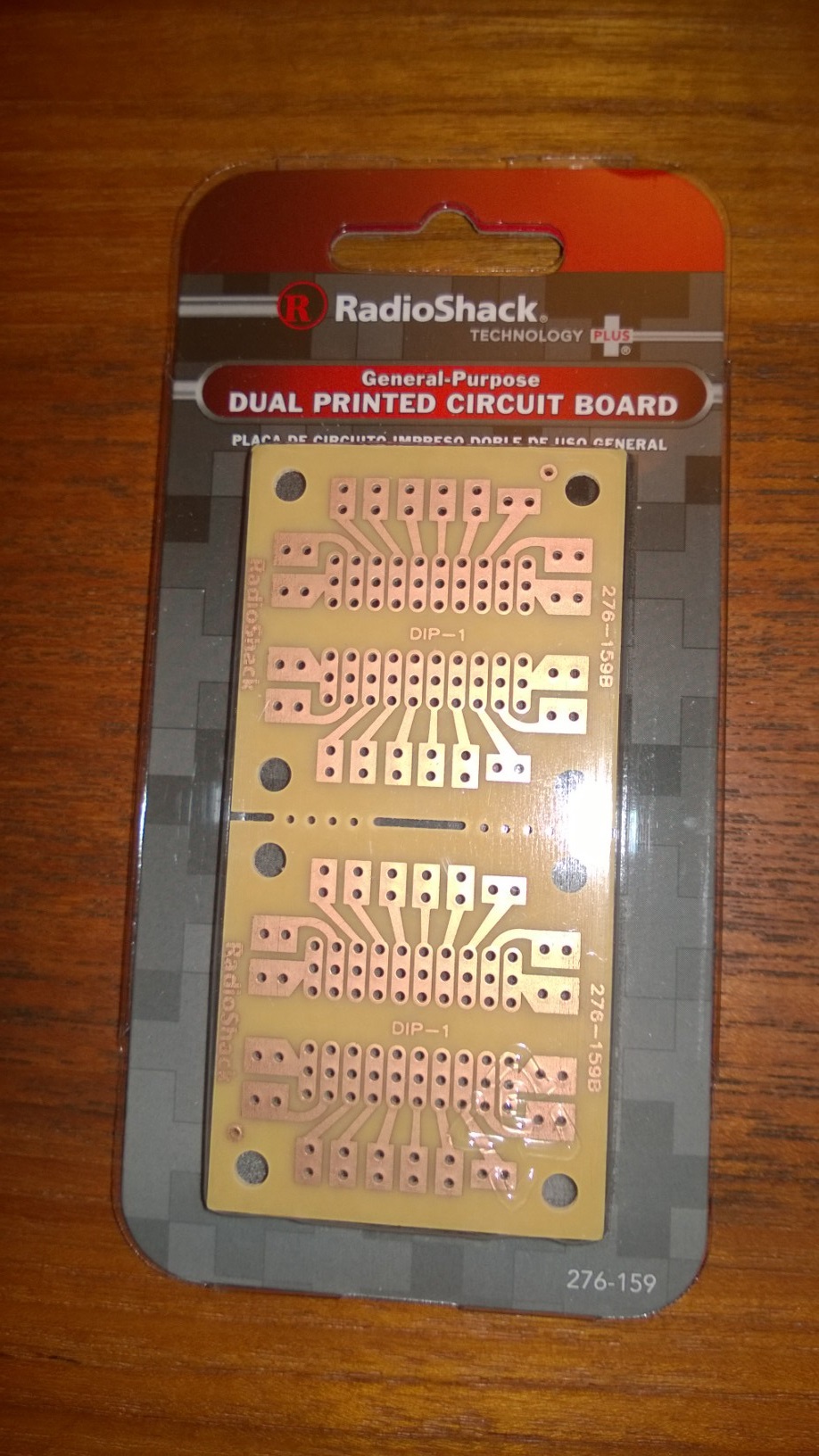

Posts: 928
Found the IC PC board.
Time to start building up the Burson opamp adaptor.
