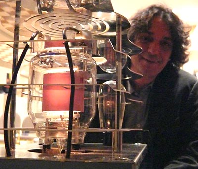

Use 833s. Less wiring for the same amount of heating ;)
PostPosted: March 3rd, 2016, 1:20 pm
Now that is a real HE-MAN tube!! :o
Here is a photo.
