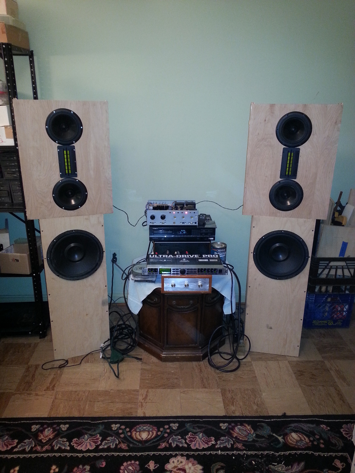

The experimental rig in my apartment. These are the M165-16 OB and the Eminence in too small of an enclosure. Not bad. Not great, but with more experimenting........

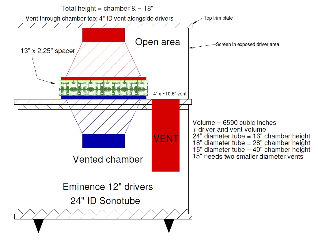

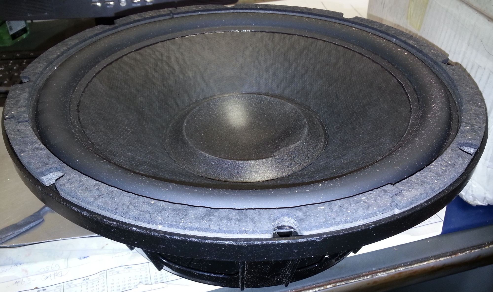

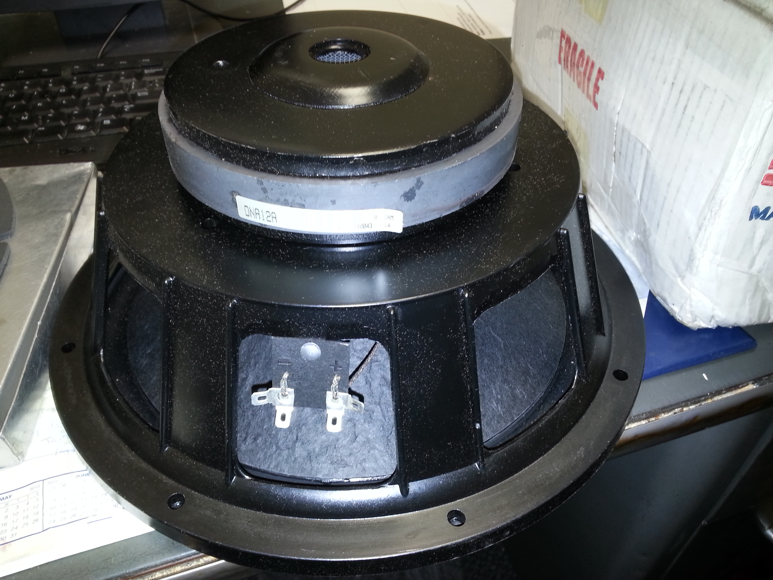

Sonotube bass using the nice Eminence drivers I already have (think cheap for me) THEORETICALLY gives me ~30Hz @ -0.5dB and ~24Hz @ -3dB, that in a vented enclosure tuned to 25.5Hz, two drivers per side arranged in an isobaric clamshell.
Hope to use this to ~80-100Hz .
The upper bass drivers will then mount to new ~24" wide panels (made of two 0.72" thick sheets of Birch plywood) along with the Neo8 and Maggie ribbons, all-in-one. Since I can place the Sonotubes behind the panels, speaker width will be reduced from 102" to 48".
If it sounds good, that size will work.
As an added bonus, the Sonotube bass speakers should be about 91dB/W/M, the upper bass (as low as possible to ~1kHz) ~98dB/W/M [8 per side]; the Neo8 (six per side) ~97-98dB/watt, 1kHz to 6kHz; and the Maggie ribbons from 6kHz up, well, who knows? The ribbons have 1-2 ohm series resistors to reduce efficiency to match the midrange. So, given that they are either 2.1 or 2.7 ohms, I expect they may be as good as 88-89dB/W/M.
Bottom line is that tri-amp should work well with moderately powered Class A2 tube amps! No need for heroics and hideous breeds (hybrid), except for the Sonotubes @ 500WPC!
Eminence T-S:
RE OHMS 6.31
FS HZ 26.59
LE MH 1.49
MS GMS 71.80
QM 9.70
CMS mm/N .4990
QE .440
RMS NS/M 1.2367
QT .420
VAS LTRS 189.11
XMAX MM 4.80
SD SCM 519.45
BL TM 13.13
EBP 60.5
EFF % .78
SPL dB 90.9
