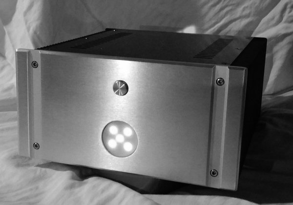

One of the advantages of this kind of amplifier, that wasn't mentioned, is that the power supply gets essentially isolated from the signal path. If you use a single power supply, and capacitor couple the output with the other end of speaker tied to supply ground, then power supply noise and ripple is blocked by the inductor. And if you trace the output signal current paths, no speaker signal current flows through the power supply filter/reservoir capacitors (unlike with other schemes). The power supply outputs constant current, so the reservoir caps don't see any signal current. The inductor more or less takes over the "reservoir" function -- that's in the ideal case, of course, of the inductor being large enough that it acts as a current source for all the bandwidth... unfortunately it's not entirely the case at low frequencies. But the low impedance of a Sziklai pair follower, with DC supplied via the inductor, would still isolate well from the power supply. And if you use a regulated switching power supply (very cheap, use the ones made for LED lighting!), they have very little low-frequency noise, and their higher frequency noise is very much blocked by the inductor.
I've made several of a somewhat similar type amplifier, using (in most cases) Triad chokes. There is to be an article soon in Linear Audio magazine about a previous version (good for about 20W/ch). The latest (and probably last) amps I made that way do about 60W/ch/8 ohms, SE class A, no global feedback. Because of the choke, and some tricky circuit design, the efficiency is about 45%, quite good for a SE amplifier I think. The heatsinks are surprisingly small for a fully-class A of that power. The steady state dissipation is nearly identical to that of an old McIntosh MC60 amp in fact. The output devices are source (or emitter) follower configured Sziklai pairs ("CFP"), so the output impedance of the amp is still quite low, as is the harmonic distortion (under 0.1%, primarily 2nd order, with a little 3rd order, much like a triode's).
