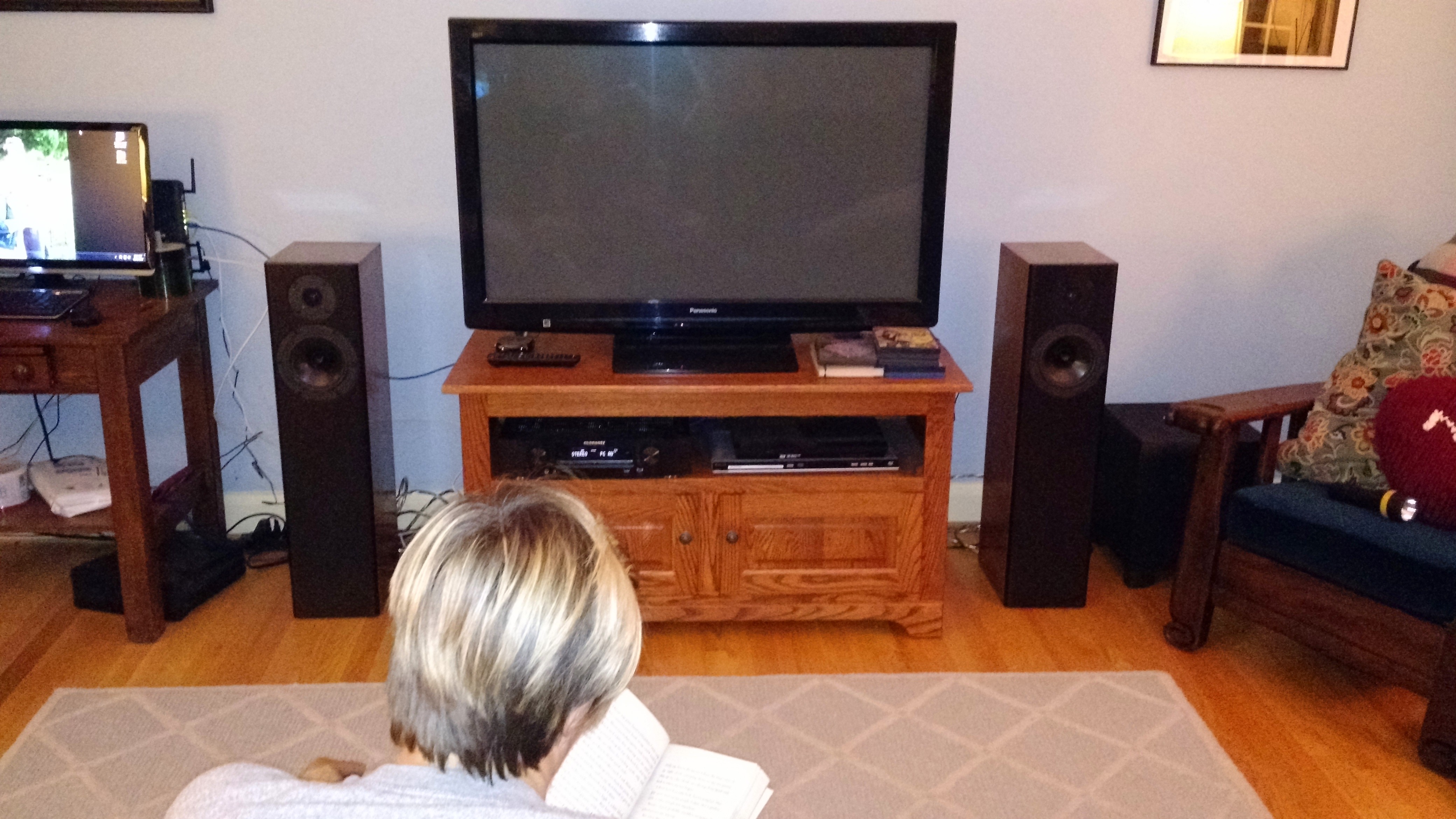

Got the second cab finished tonight and have been listening for the last few hours. Pretty amazed. Hats off to Paul's design as the sound far exceeds nearly everything I have heard in a bricks and mortar store. The fact that I made them from nothing but plans puts it over the top lol
Here is a pic

can you tell me the particulars as far as efficiency and ease of drive for tube amps and the like?
 Post subject: Re: First Speaker Build
PostPosted: October 9th, 2014, 7:07 am
Posts: 98
Randy,
You can find all the particulars on Paul's website. https://sites.google.com/site/undefinition/core-2-way He includes graphs for frequency response as well as impedance. Per his description- it would be listed as an 8ohms nominal speaker. Based on the graph I would estimate a mid 80-s for efficiency. I am powering mine with a Marantz at 50wpc, and had them at a pretty loud level last night, and that was only half volume. Also drove them with an older Kenwood integrated amp for testing- which is rated at 40wpc- and had similar results. I would consider them pretty efficient and amp friendly- as they are driven easily with my receiver. Tube amps- I am not familiar with, so I cannot speak intelligently about how tubes would drive them. But I would think with at least 15-20 watss- that would be plenty to drive them.
Jeff

Looks good! I am sure you will be experimenting with placement, that can also make a large difference (good or bad) in terms of how they sound.
