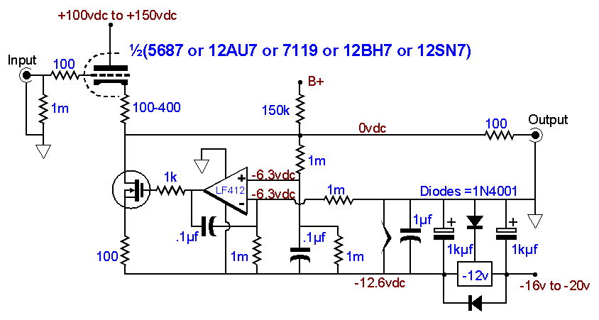

December 19th, 2013, 6:15 pm
Here is the circuit as originally drawn by Broskie. Guy and I made a few changes based on experience with implementation. NO connection to B+, you can actually get over 32V on the output during warmup!!! We connected to a low voltage + supply (6V3) and never had more than a couple tenths of a volt during warm up or turn off. 0.1uF caps didn't get the job done. Poor bass response. Switched the FB cap to 3.3uF (cause I had them) and the bypass cap to 0.47uF and all was hunky dory. Switched out the 7912 for an LM337 per Yaniger's design and the AD825 Guy designed for. Filaments are not connected to this supply in my boxes.

Stuart,
Couple of comments. Change the 1N4001 to something like a 1N4148. No reason to have added capacitance of a power rectifier when a small junction will do. I don't know what MOSFET you are using, but I would choose a bipolar transistor such as a MPSA42 as it has very low capacitance in this application. This transistor is a small TO92 plastic device with 300 volts capability.
I would use a follower with a wide dynamic range to drive each filter. Each follower should have a dc servo to eliminate the coupling caps. By wide dynamic range, you should consider a negative voltage supply of -60 volts and use the current sink transistor like you show in your circuit. The easiest way to make this work, though, is to go back to wrapping the feedback back to the grid of the tube. Otherwise, you have to get into precision voltage dividers and referencing the Op amp to the - 60-volt supply. You do need to watch the power dissipation on the transistor if you are pushing 7 mA as this would be almost half a watt in the transistor.
The reason for the follower driving the filter is that when you come off the plate into the filter, you end up with a non-linear source impedance for your filter--not a good thing. I use this filter buffering in my better preamps now for EQ, and it is a big improvement in filter accuracy.

Stuart,
You could reference the Op Amp to ground if you use some sort of level shift transistor to drive the current-sink transistor. Then you you could go with the general topology you have. This would be preferable. The only thing is to maintain stability as you are adding an additional gain stage in your already fragile feedback loop. But I know it can be done, as I did something like this in my TF-12 preamp years ago.

David,
I'm not using the supply as drawn by John Broskie. I'm using an LM317/337 variant as laid out by Stuart Yaniger. No diodes.
Mosfets used have been IRFF220 and IRF820 or 840, Have to look up the #.
I've seen the filter inaccuracies from simulations. It was apparent that a low source impedance was needed to get the expected filter results. In fact, using Broksie's recommended filter scheme, which lacks any stage prior to the filter, adversely affects output of the preceding stage (in another piece of equipment, DAC, Phono stage,etc.) into the outputs of another filter, i.e., high pass & low pass. So, when I implemented my first filter, I did add a ~medium impedance gain stage (to be able to adjust for different amplifier gain levels) and used a high impedance filter. My rule was 1:10 minimum.
Since then, I found that a medium impedance filter sounds better (cleaner), i.e, 10k vs 100k, so now I need a 1/10 impedance gain stage.
But I'm trying to eliminate the line stage>filter by making it all-in-one, eliminating a series gain stage setup. I think a gain of 10 will suit any foreseeable amplifier combinations, so I was asking about an excellent sounding tube, with a mu of around 20, that I can use as simple grounded cathode, to drive a filter network with a ~10k impedance. Obviously. there will be variance, since the filters will be:
