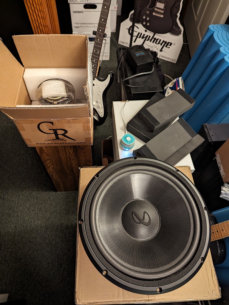

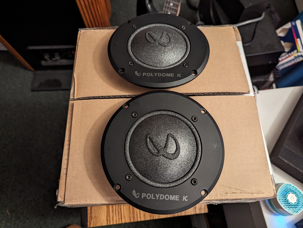

Unpacked the repaired drivers for the Kappa 8 repair.
Wiring the drivers directly to a new terminal plate.

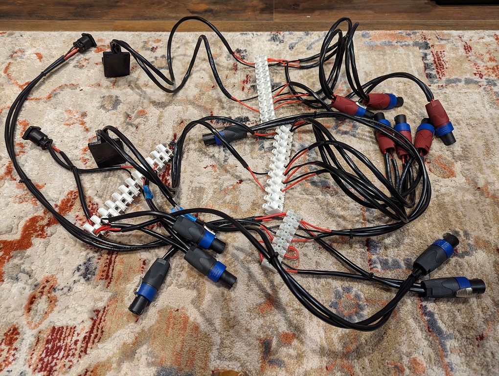

I use Neutrik Speakon 4-pole connectors on the servo subs wiring.
It is possible to use them, but just decided to use the 5-way binding posts as they work with normal speaker cable terminations. Easier to drill the holes for the binding posts as they are #10 screw size.
