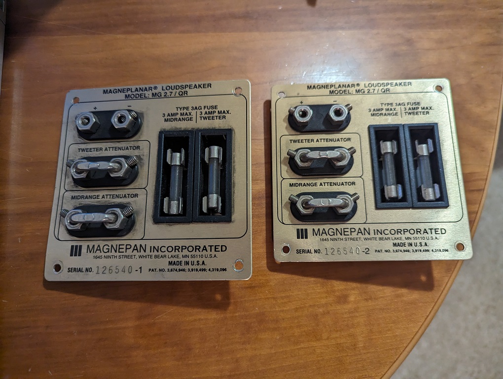

Talked to Magnepan and was able to get a pair of used 2.7/QR speaker connector plates to rewire the 3-way 1.7 planar speakers for direct amp drive. I can also rewire the fuses to the tweeter and super tweeter for protection.
These connector plates will have the 6 new Superior Electric BP30-10 5-way binding posts for speaker wire connections. :)

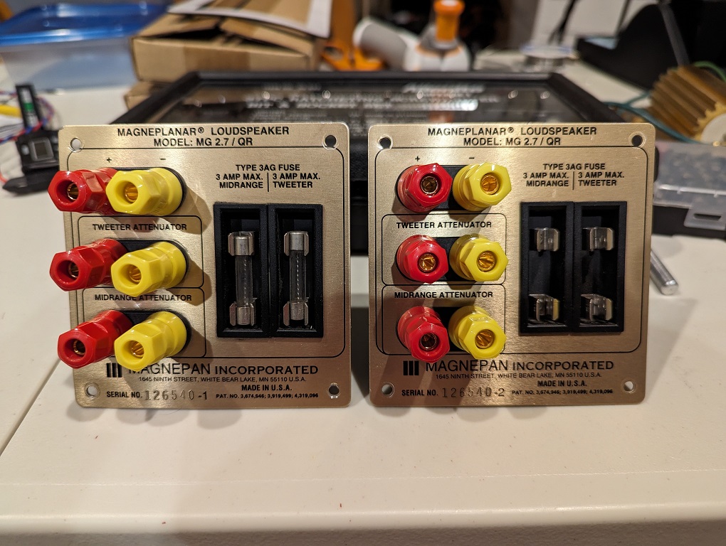

Posts: 907
Modified the new connector plates with the Superior Electric BP30-10 5-way binding posts.
Next is to rewire the fuses to the tweeter and supertweeter planars for protection.
Hard to find the black 5-way connectors, so went with yellow for the negative terminals.

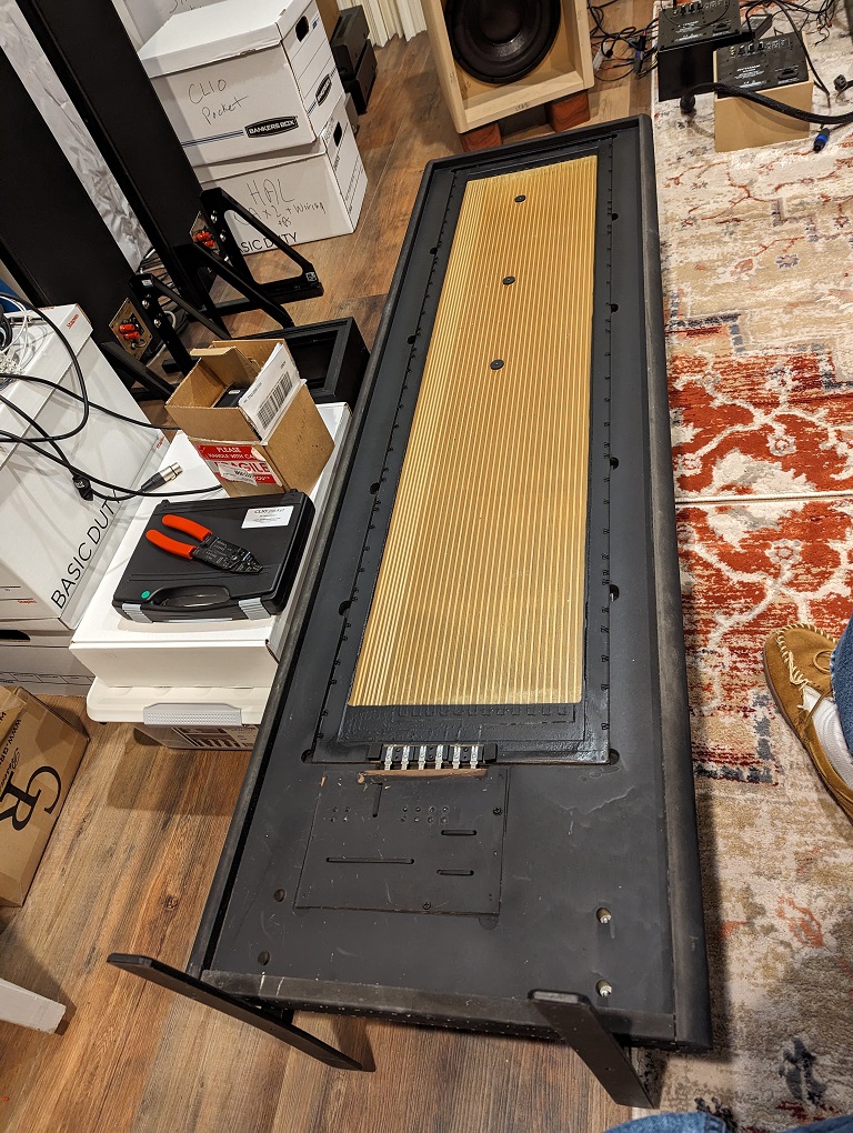

Have the side stiles and sock removed on the 1.7 with the open super tweeter foil. Nothing obviously broken or burned.
Have the Acetone and Super77 adhesive needed for the process of removing and reworking the foil traces along with the foil replacement kit from Magnepan.
Once that is done, time to rebuild the speaker for 3-way triamp with the DSP crossover.
