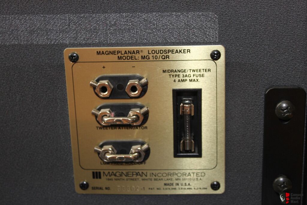

If both sets of speaker terminals for the QR tweeter and bass panel are not available, there will be a little rewiring and some new labels added.

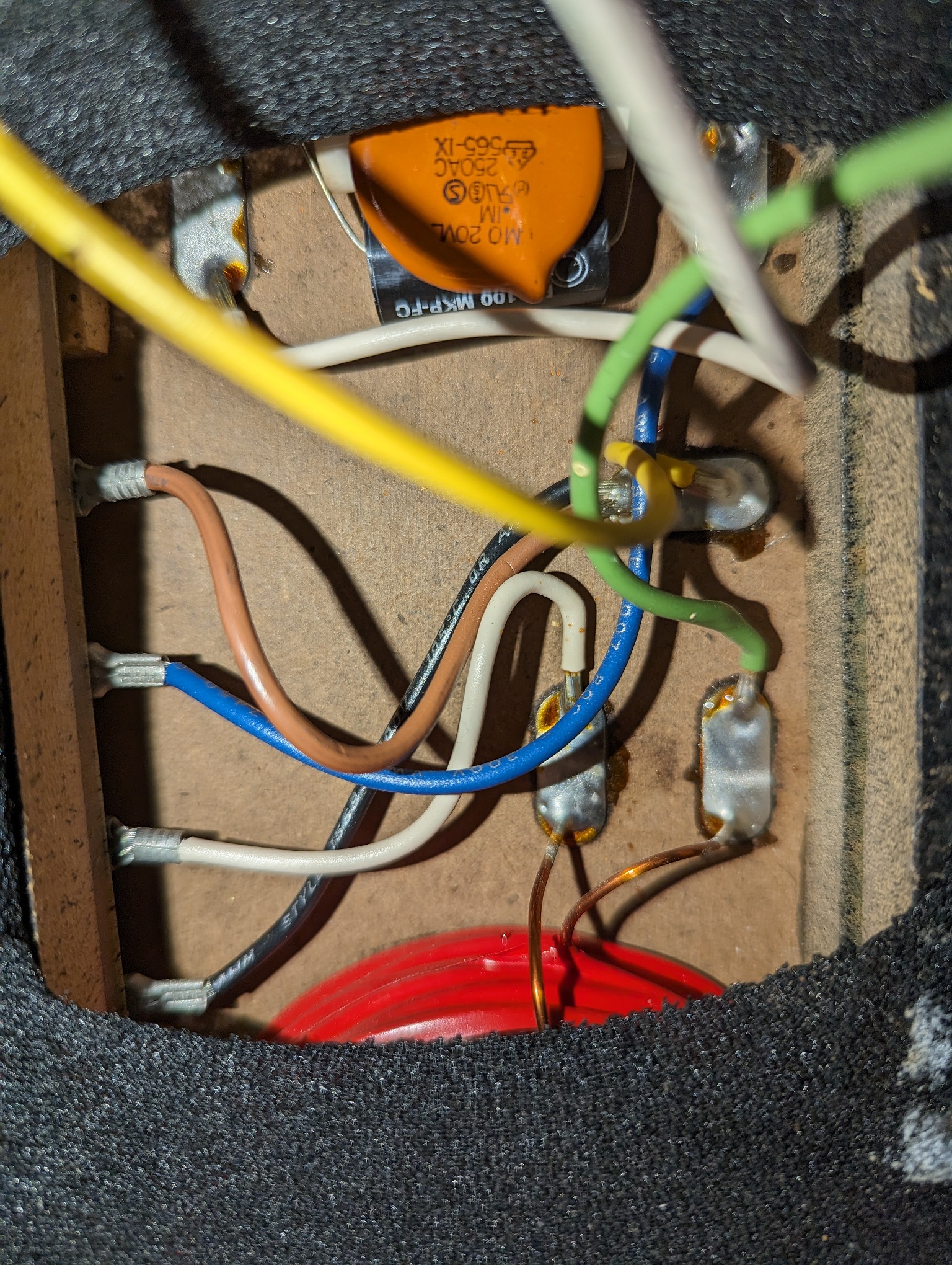

Removed the connector plate and the crossover uses fast on connectors to the drivers. That will make it easy to disconnect the original crossover, install 4 new 5-way binding posts and install them on the rear plate. Will keep the original parts for later.

I found that schematic as well. There are a few things wrong. The first is that it has the fuse on the quasi-ribbon only. Not sure about parts values shown without measuring them.
Have not measured the components, but there are 2 jumpers vs the 1 shown. It would have been easy if it was set it up like the earlier MGIIB's, as they were built for biamping. Even had an upgrade to buy a passive low level biamp crossover that worked. Used two Hafler DH220's in the day.
More important is to start with new frequency response measurements with REW and dspNexus 2x8 with the phantom powered mic input.

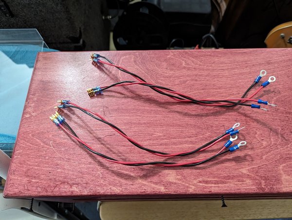

Started making the 4 wires to go from the driver terminals to the back plate with 1/4in fast-ons and 14awg Benden 1309 stranded wire. Picking up the ring lugs today for when the Superior Electric 5-way binding posts arrive.
If the SE 5-ways are good enough for CTC Builders after a lot of trials for the BBQ power amps, I am good with them. Will remove 4 of the original MG10QR sockets and replace them with the 5-way's.

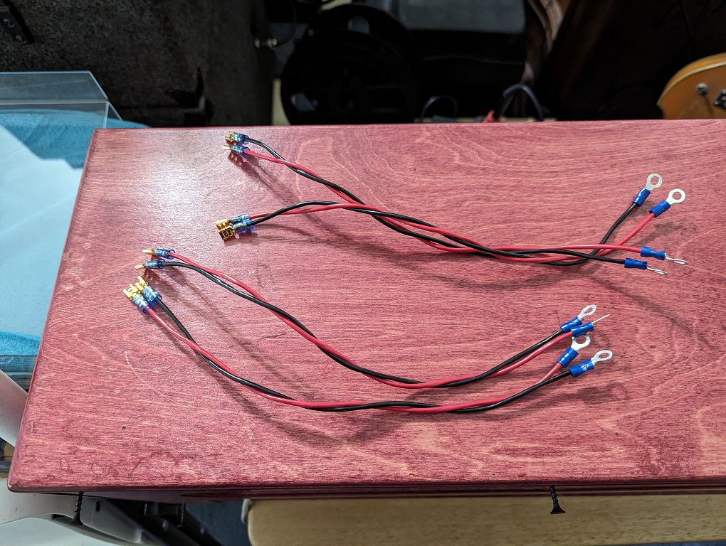

Have the 8-Superior Electric 5-way binding posts coming soon, so made the wiring to go with them.
Will just store the original wiring in the back of the speaker with the picture for future use if needed.
