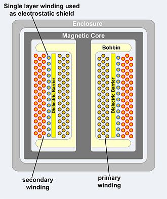

David McGown wrote:Actually, Ayer using an EI transformer is a good thing. Toroidal transformers, although great for low magnetic field, is high bandwidth and HF noise will pass thru to the power supply. An EI transformer is more effective in filtering that out.
Actually EI transformers pass RFL/EMI hence the need for isolation versions with a shield between windings.

Walt,
What I was suggesting was the HF bandwidth of an EI power transformer is limited, and therefore can act as a filter for noise on the lines. For instance, EI core isolation transformers are much more effective than cheaper toroidal isolation transformers in filtering lines noise. Smaller toroidal transformers can have bandwidths up to 100kHz, Richard Sears successfully used an off-the-shelf Talema power transformer as a full audio bandwidth output transformer in a small PP amplifier. Try doing that with a 60Hz EI power transformer. What is best probably depends on circuit susceptibility to EM fields vs. lines noise, i.e., the specific application.
