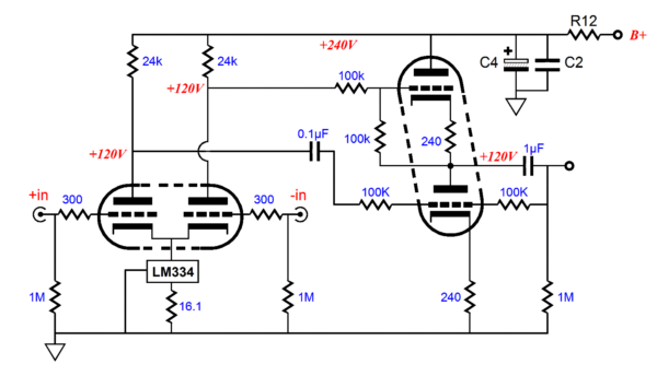

I'll read up on those Tom. The Unbalancer doesn't use any signal transformers. I'll post the schematic later. The Izzy Wizzy phono stage has a differential output stage. The plates are connected just like a push pull amp to an interstage transformer. It's been highly praised. We'll see how it sounds, whether the elimination of coupling caps, but the addition of a transformer is better or worse.
How about a plain and simple differential input connected through XLRs?
That works fine if I wanted balanced out. I may someday.
You can go from a differential input and do a summing network to singled-ended for the output. Or -- still balanced you can just tie the non-inverted output to the RCA center pin and the inverted out to the ground return. You're working from scratch you can do just about anything. Your power amp(s) could be modified to have a differential input before the phase inverter stage.

Since you are committed to PP amps, the natural thing is to keep everything balanced (differential) to the power amp. No more phase splitter. It makes no sense to convert back to single ended out of the preamp and then split phase again at the amp. I know the OddWatt amps do the phase splitting in the output stage, so it would require a little rework to convert the SRPP driver into a differential, but hey, it is only resistors and perhaps another signal capacitor. But that is a system wide change and upsets everything including interconnects (right after you upgraded to RCA Audio Envy!). You should really look at Allen Wright's designs for a fully differential preamp/amplifier. Some really interesting and good stuff there.
All you are doing is executing in vacuum tubes what the Topping does with an opamp when it converts from balanced to SE after the DAC. The most basic circuit is a summing amplifier executed with a single opamp. Maybe the tube circuit will sound better, but maybe not. It is cheap to put something together with what Tom is suggesting. A pair of transformers is another solution that is easy to try without upsetting everything. Jensen and Cinemag makes some. I think I may even have a pair of Cinemag transformers that may work, I will have to dig around.

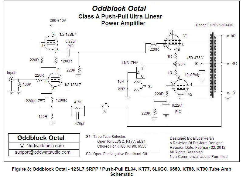

No, the amps I'm using right now cannot be modified in that way. The output stage IS the phase inverter.
I am not rebuilding all components in my system. For new builds, maybe all balanced. You never know unless you try.

"No, the amps I'm using right now cannot be modified in that way. The output stage IS the phase inverter."
I get it. I am surprised the cascode front-end has enough oomph to drive the output stage. Yet we all heard them during the get together.

That's not a cascode...
SRPP -- Cascode.......Potato -- Pota'toe
Kissing cousins.
 Post subject: Re: Broskie's Unbalancer
PostPosted: March 23rd, 2023, 11:36 am
Posts: 978
Kissing cousins.
Hardly. Completely different functionally. Cascode = Pentode w/high gain, upper section needs a plate load to work, high impedance output. SRPP = PP amplifier at 1/2Mu gain, no plate load on upper section, low impedance output.

Finished the preamp yesterday, electronically. Still need to label the controls and tube sockets; install a mesh bottom cover.
Gain of 7 single ended, 14 balanced. Started with RCA 6CG7s at the input, JJ ECC99s for the followers. 0A2 & 0B2 gas tubes, 6DN4 damper diodes, cascoded DN2540 current source for the B+, simple bipolar 2N4444 (I think) current sinks in the input tails. Miflex coupling and output caps for the high output. Walt's electronic components 5uF (paralleled for 10uF) for the low output which goes to a miniDSP (5K input impedance). Used the eBay $25 stepped attenuators for gain. 100k stereo units, one per channel. Signal wiring is either Cardas of solid silver within Teflon sleeves. Relay switching of inputs. Unbalanced inputs feed signal and "ground" to the input grids.
Initially tried it out with the same homemade XLR--RCA cables I was using, made with Neglex cable. Then switched to a pair of World's Best Cables using Neutrik connectors and also Neglex cable.
With life's challenges and my own laziness getting in the way, it took two months to complete. It was worth the wait.
The improvement is substantial, most notably space between instruments, amazing to hear really. I think I may have my final line stage!
Can't wait to get a pair of AE O'nestian interconnects and try out some different input 6CG7s (I have some nice Sylvanias). But right now, I just can't stop listening.
