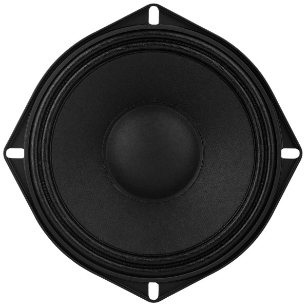

It is a work in progress. That is the only way to mount the tweeter using two of its five mounting holes. The original woofers were the five inch with the square, curved frame.
I do have a pair of 8 inch woofers, but I need cabinets for them.
The cabinets are metal, and require something stuffed in them.
Both drivers are wired in parallel. The round speaker cup is just there for the convenience of plugging in my banana plugs.

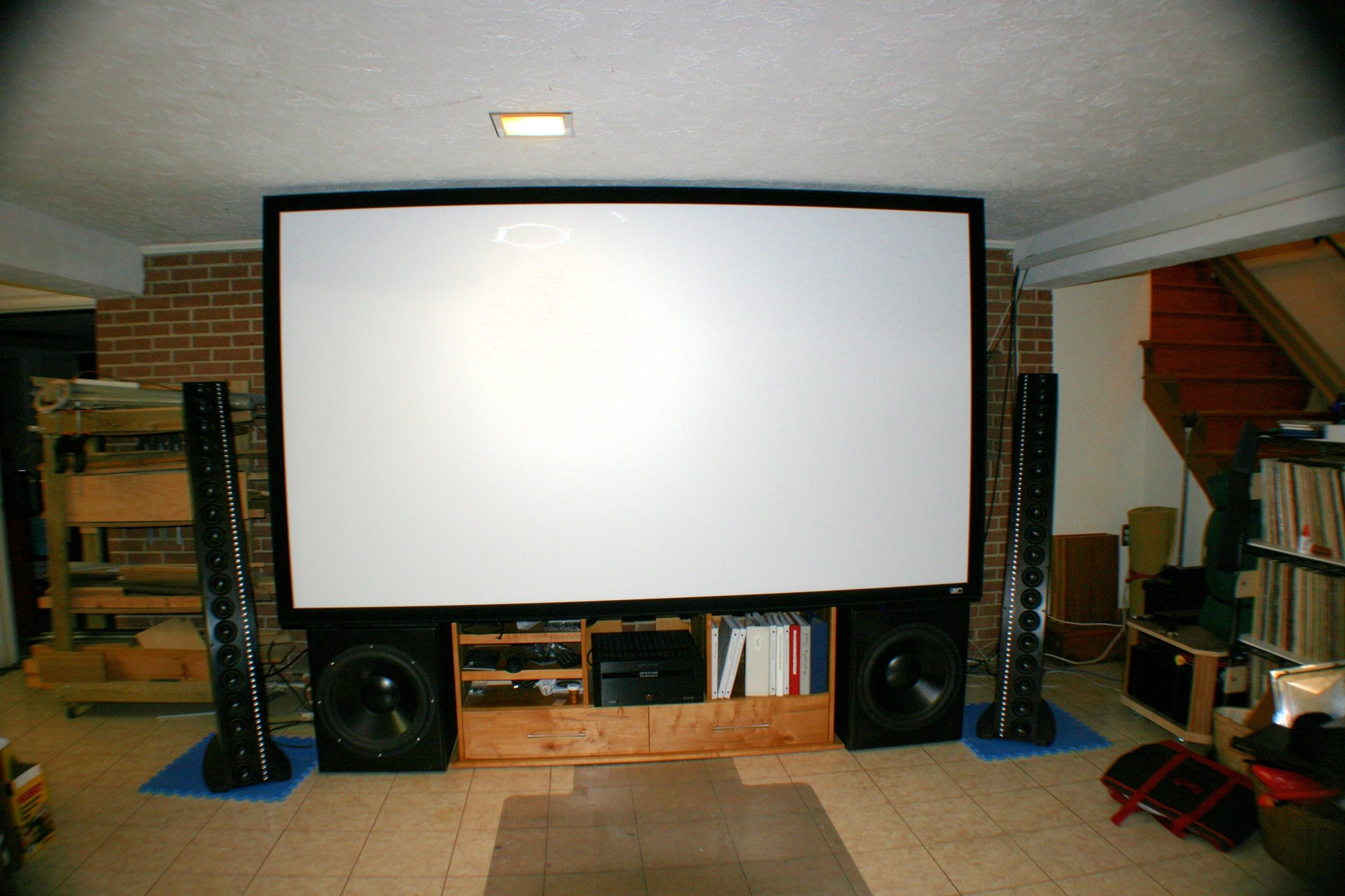

The are cases where you can drive the tweeter(s) directly. Consider the following system -
[attachment=0]
Each array has 18 midrange drivers an 72 tweeter drivers. Each of the four arrays is driven directly by an Emotiva XPA-4 (4 channel ampilfier). The system has been in use for several years with no problems. The Emotiva amps have a soft turn on and turn off. No problems even when the electrical line craps out.
Re: My cheap speaker project
September 23rd, 2022, 7:32 pm
Still a risky situation for a tweeter without a blocking cap. I quad amp my system with no passive devices in series, but I also have a custom speaker protection circuit in case there is DC or the total power is too high. It saved my bacon one time when a driver transistor in an amp failed resulting in the amp swinging the output up to the DC buss voltage.
