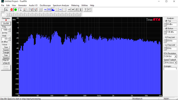

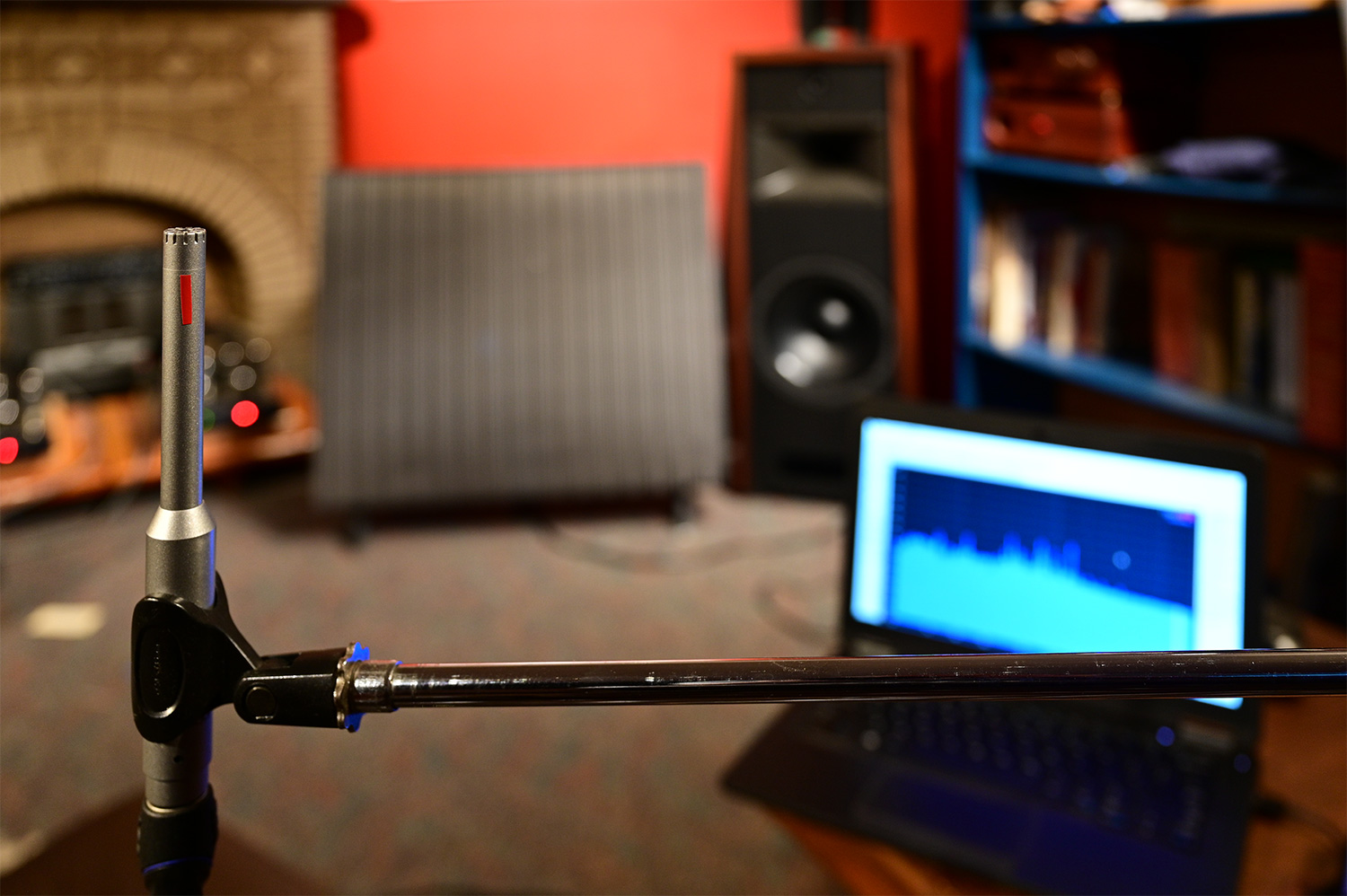

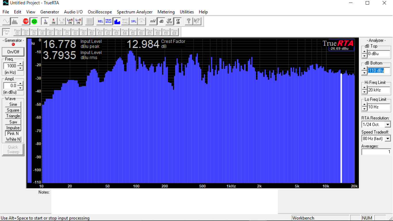

I use TrueRTA here are pink noise and sweeps of the RAZZ and Quad ESL. The RAZZ stock tweeter is not active. I added the ESS AMT Large which gives me a much smoother response.
Volti Razz full 20 to 20k pink noise
Quad ESL full 20 t0 20k pink noise

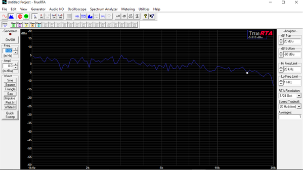

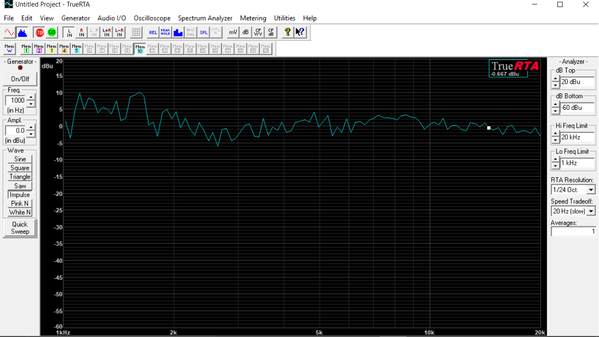

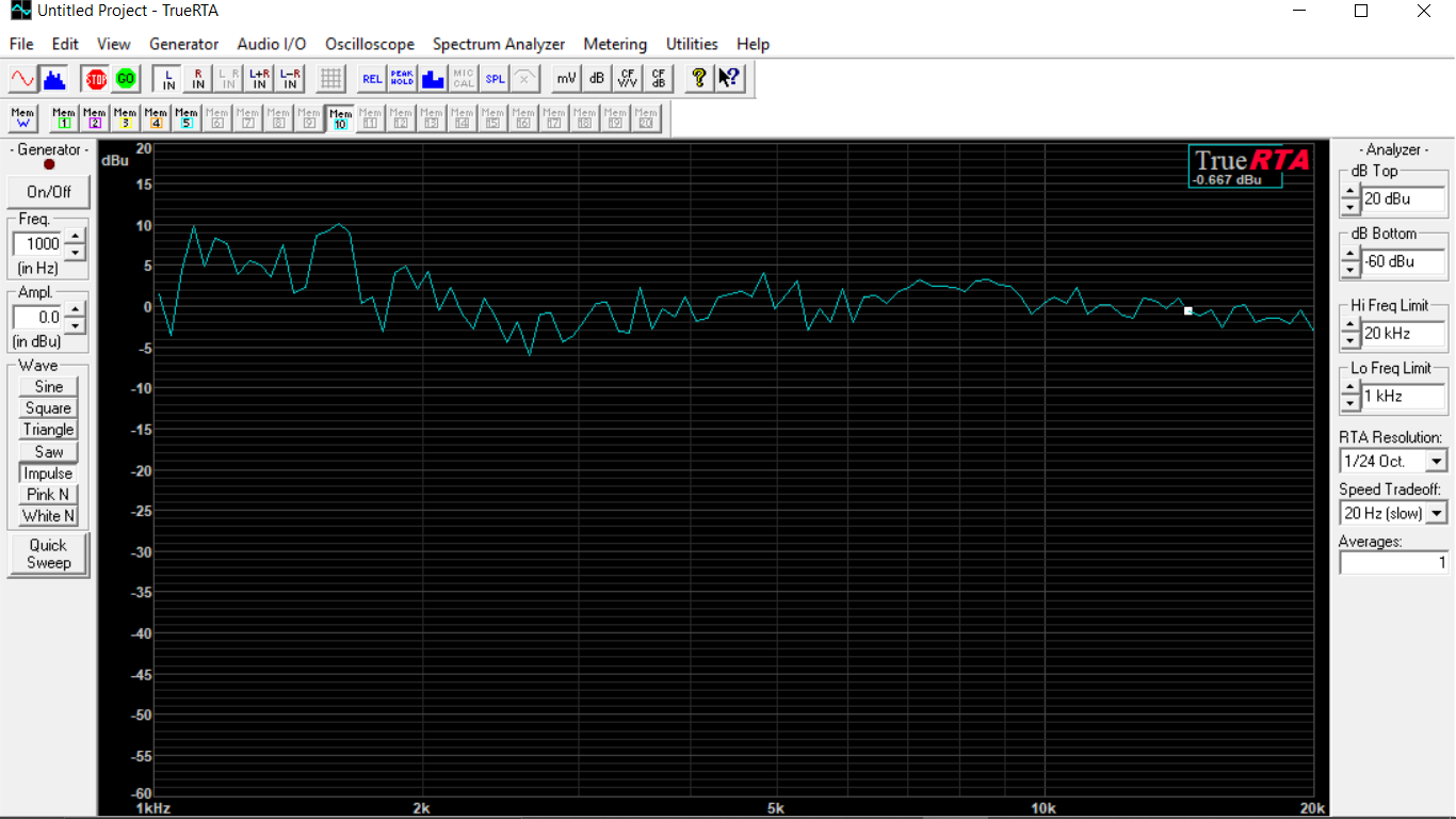

PostPosted: June 15th, 2022, 3:32 pm
TrueRTA sweep from 200hz to 20k
Razz
Quad
