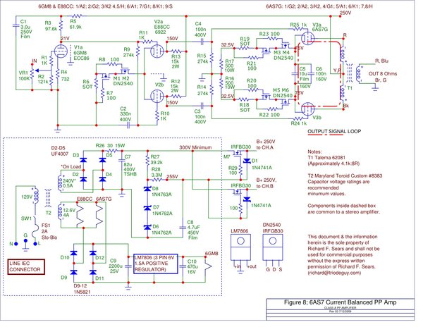

Here is another option if you are going Class A. Adjustable solid state current sinks in the tails of the output cathodes. This allows precise setting of bias current. Note that there are 500 ohm resistors in the tails of the CCS. Measurement of voltage there should be excellent. In addition, even if your meter is off by 50% (!), it wouldn't matter to DC balance, as long as they are the same. Dave Berning has found that even very small imbalances in output primary current cause a great increase in distortion. This ensures that source of distortion is not an issue.
You can switch out any power tube for another and the current will remain exactly the same. What will vary is plate voltage, but that is of little concern so long as the tube isn't defective.
You can, if you like, use a toroidal output transformer, since there is virtually no DC current imbalance to saturate the core.
The downsides:
1. Limited power of a Class A amplifier and the additional heat associated with Class A operation of any type of output device.
2. The capacitor joining the cathodes is critical. That's how the AC signal gets amplified. Otherwise the CCS in the tails would absorb the differences and nothing would be amplified. The best sorts of caps are indicated here. But, the needed caps are much smaller than cathode resistor shunt caps, allowing film types instead of electrolytics.
3. More parts than a simple resistor and shunt capacitor. Complexity.
Having said all that, the bottom line is the sound. We heard this amp, built by Richard Sears, at a club meet a few years back at David M.'s home. To me, it sounded amazing, powerful, liquid, full, pick your terms, it drew me into the room from the kitchen where we were listening to Tubedriver tell us about road racing. So you know it was something. I knew nothing about the design before hearing the amp, but wow!
