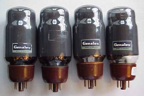

Don't waste your time or money. The Gold Lions are Russian "wanna-be" KT-66s. The Chinese tubes are actually quite nice despite the rumors. But then there is nothing on this earth equal to the Genelec KT-66s with the carbon coating inside the glass envelope. When I had an amplifier modeled after the Williamson design I tube-rolled beyond reason. Then I took the plunge -- genuine British made Genelec KT-66s. ZOWIE! They're rated for a minimum of 8,000 hours MTBF at about 50-ma cathode current but sound best biased for about 36-ma. Compared to EL-34s, KT-88s, Chinese and Russian KT-66s, and Bendix Red Bank 6384s it was not even a contest. The big surprise with the Genelecs was that they really came on song set up as triodes.
