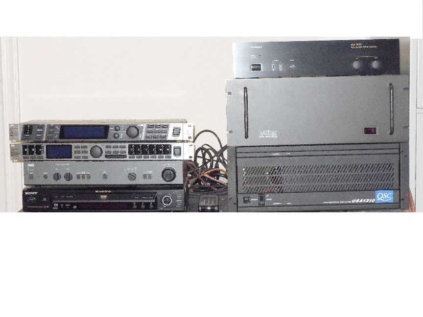

Electronics I'm using for test include a Sony DVP-NS500V SACD player, an NAD 1300 pre-amp (this is the discrete old version that is quite good), a Behringer DEQ2496 digital equalizer, a Behringer DCX2496 digital crossover, a modified QSC USA1300 amp for the lows, a modified Hafler DH500 amp for the mids and a Parasound HCA 800II for the top.
I have started voicing the system using the HSUs and after a lot of work the results are very promising. The sound stage is exceptionally deep, the transient response is excellent, and the detail is great while not being etched. The bass is good but limited in performance compared to the mids and highs. Crossover points are 200 Hz and 1 KHz. The 1KHZ is no problem for the AMT with the 48dB/octave crossover slope. I'll continue the voicing when the new woofers arrive. Photos are enclosed.

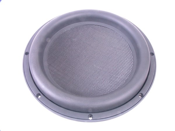

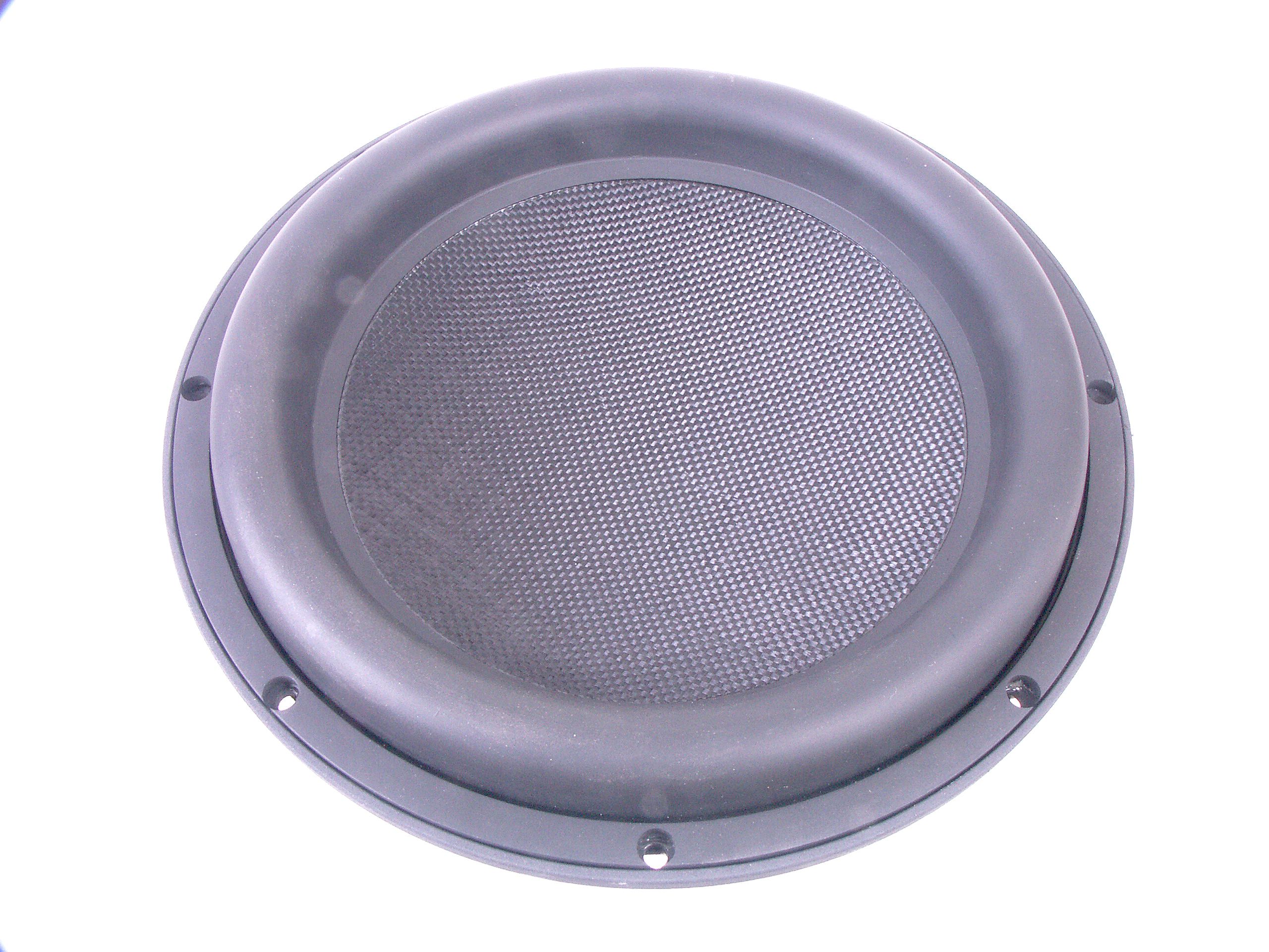

The woofers arrived today from Parts Express. Here are some photos of them and the HSU woorers they will replace.
File comment: UM12-22 cone with Nomex honeycomb and fiber glass

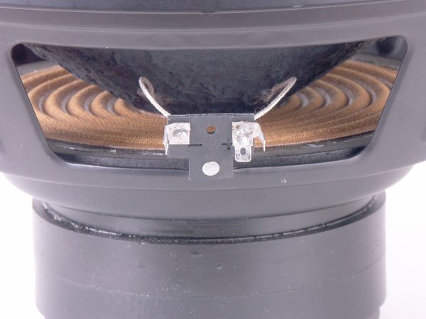

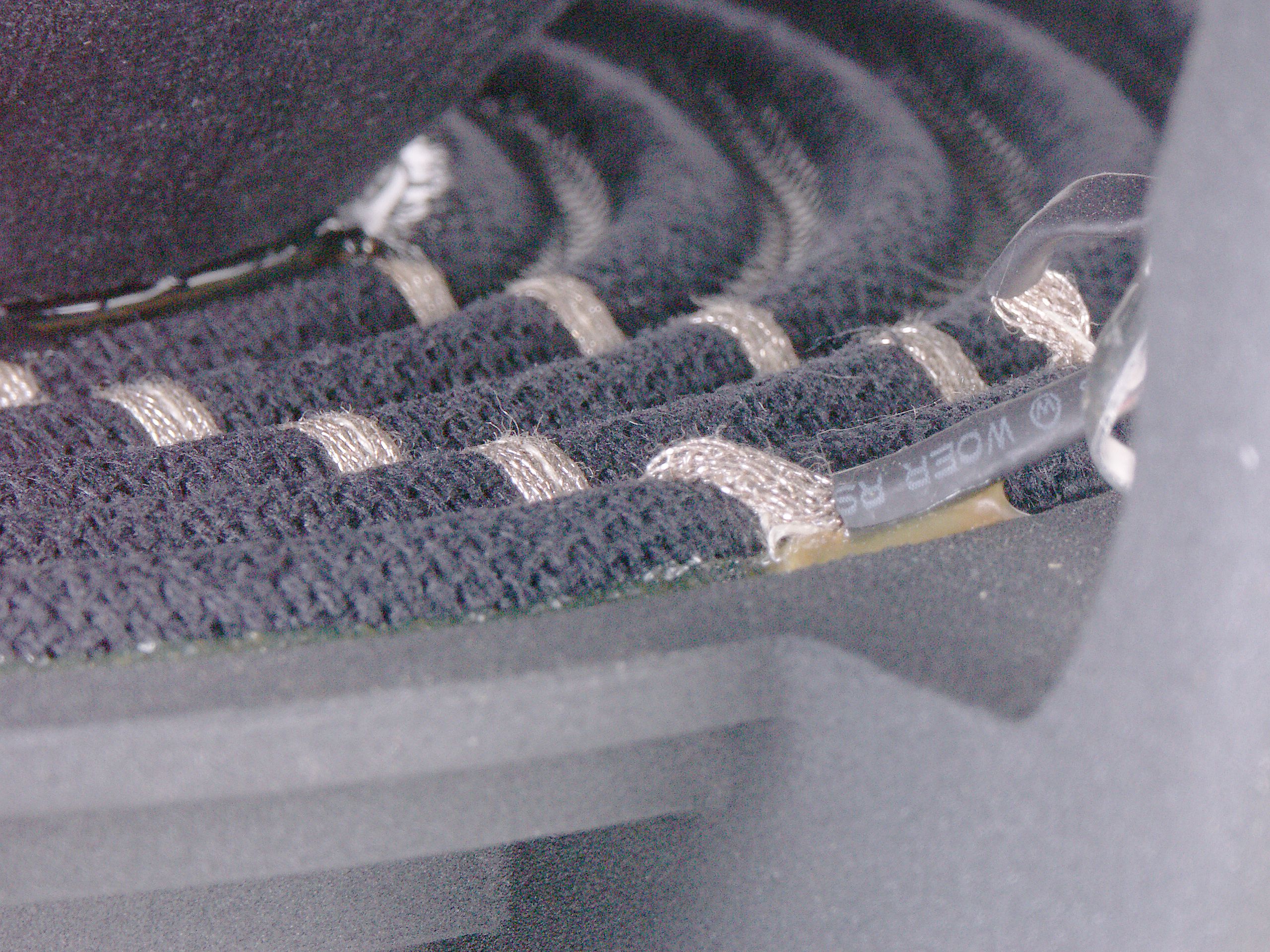

File comment: Tinsel leads as part of the spider to reduce chance of breakage at high excursions

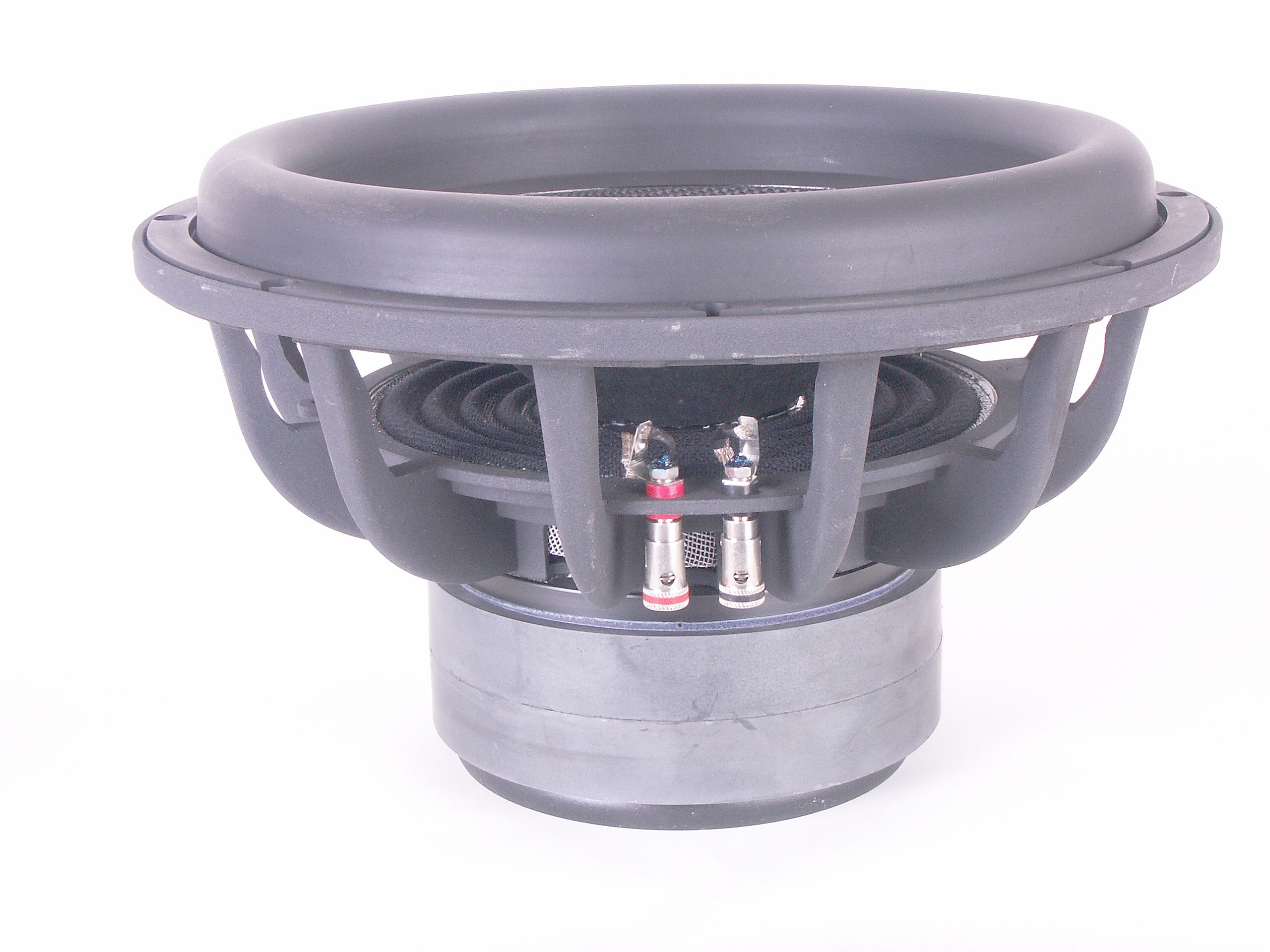

File comment: Side view showing heavy duty terminals. Note "Tall-boy" surround

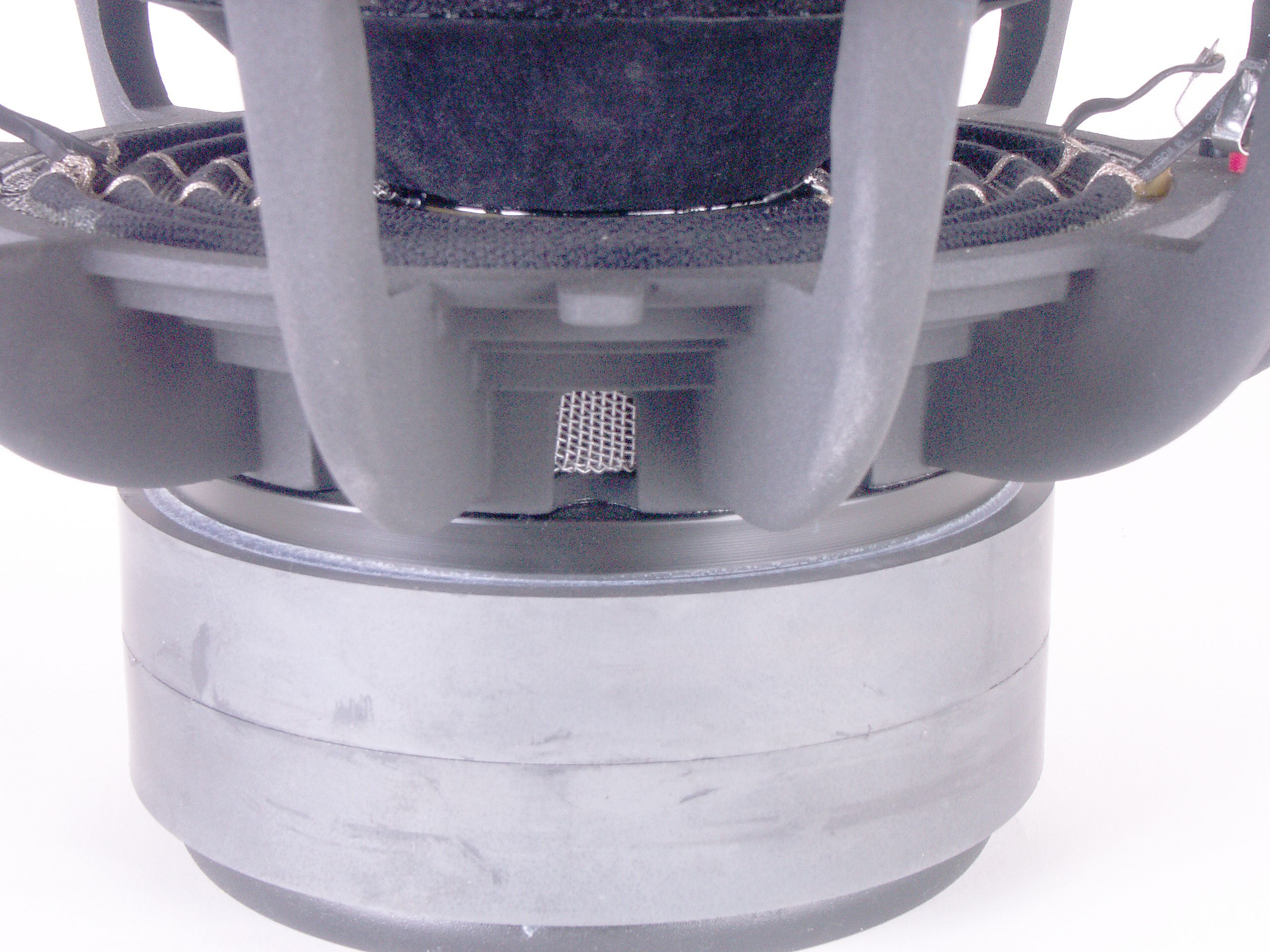

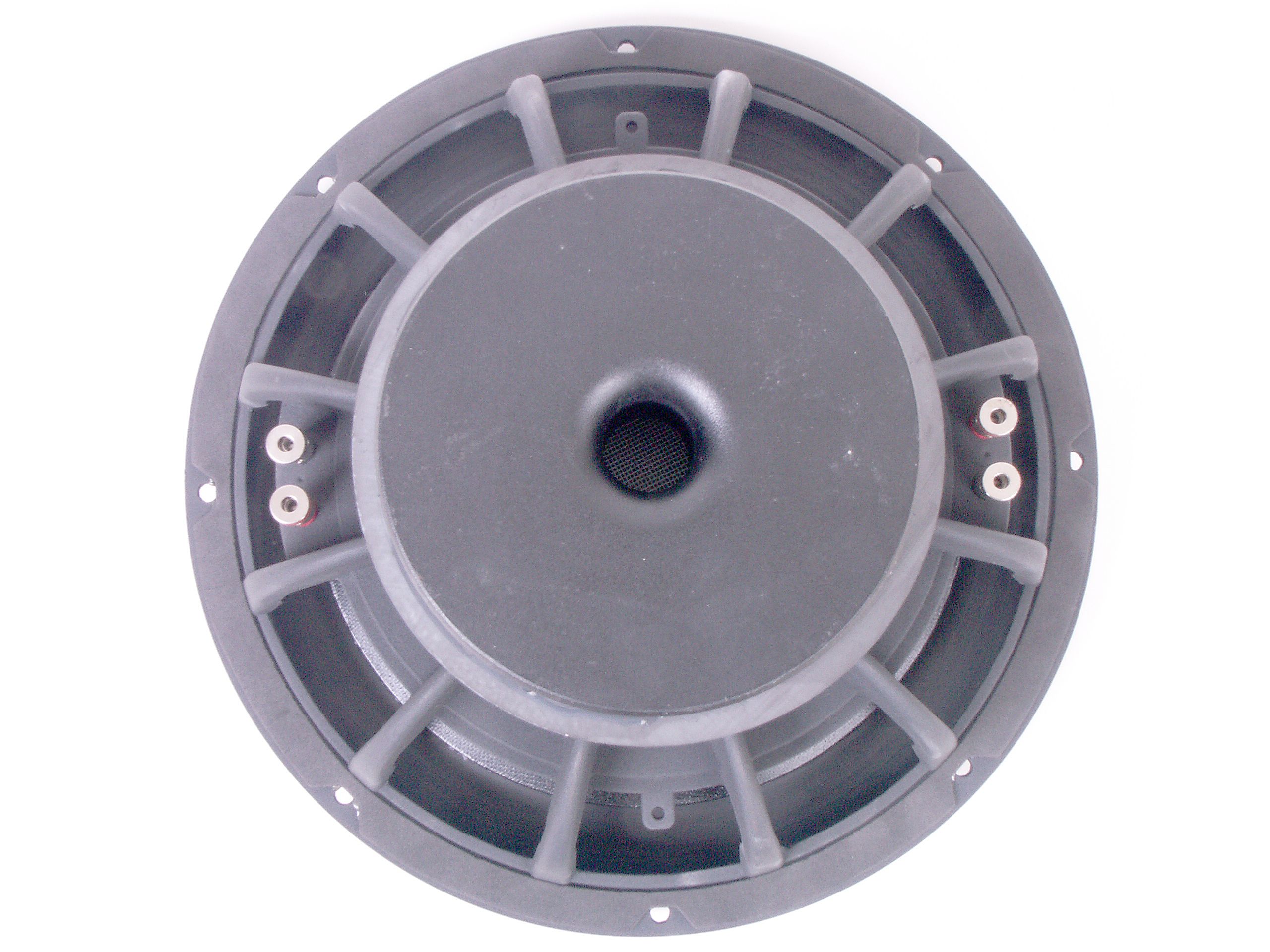

Woofer photos 2
File comment: Bottom view

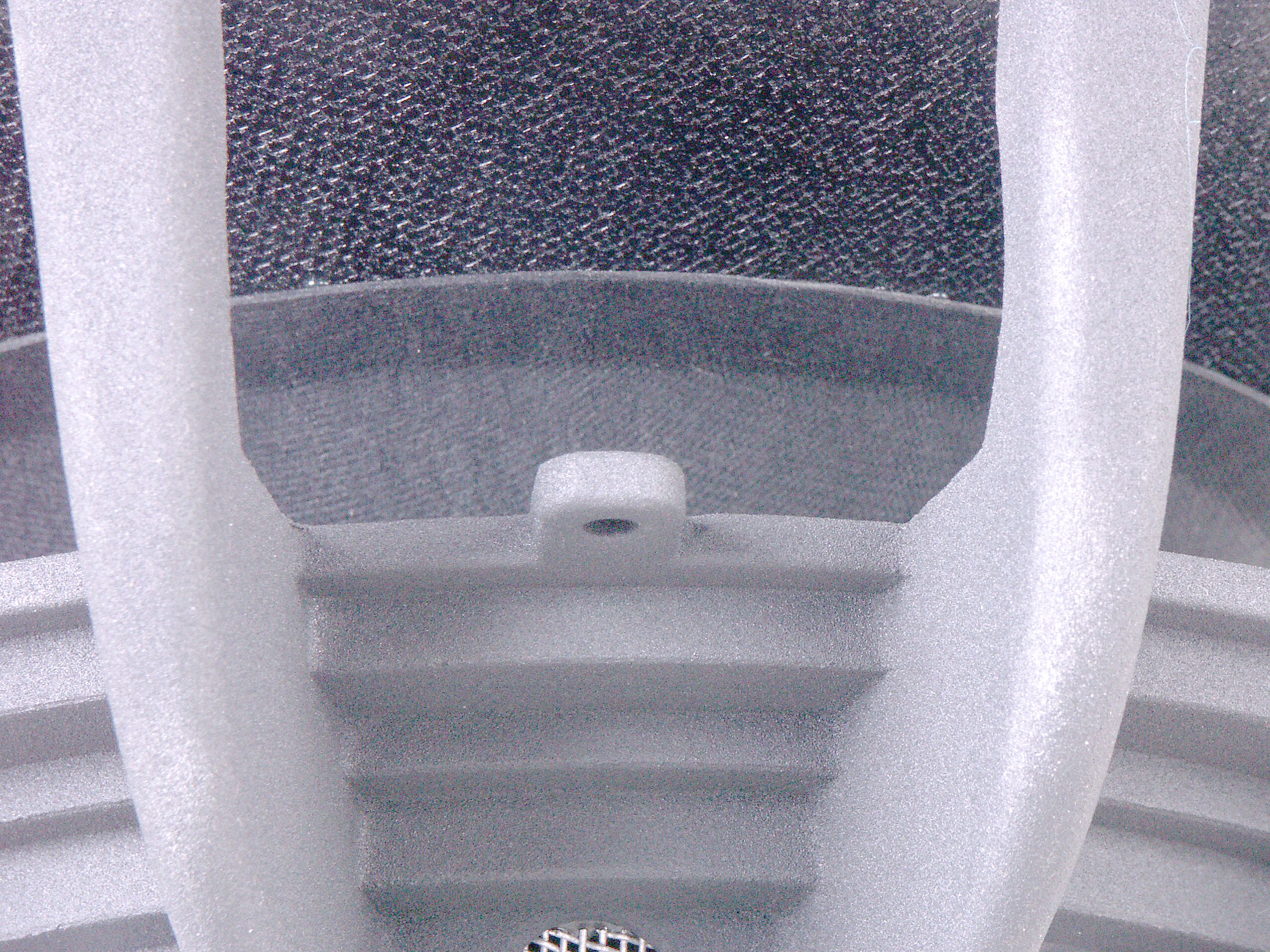

File comment: Top cone intermediate fastening to voice coil

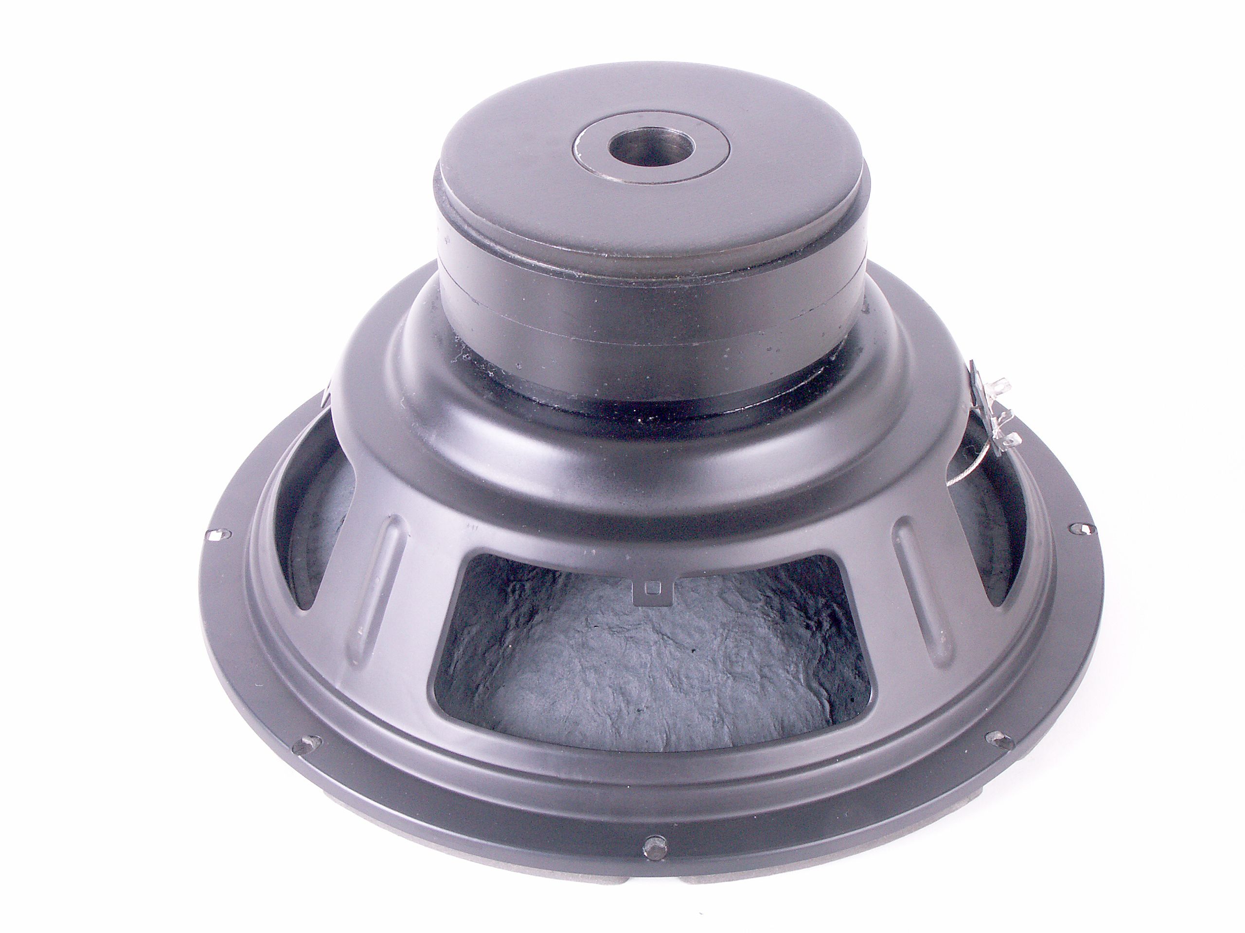

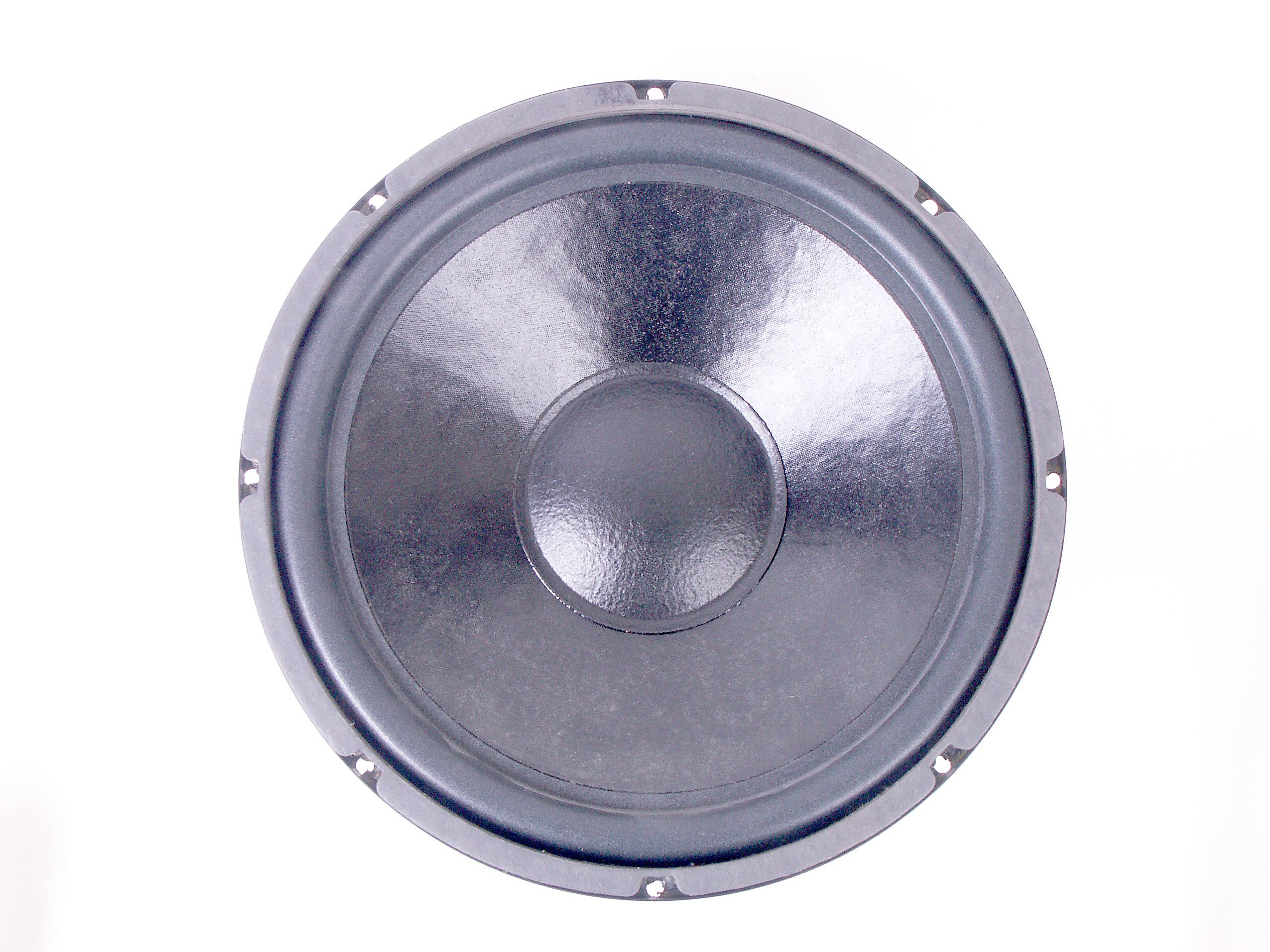

HSU photos
File comment: HSU top view

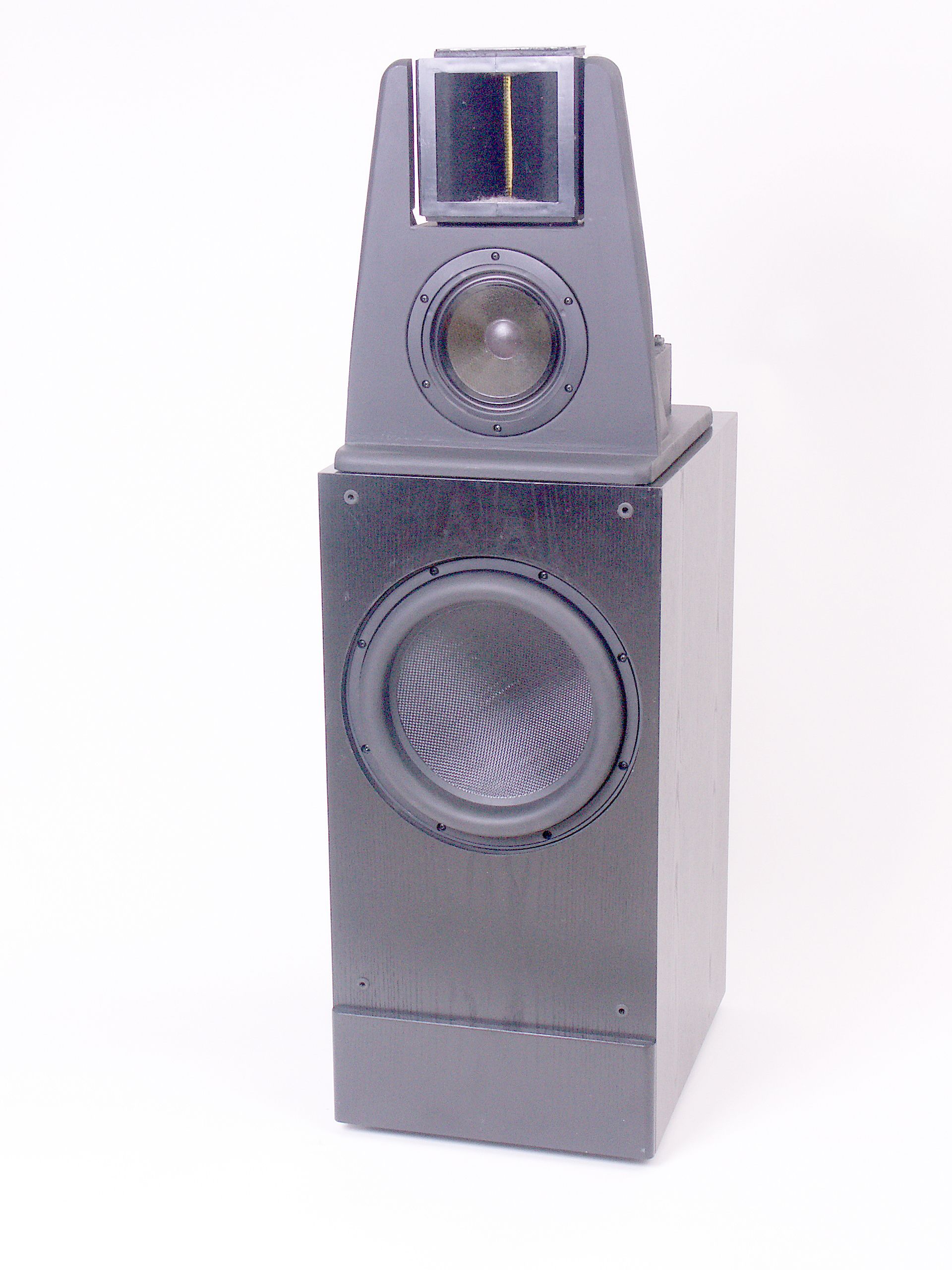

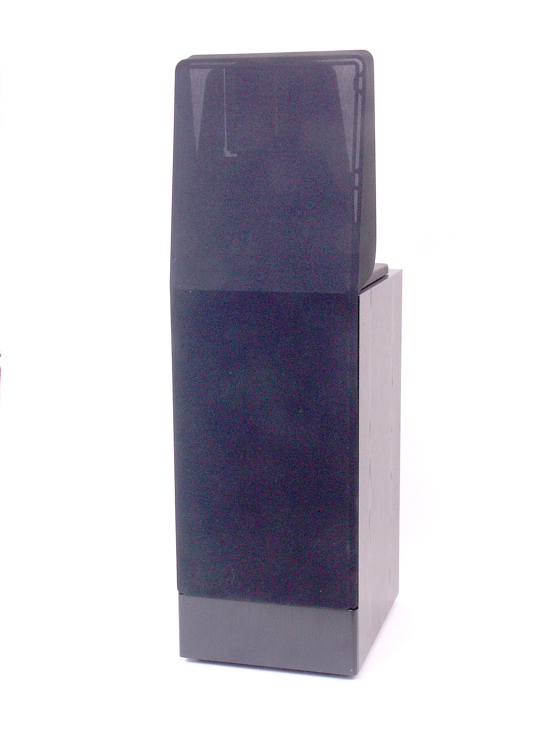

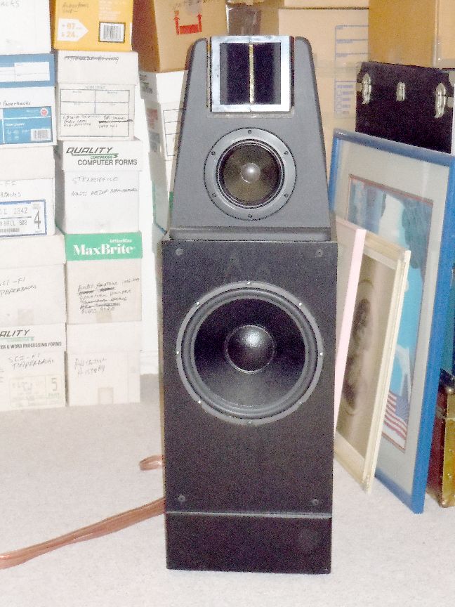

The voicing is going faster than expected. This should be finished in a short time. Here is what it looks like now.
File comment: Complete speaker showing drivers
File comment: Complete speaker with grille
