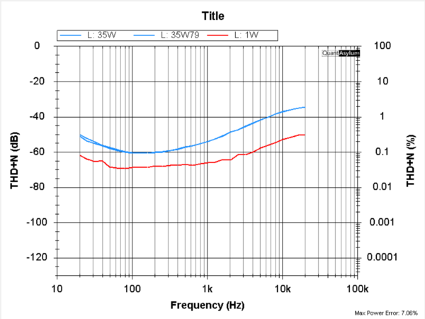

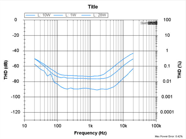

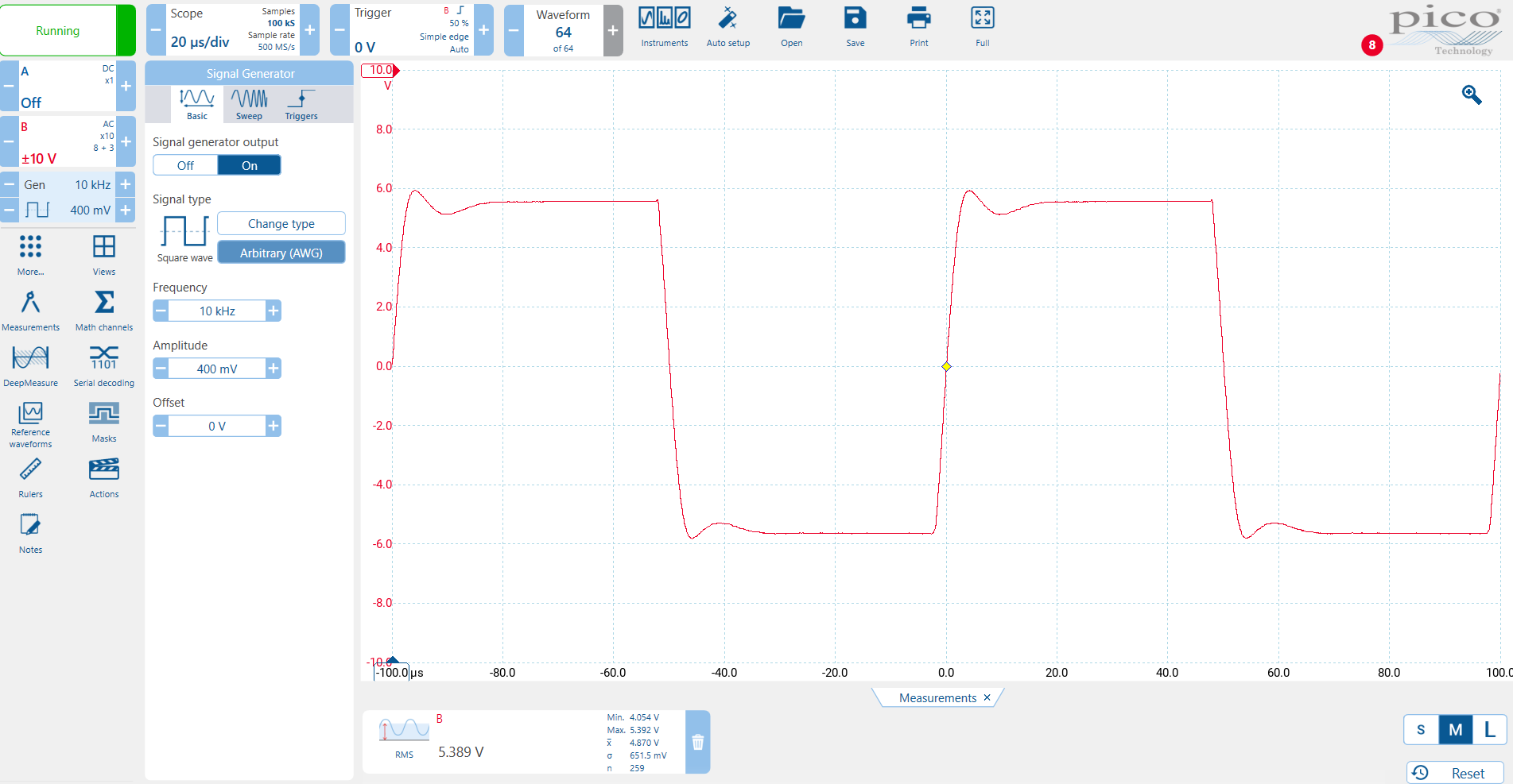

I dropped them into my higher-powered Williamsons, which, with KT88s and the S-265-Q's, produce about 28 wpc at 1% distortion. With 18dB feedback, I get 36 watts before clipping. I haven't put them on the QA403 yet to see what the distortion looks like, and I think I could probably back off the step filter I was using for the 265s, but they look good. Now to see how they sound!

Well, they sound wonderful. I get 35 watts at about 2% THD, but it feels like I picked up more than 7 or 8 watts. Very authoritative, great bass slam. Mingus jumps out of the speakers. Smooth midrange and top. Distortion is a bit higher than with the 10K S-265-Qs but the majestic presentation is a fair tradeoff, IMO. I'm very pleased with this upgrade, and for a bargain price of $500 the pair! I wonder how long they'll continue to price them that way if they get more orders.

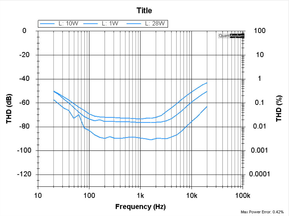

For comparison, here's the same amp with S-265-Qs, then the S-271-S's. You can see why the original Williamson with a 10K load is so pleasing--such low distortion. But the 271s still sound great.
