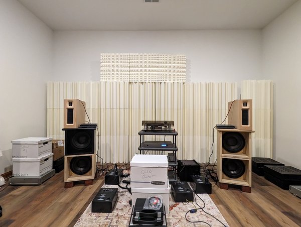

Have the updated baffles wired and first measurements done to update the DSP crossover for the LM10n.
The Parasound Z-AMP v3 needs RCA inputs and the dspNexus has XLR, so making some adapter cables. More measurements to integrate the 2x12 OB servo subs once I have all the cables built and installed.
The Monolith II's are updated versions of the speakers I brought to CAF2018.

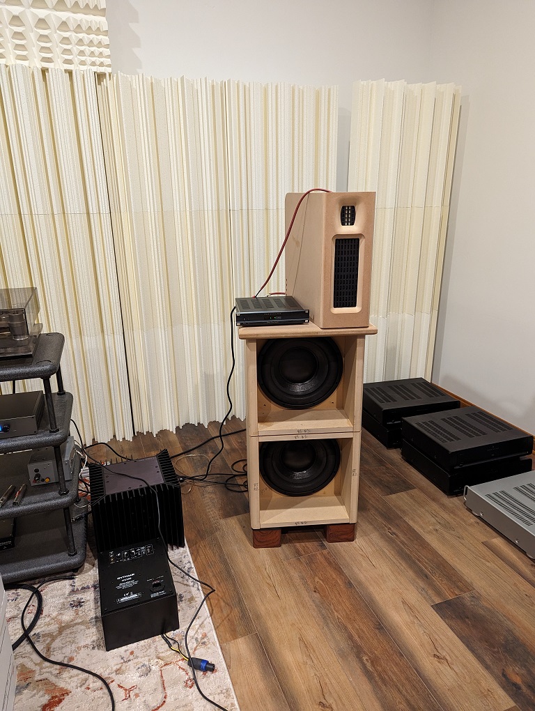

The system is playing music.
The GR NEO3 tweeter, Radian Audio LM10n midrange planars and GR-Research and Rythmik Audio 2x12 OB servo subs.
DSP crossover is the dspNexus 2x8 driving two Parasound Z-AMP v3's.
Some final measurements to adjust driver levels and it will be time for some music listening.

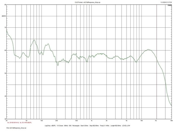

Did some DSP crossover rework of the Monoliths II with the LM10n planar midrange with the CLIO Pocket system measurements and this is the on-axis farfield response in the room.
Still have room modes to work on below 200Hz and possibly some tweeter response flattening that can be done.
