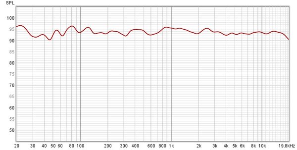

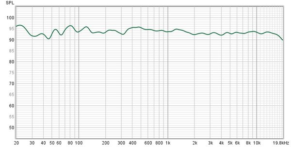

Another way to do it is to have the DACs in the same chassis as the DSP processing. I am now using the Danville Signal dspNexus 2/8 that Rich has been talking about. Everything is in one chassis so there are no concerns with interconnecting cables between the processing and the eight AKM DACs. Rich set up the original parameters based on what was in my DEQX processor but I spent about two weeks tweaking it including making new measurements of time alignment of the drivers at the listening position. The sound now is great. Since I am an early adopter and have been providing a lot of feedback, there is a new processor board that has 4 times the processing power coming out. I will be getting one as part of the EA program. I'm including some in room measurements at the listening position as well as info on the unit. The new processor will allow even more control of the low end. Remember, these measurements are not quasi anechoic but include what actually arrives at the listening position including room effects. Measurements were done with Room EQ Wizard with my ACO Pacific 7012 measurement mic.
