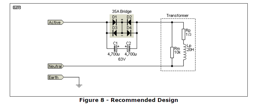

I have an iso-tranny on my low-level equipment that buzzes periodically. I added this circuit a while back and have never had the problem since

Thanks, David. That narrows it down. If the iPhone recording he sent me is any indication, it's definitely a "buzz". The house is full of ceiling fans, dimmers, etc. I'm thinking there's some DC on the line or some other type of interference. He says he never heard it with his previous amp but the transformers were enclosed in heavy aluminum cases so it's hard to tell if it was a problem. I think I might have him try a DC blocker or some other type of line filter. We could also slip a steel case over the tranny, that might help.
